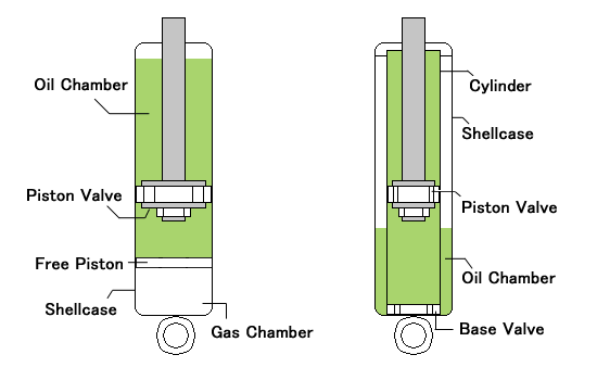

Let’s look at the basic design of each version. . .
https://www.tein.co.jp/e/special/ni_.../img_tigai.gif
On the left is the gas charged monotube. . .on the right is the twin tube. I should take a moment and explain most decent twin tubes are also gas charged. Some have a small plastic bag filled with nitrogen that is inserted around the inner tube, some have an actual gas chamber.
Monotube: As you can see there is only one tube. Said tube contains two media, oil and nitrogen gas. These are separated by a dividing piston which can “float” up and down the tube.
As the oil in the monotube is typically held under high pressure (75-300psi) you should think of the oil as a solid column. As the shock moves the oil is not pushed through the piston, the piston is pushed through the oil. The oil, for the most part, stays in the same place.
As the shaft is compressed into the body the volume the shaft displaces must be offset, otherwise the shock would blow up. So to accomplish this the dividing piston floats down the tube, further compressing the gas below it.
Twintube: As you can see there are two tubes, and inner tube in which the piston rides, and an outer tube which is used as a chamber to store excess oil.
As the shaft is compressed in a twintube the shaft volume must also be displaced. The oil is forced through the base valve and into the outer chamber. In the twintube the oil physically turned 180 degrees and passed through a valve. This creates more heat.
Now let’s look at the actual pistons being used. The piston and shim stack of the damper is what is creating the actual shock force, regardless of shock design (though both versions have other valves/ports/orifices that influence the overall shock force).
Here’s an image I pilfered from the Bilstein site that illustrates the size difference between the two pistons:
http://www.truckspring.com/Images/Sh...ein-piston.jpg
As you can see the monotube piston is MUCH larger, and therefore theoretically more efficient.
