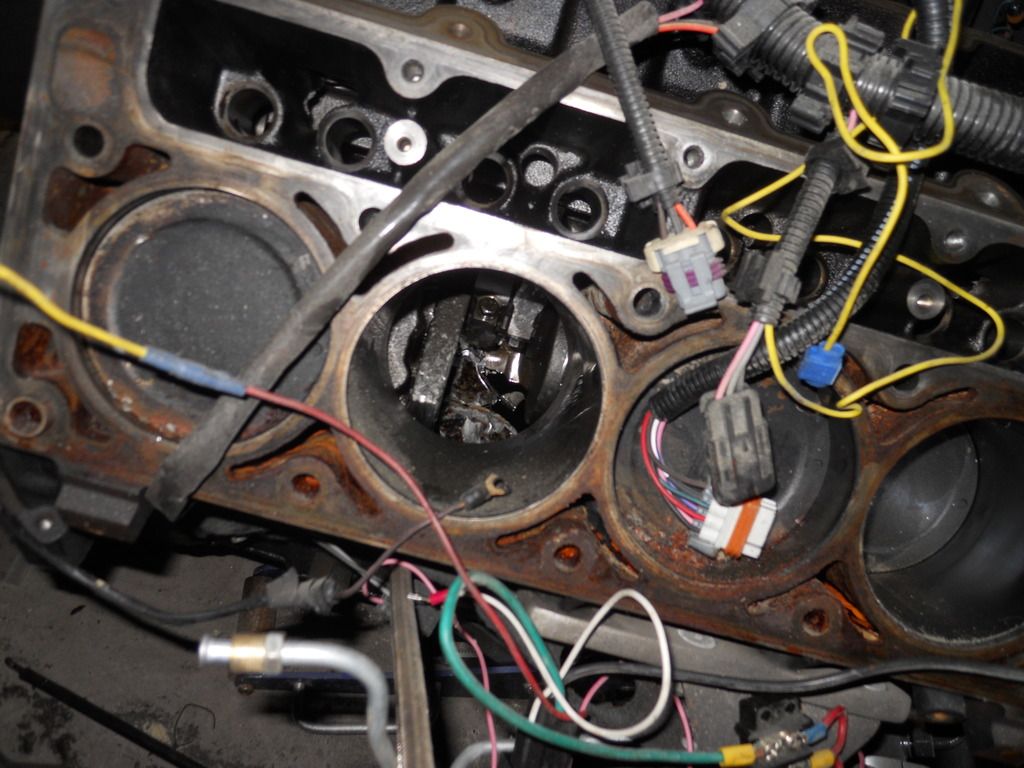

the reason for the rebuild
http://i1042.photobucket.com/albums/...pscgshnfpe.jpg
the rest of the piston
http://i1042.photobucket.com/albums/...psd7savlkb.jpg

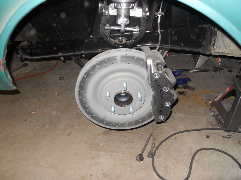

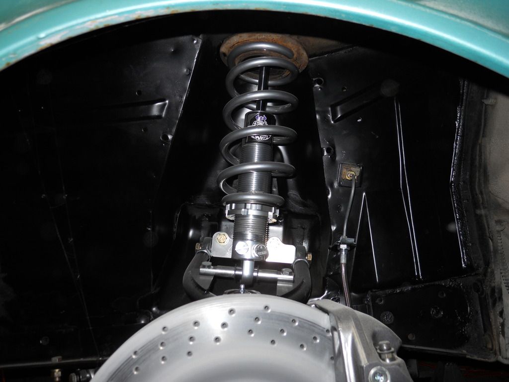

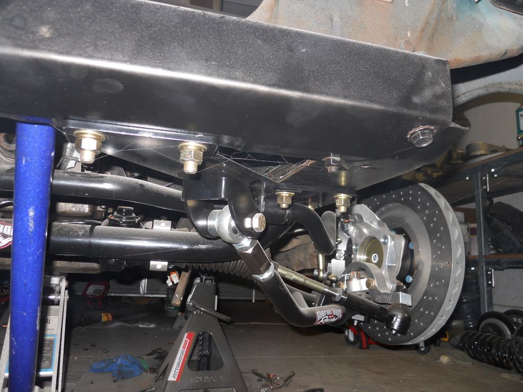

im running Church Boys Racing suspension front and rear. the front uses viking double adjustable coilovers and Ats spindles with corvette unit bearings allowing me to run Z06 14" brakes

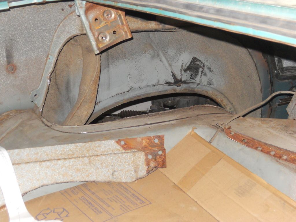

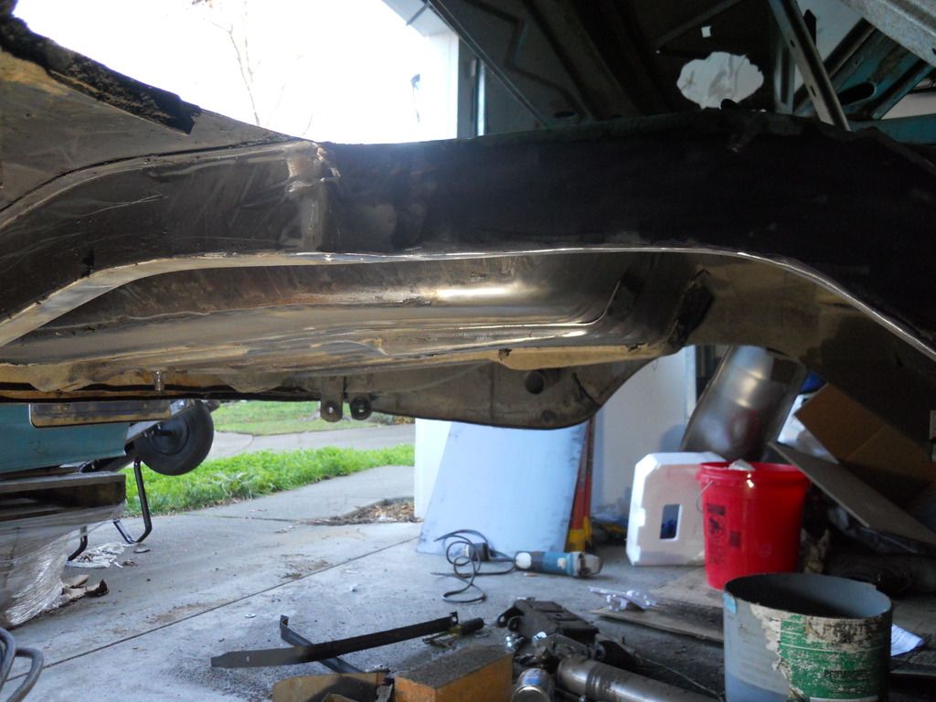

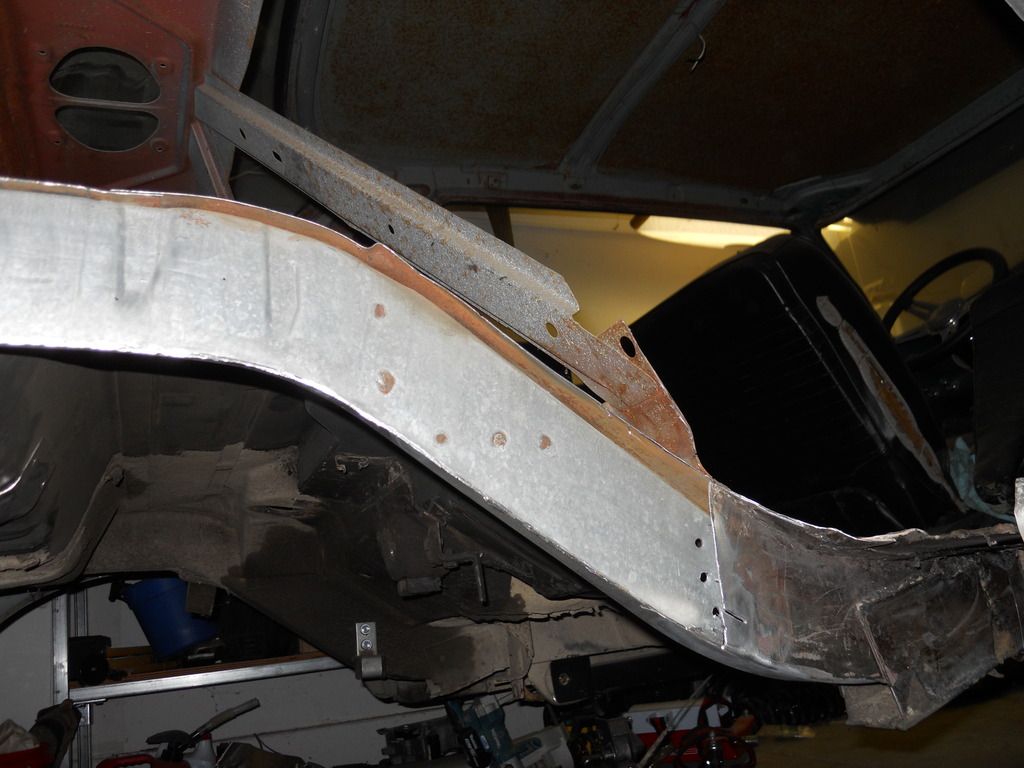

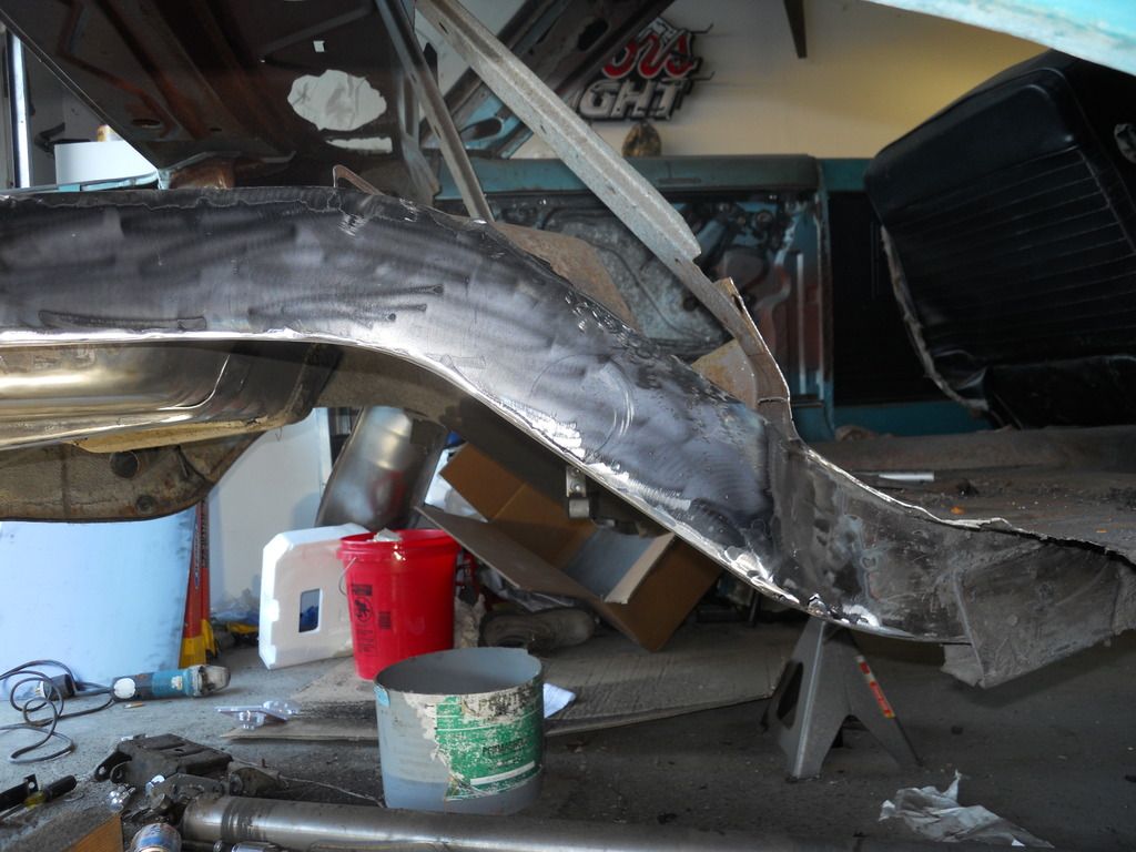

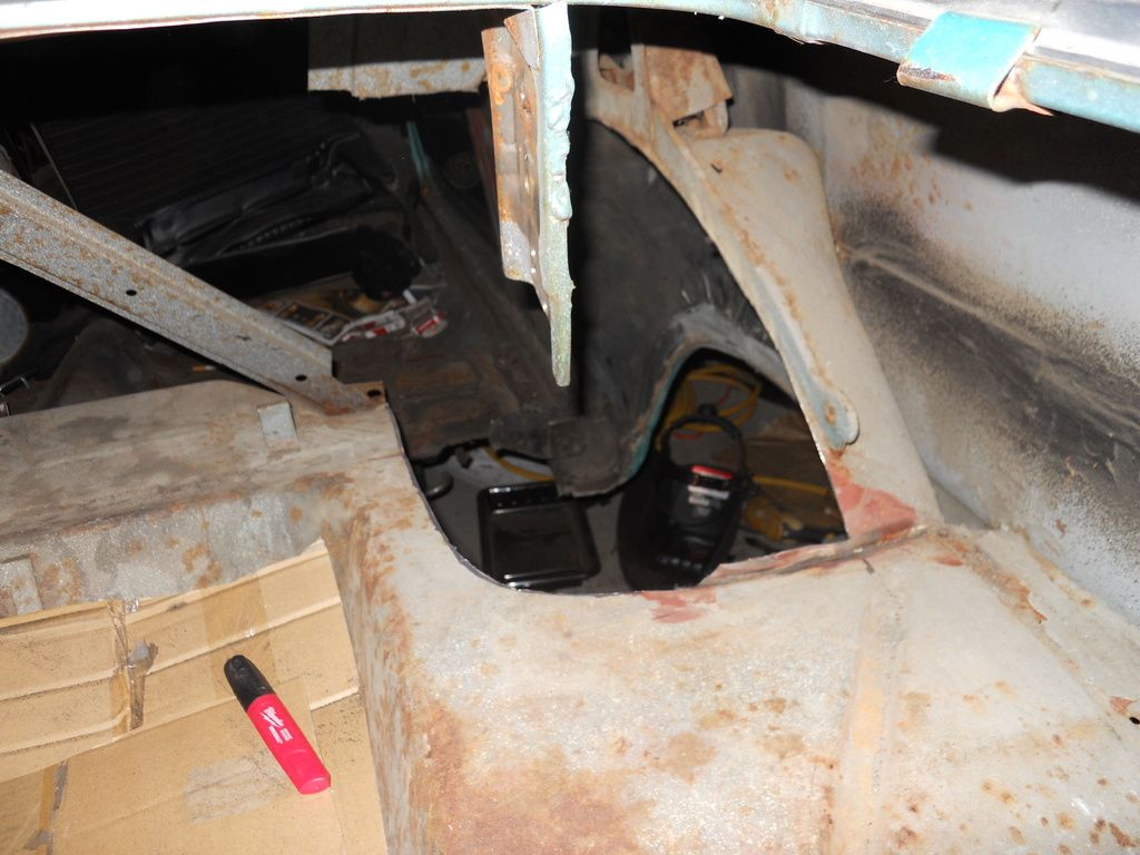

im currently working on the minitub which is taking me longer than i would like but its getting done. the passenger side is almost done
http://i1042.photobucket.com/albums/...psn7klnzto.jpg
http://i1042.photobucket.com/albums/...psp7jfdntz.jpg
http://i1042.photobucket.com/albums/...pszwotqvan.jpg
http://i1042.photobucket.com/albums/...psephe42dk.jpg
http://i1042.photobucket.com/albums/...psxq04y0dp.jpg
no go nova 01-23-2017 07:41 PM
Looking good any more pics on the min tub?
kbclamper 01-23-2017 08:39 PM
ill try to get some more pics tomorrow. ive got the passenger side tacked in, hoping to get it welded out completely tomorrow
