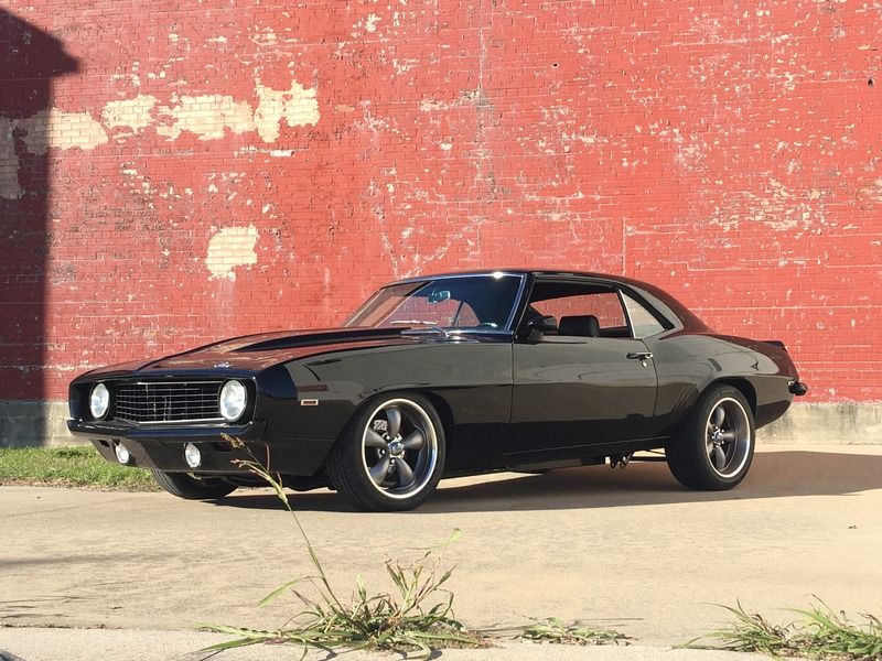

Crash427 01-23-2017 07:30 PM
1 Attachment(s)
Here's my starting point and a pic next to the Viper

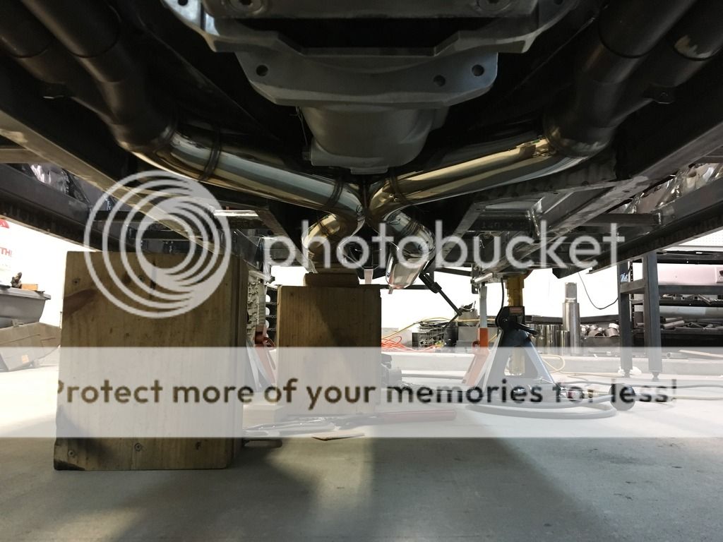

BMR Sales 01-24-2017 08:08 AM
Based on what you are cross-shopping, please consider our Torque Arm Kit. We incorporate a Watts-Link vs a Panhard Rod.
This is in my '73
http://i24.photobucket.com/albums/c4...psr3he3hpy.jpg
http://i24.photobucket.com/albums/c4...ps6qm10j8c.jpg
