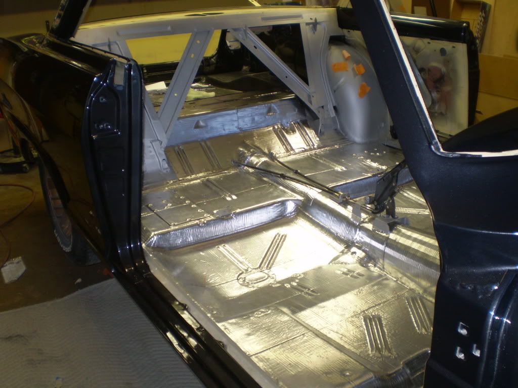

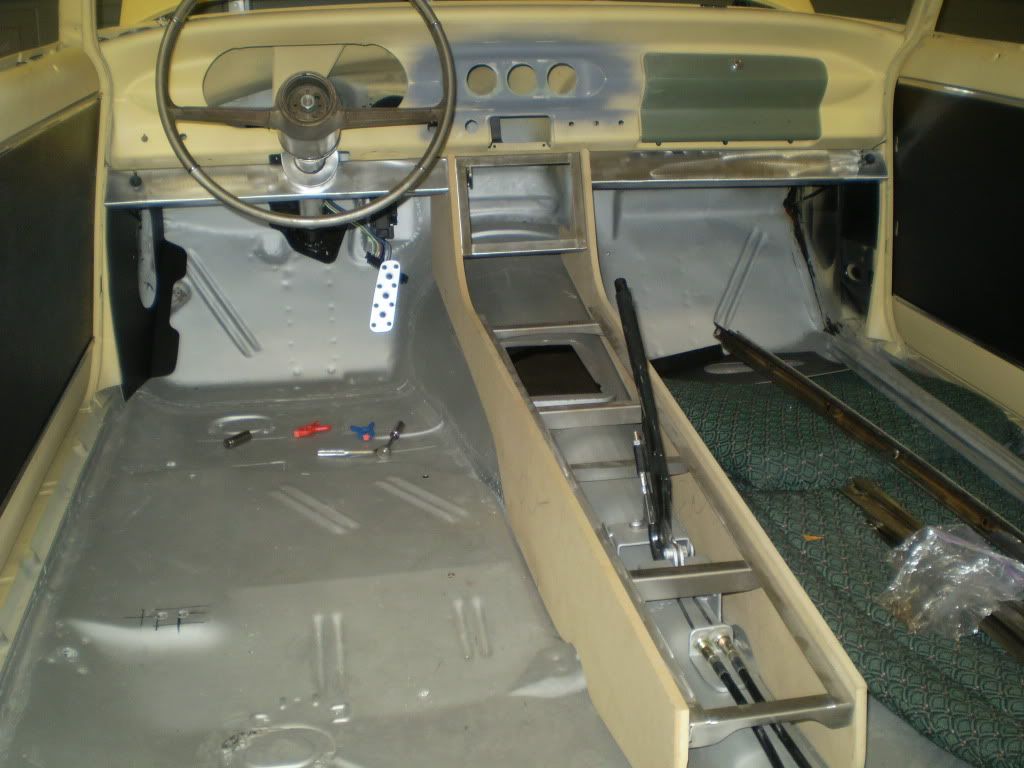

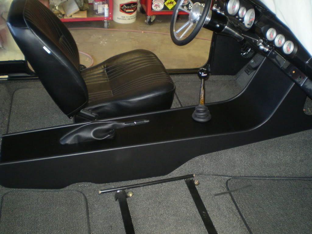

I made one for my 63 Nova. The lever is from an older BMW and the cables are from helmar, very good selection and low prices. I bought long cables because I wasn't sure of the length, ended up cutting them and crimped a new stop on at the brake end. Just 2 piston Willwoods, works real good. The console goes all the way to the back seat. Don't really have any pics from underneath?
Rick
http://www.helmarparts.com/Emergency...ables_s/64.htm
http://i242.photobucket.com/albums/f...7/P3150035.jpg
http://i242.photobucket.com/albums/f...E/PB270164.jpg
http://i242.photobucket.com/albums/f...E/P9160002.jpg

I was thinking of doing mine very similar and running it under my full length console, after seeing your I will for sure be doing it very similar. I like the ability to hide the cables and once its setup and working correctly there wont be a need to adjust it.
Thank you very much for the pics
