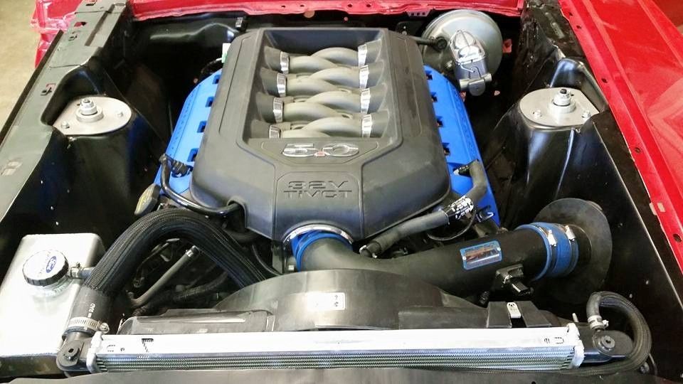

You can take a look at my build. 67 Cougar (luxury version of the mustang) that I am using the crate motor version of the 2015 Coyote. I use a modified reproduction of the Boss 429 brake booster wedge to tilt the hydroboost above the valve cover. I have a 2002 MR2 power steering pump that I plan to use to power both the power steering and hydroboost because of some space limitations.

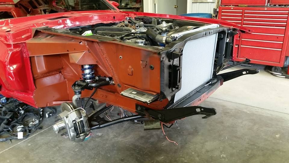

Of course there are other ways to to install the coyote while keeping the shock towers (albeit only a portion of them) and even still use stock style suspension.
Here is a picture of somebody use Boss 429 towers and ridetech suspension.
http://i1096.photobucket.com/albums/...32159176_n.jpg
http://i1096.photobucket.com/albums/...33387645_n.jpg

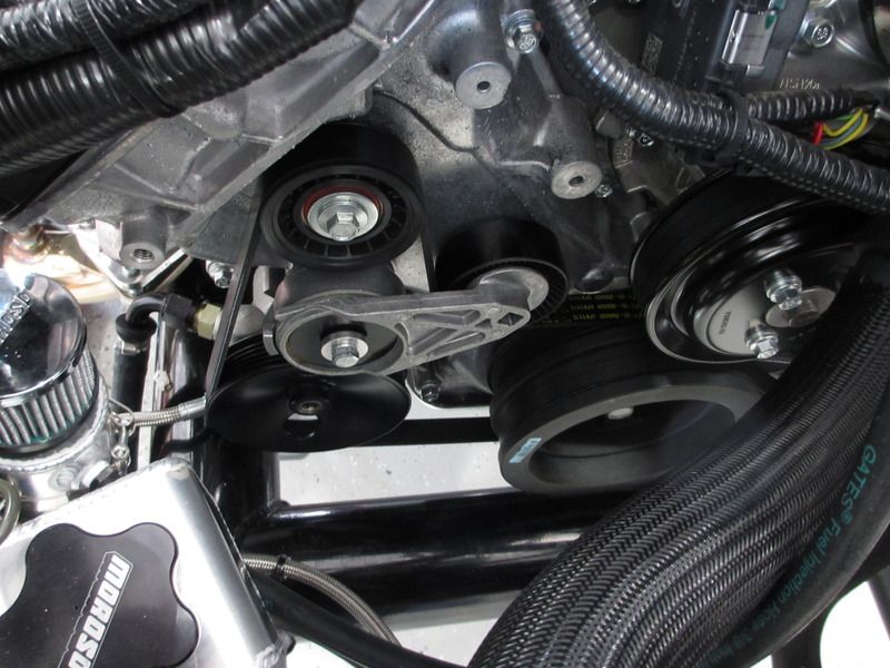

Two kits on the market that I'm aware of. Forte's parts connection out of Framingham, MA and a KRC kit. Both work well. If you go with Forte's you need belt 060439 as the standard one he ships with squeals at full lock because it's too loose. Lots of good info on the PCM, wiring, and other items you need to know on the factory five forum as they are a common motor, including the P0117 codes that were common with the first few months of PCM shipments due to a mistake Ford made in dieting the wiring harness.
I went with Forte's on mine:
http://i111.photobucket.com/albums/n...IMG_0005_1.jpg
