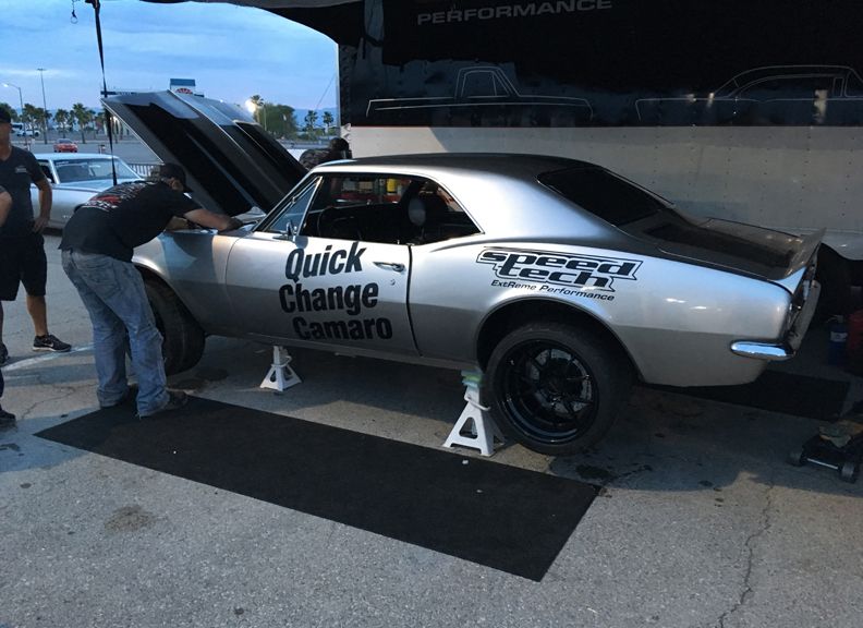

Ever wonder how long it takes to install Speedtech's Road Assault front and Torque Arm rear suspension? We say about half a day, and depending on how early we can get in a couple "before" autoX runs on the stock suspension, we're hoping to be ready to hit the track before the autocross shuts down for the day. Possible? Stop by the Speedtech Corral at LS Fest West and find out live! If you can't make it to the event, we will be posting live on our facebook page!
http://i1299.photobucket.com/albums/...psqp1cnou4.jpg
So here's what's going on. We've lined up this clean street cruiser 67 Camaro from Instagram's @Camaro.Family that's sorely needing a serious suspension upgrade. It currently has a mostly stock front suspension and leaf springs with Caltrac bars out back and they want to convert to a full Pro Touring set up. Nothing on the car is ideal for that type of handling so it all comes out!

We had a blast putting this car together at the booth like this, a challenge we'd never tackled before. We really wanted to show everyone just how easy it is to upgrade from a stock, clunky, poor handling and driving factory suspension to something that literally could be competitive and fun on a race course. As mentioned we teamed up with Scott Timmons from Instagram famous Camaro Family, Viking Shocks, Baer Brakes, Dutchman Axles and Forgeline Wheels, to see just how long it would take two guys working outside under a canopy, using only hand tools and a 110 volt home garage style welder, to install Speedtech's complete Road Assault front and Torque Arm rear suspension. The answer was right about 8 hours! How's that for a quick change?
http://i1299.photobucket.com/albums/...psqeplstvq.jpg

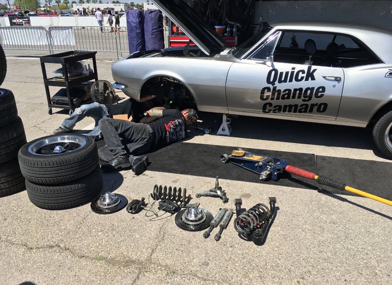

Scott started out early in Cali and met us at the event Thursday evening. Never seeing the car in person before the event, Friday morning Speedtech's sales leader and track driver Jay started with a few good autocross "before" runs leaving the suspension just as the car came to us. An aggressive well seasoned race driver, Jay's best time was 39.5 seconds, and when compared to the other cars at the event was very respectable considering how the car was set up. Right after a quick cool down period Jeremy, Speedtech's Rod Shop lead tech and Ryan, Speedtech's lead welder started tearing out the old stock style suspension a little past 11 AM. Working with typical hand tools found in any home garage builder's tool chest the reassembly work continued throughout the day.

Once the old was out, replacing the front suspension with Speedtech's tubular control arms and sway bar was fairly easy and straight forward. While in there we replaced all steering linkage and added a set of Baer 6 piston 14" brakes and BFG Rival S 245mm tires on Forgeline wheels. Out back the work was a little more involved, including about 30 minutes of fitting and welding in the rear crossmember that strengthens the rear frame rails and provides the Panhard Bar and Coilover Shock mounts. From there the Speedtech exclusive Articulink lower trailing arms were fitted into the leaf spring pockets. Next up was assembling the Torque Arm center link onto the Dutchman built 9" Ford axle and the complete assembly was bolted into the car. Finally the panhard bar and rear Viking Coilovers were bolted in and the outer ends finished off with matching Baer rear brakes. The car's existing dual exhaust required some slight modification to clear the center link and Ryan knocked that out with his 110 Volt Hobart welder plugged into the semi's generator. Just as the event was shutting down at 7:30 pm the rear 315mm BFG tires on Forgeline wheels were bolted on and everything was given a double visual check over. In just about 8 hours two guys with hand tools and a basic welder in a home garage type setting completely transformed the entire car.
