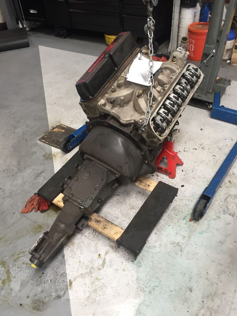

Old Motor coming out: I'll be reusing the distributor and pan.
http://i1307.photobucket.com/albums/...ps7k6yb3j2.jpg

Some motor pulling fun!
http://i1307.photobucket.com/albums/...psywxe97fp.jpg
http://i1307.photobucket.com/albums/...psbffxvx8o.jpg
http://i1307.photobucket.com/albums/...pse178mbzu.jpg
I got the motor with the car and didn't know much about it other than it being a 351...i think it had a flat cam from the start as it should have been a "healthier" motor so to speak.
This motor has the right components to be a good motor so it will also take a trip to the machine shop.
