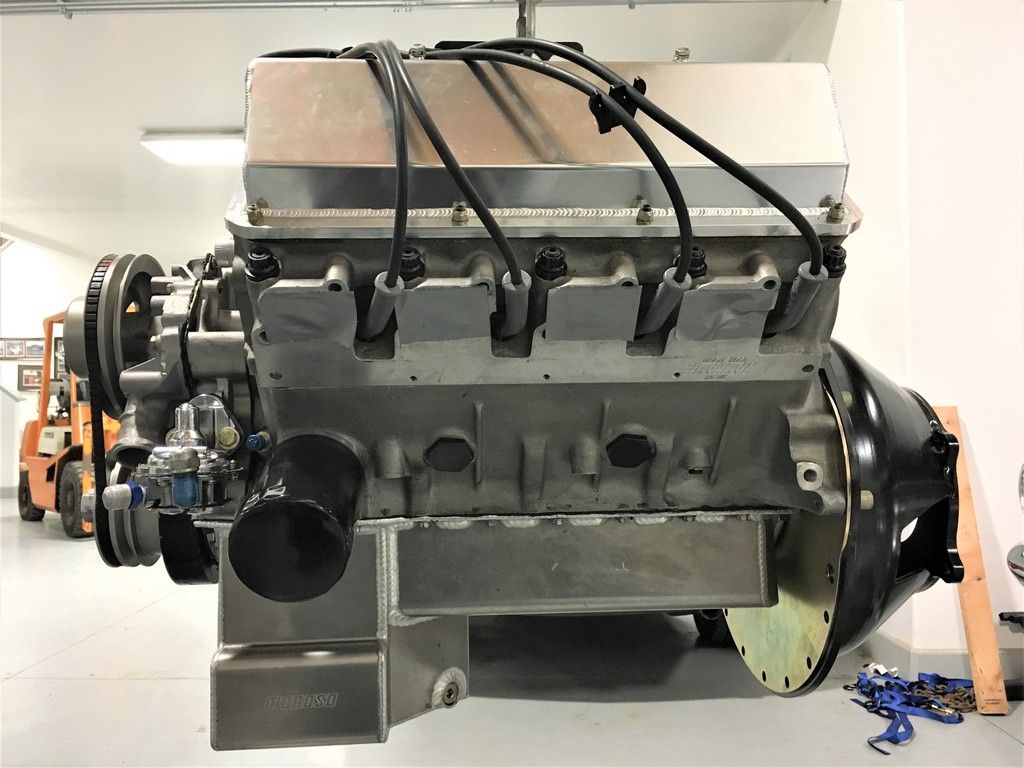

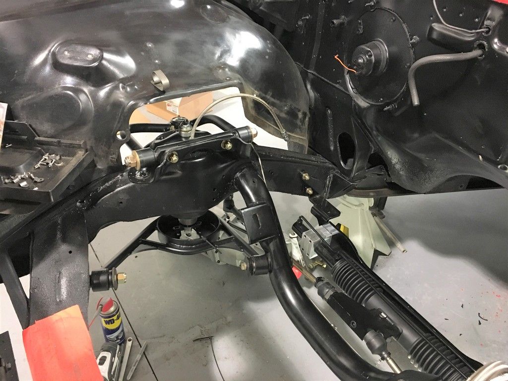

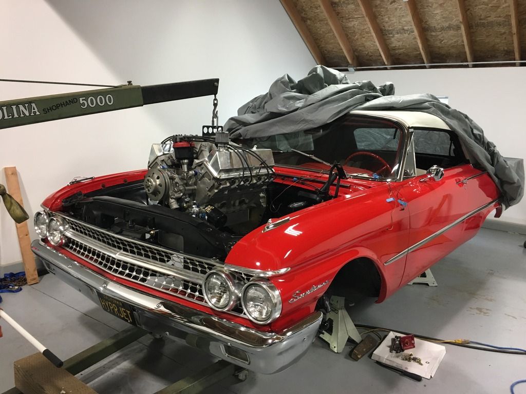

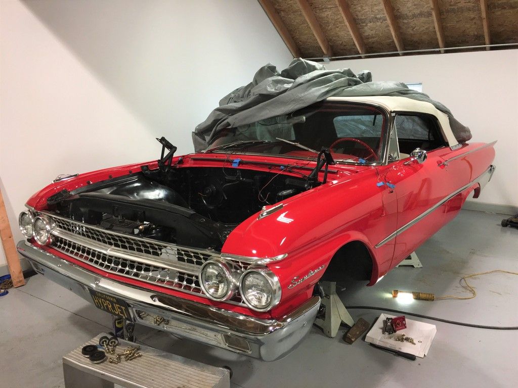

My buddy picked this 61 Galaxie Sunliner up about 6 months ago with the intent of making it a nice sleeper driver. Well a little time showing him whats out there it has morphed into larger project. The heart of this Galaxie is a 448ci Fontana sbf he has had sitting around waiting for the right car. Ed Ash of Ash Racing Components in Umpqua OR Built the engine. Im not positive on the internals but it topped off with a pair of Robert Yates C3 heads and a nascar spec Ford racing intake. I do know the engine dynoed at 571hp @5500 rpm and 607ft @4500 and idles at 750rpm. My buddy being a racer at heart had to have a manual gearbox so after lots of checking around we setteled on the McLeoud Musclecar 5. Our original intent was a Legend LGT-700 but we could not find one available. I should mention that one of the priorities of this build was to cut the car as little as possible saving its originality. The The suspension consists of Ride Tech triangultaed 4 link and shockwaves in the rear mated to a Currie 9" with 3.89 gears and wilwood disk brakes and 4 piston calipers. The front rides on shockwaves and Fatman Fabrications tubular control arms and wilwood brakes as well. Another concern he had was fixing the vague factory 61 steering. After a little research we decided on unisteer rack and pinion setup. I dont have any picc from the very start but I've been trying to take as many as possible durring the build.
http://i178.photobucket.com/albums/w...psqhlk8sf5.jpg
http://i178.photobucket.com/albums/w...psoz6dya32.jpg
http://i178.photobucket.com/albums/w...psvopdbe0d.jpg
http://i178.photobucket.com/albums/w...psz49cbczp.jpg
http://i178.photobucket.com/albums/w...psdi70gmhi.jpg

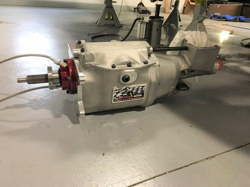

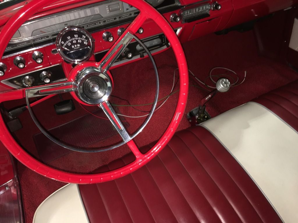

526hp8o 05-28-2017 11:15 AM

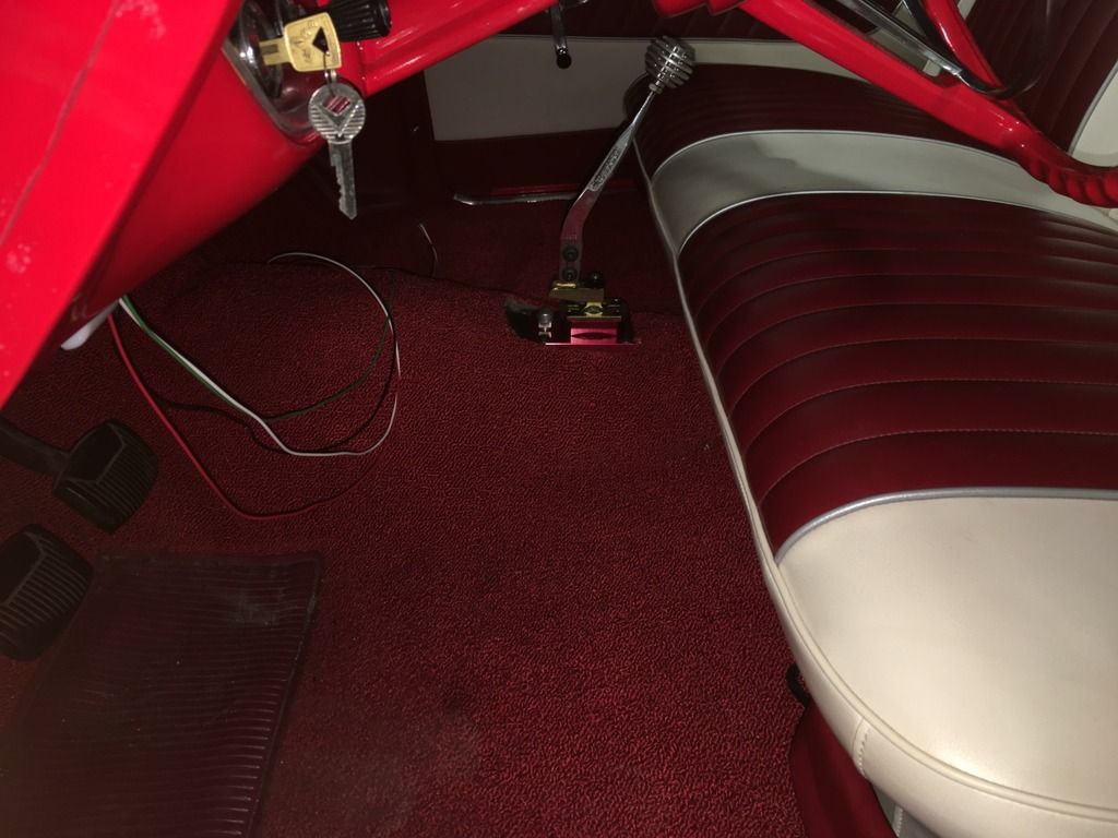

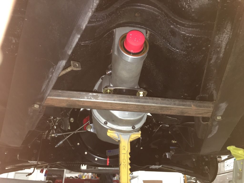

Here are a few of the tranny. It fit very well only needed to cut a 4x5 inch hole in the floor and the shifter location is perfect.
http://i178.photobucket.com/albums/w...ps667wxrg3.jpg
http://i178.photobucket.com/albums/w...psyqhbxy5i.jpg
http://i178.photobucket.com/albums/w...pscguogkre.jpg
http://i178.photobucket.com/albums/w...psgb3drb30.jpg

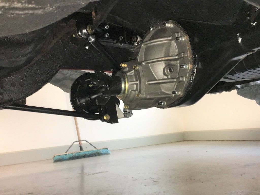

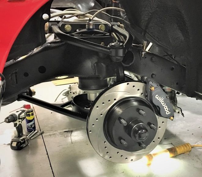

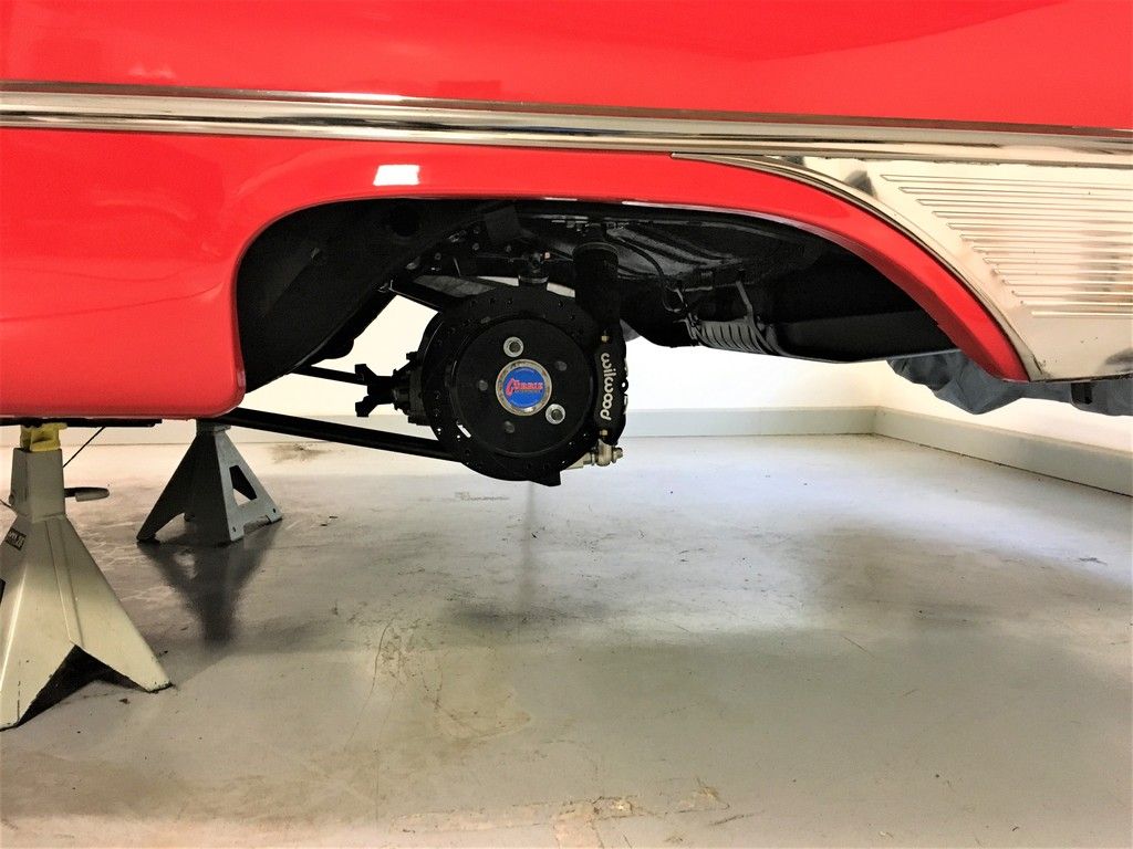

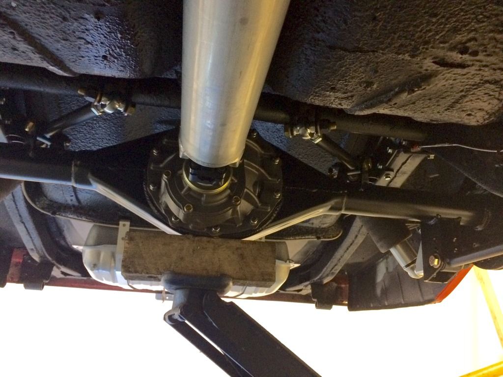

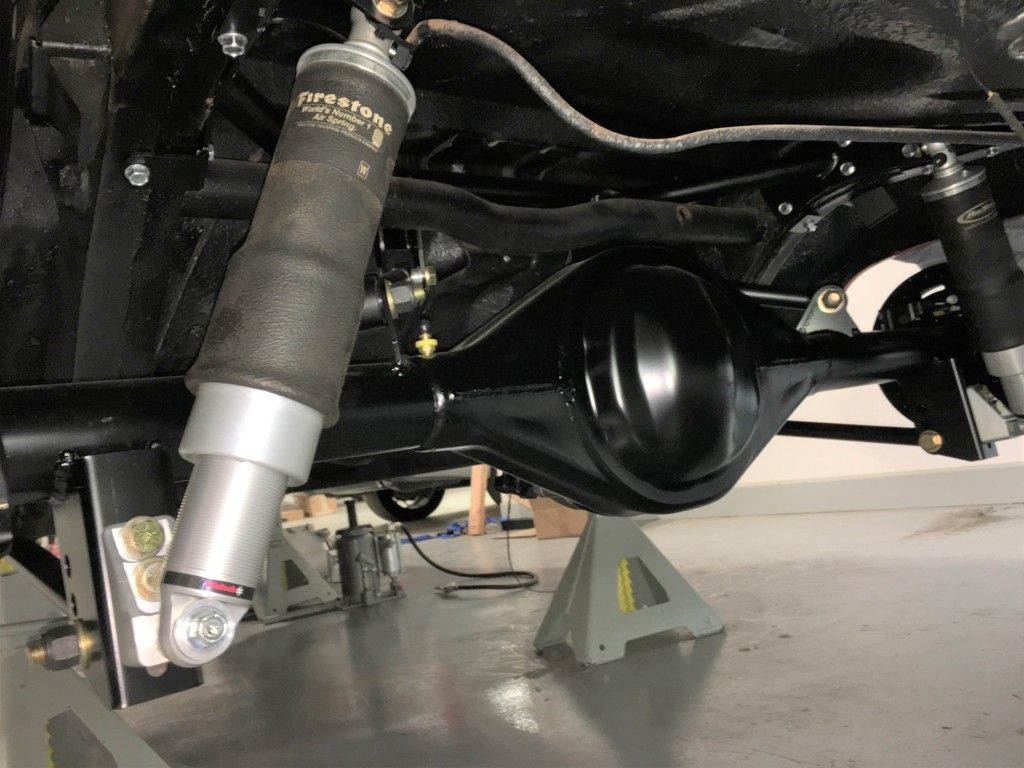

Here are a few of the rear suspension. Currie 9" with Wilwood brakes
http://i178.photobucket.com/albums/w...psshmpyrps.jpg
http://i178.photobucket.com/albums/w...psd1sp2qxn.jpg
http://i178.photobucket.com/albums/w...psqjqbhgqt.jpg
http://i178.photobucket.com/albums/w...psc6hiis7x.jpg

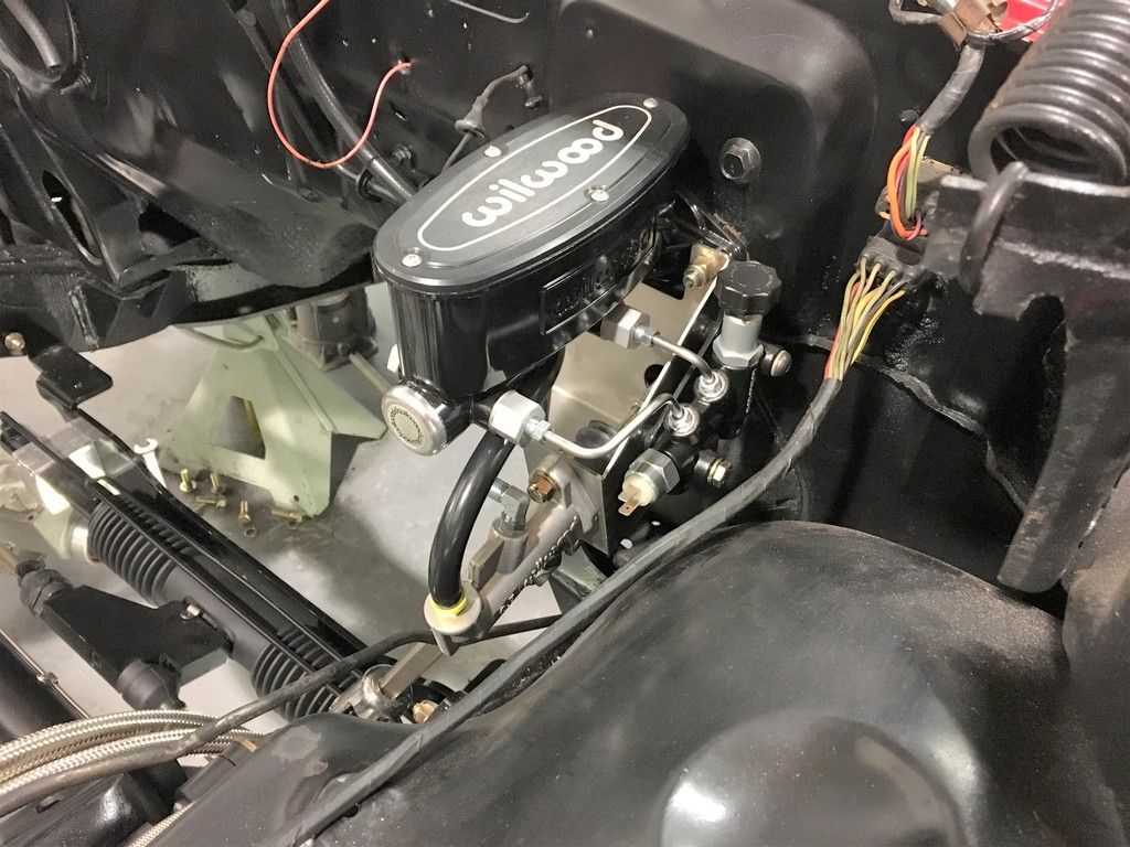

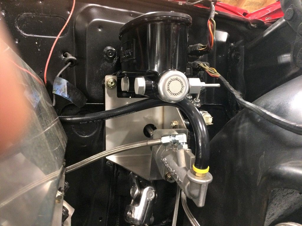

Master cylinder and steering rack and front brakes
http://i178.photobucket.com/albums/w...psk2excuat.jpg
Made a mounting bracket for the slave cylinder that works with the original pedal pivot
http://i178.photobucket.com/albums/w...pskji1yn5z.jpg
http://i178.photobucket.com/albums/w...psxivxusht.jpg
http://i178.photobucket.com/albums/w...pssocdvtb0.jpg

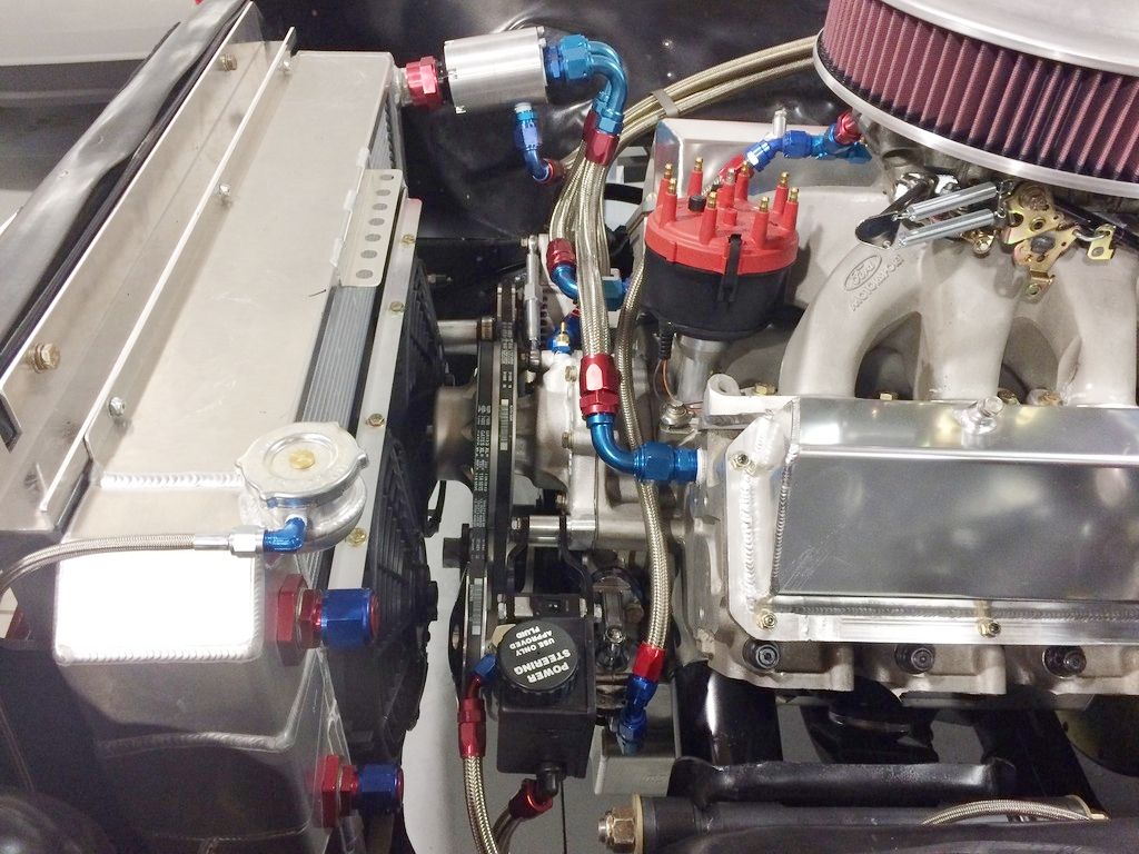

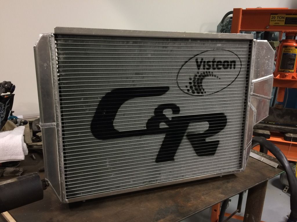

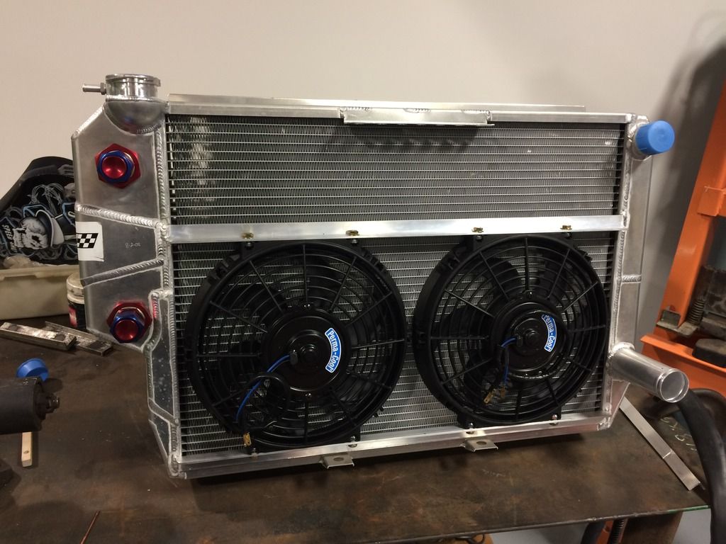

Had a spare radiator from the old race car laying around and what do you know it fits
http://i178.photobucket.com/albums/w...psurmighlw.jpg
had to weld on some fan mounting brackets
http://i178.photobucket.com/albums/w...pszyvk7e8p.jpg
http://i178.photobucket.com/albums/w...ps6tagsn2j.jpg
http://i178.photobucket.com/albums/w...pspcmfthpe.jpg

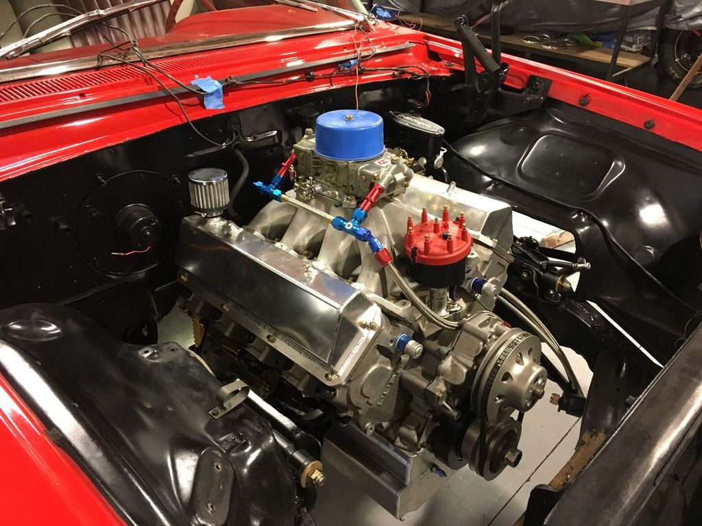

526hp8o 05-29-2017 06:56 AM

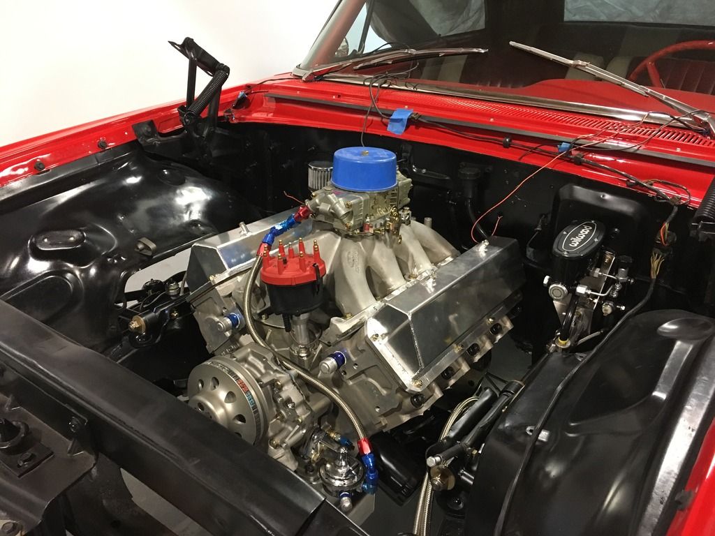

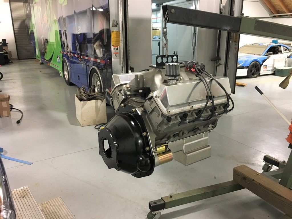

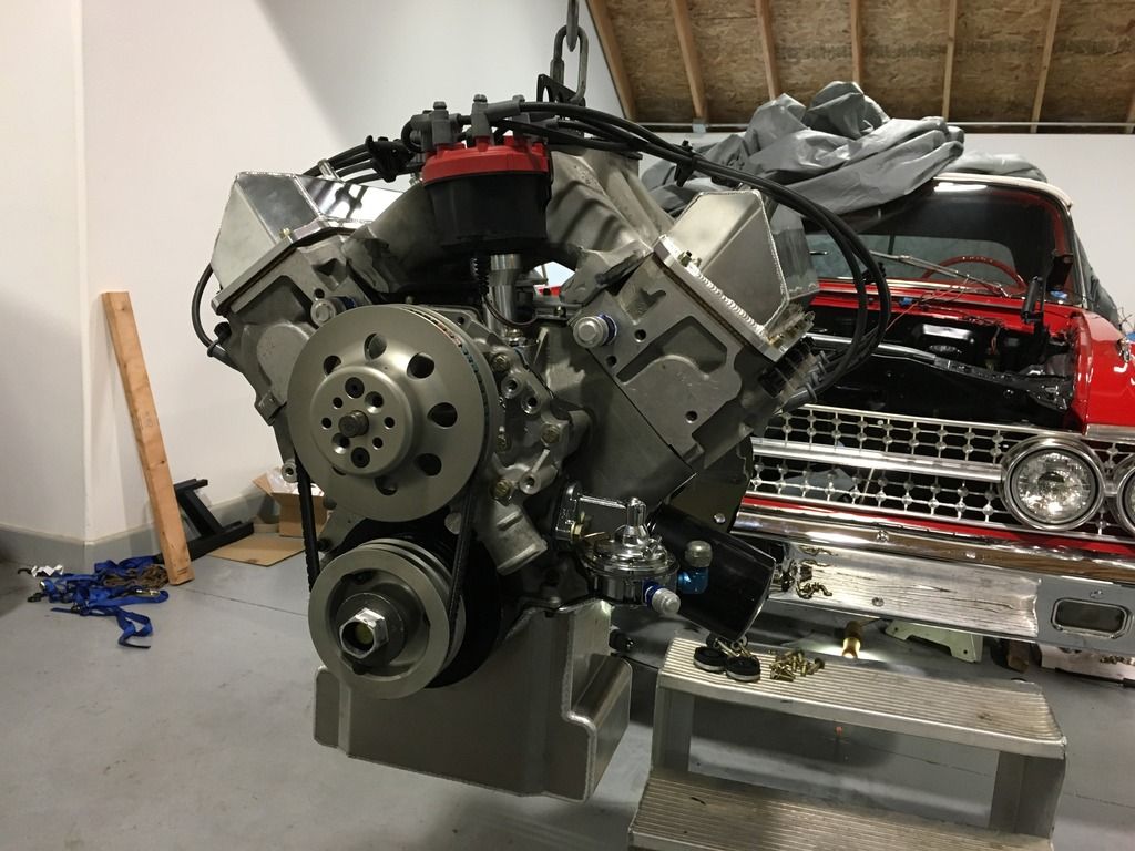

got the engine mounts made and dropped her in
http://i178.photobucket.com/albums/w...pseetfzbvw.jpg
http://i178.photobucket.com/albums/w...psjtumgyhk.jpg
