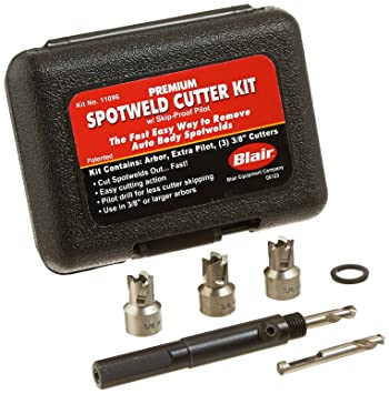

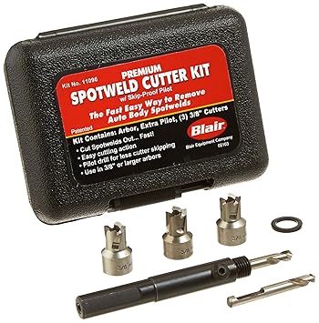

kevin_l 08-04-2017 07:16 PM
https://images-na.ssl-images-amazon....nL._SY355_.jpg
A quality spot weld cutter makes all the difference.
rocketrod 08-04-2017 07:31 PM
^^ What he said. I have that same one and I have drilled out about 100 spot welds with a single cutter.
