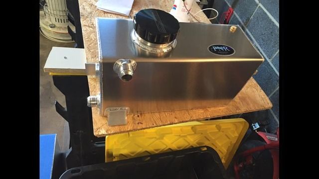

waynieZ 06-18-2018 08:25 PM
This guy built mine custom . https://www.facebook.com/paul.revaitis
here's a picture
http://i172.photobucket.com/albums/w...pstzswvm24.jpg
