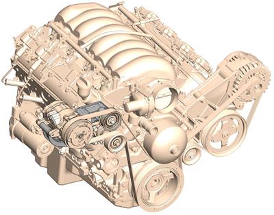

First off the Holley Alternator bracket is on the drivers side of the engine, no interference on that side with anything that drives the supercharger. The Holley high mount AC bracket is on the passenger side:
https://static.summitracing.com/glob...-20-134_nt.jpg
The tensioner for the supercharger needs the real estate where this AC bracket mounts:
https://ls1tech.com/forums/attachmen...pssdeqihen.jpg
LSX Concepts makes a setup that works with THEIR high mount AC mount. I assume it wont work with the Holley brackets because their tensioner bracket needs more room between the belts than what is available with Holley's bracket.
An adapter bracket to mount the tensioner to the waterpump looks simple enough to make if you want to go that route. Although doesnt look near as beefy as the OEM mount.
https://i.imgur.com/0N29Bvp.jpghttps://i.imgur.com/nfaWbNM.png
