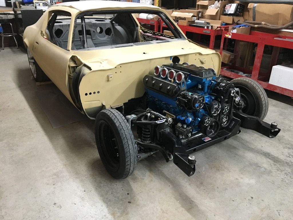

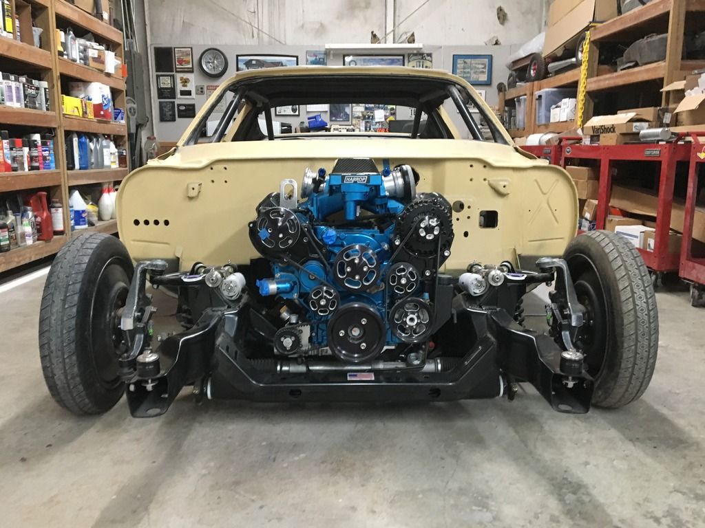

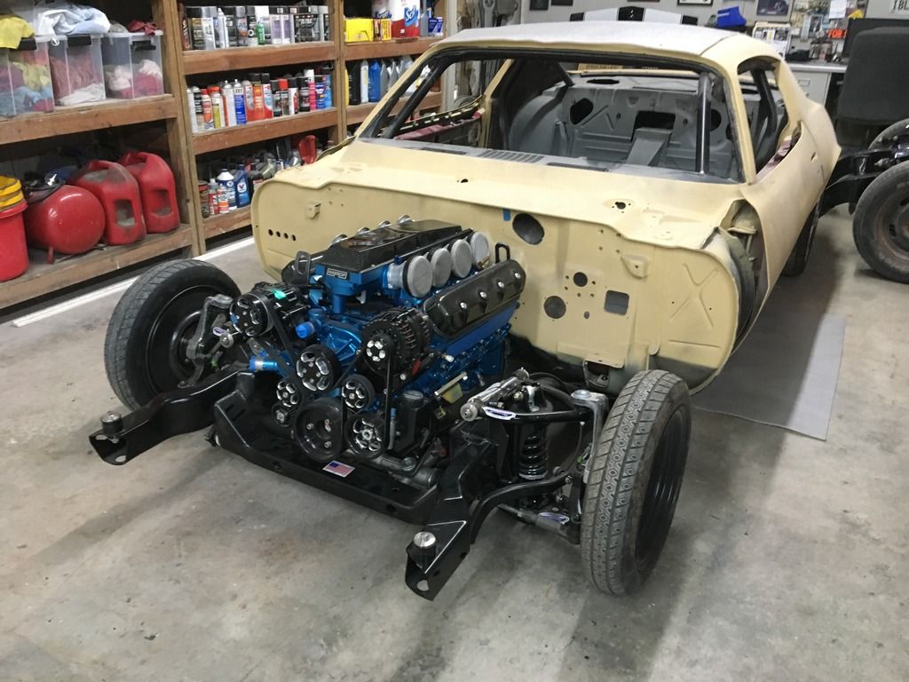

We are working towards paint just mocking up the engine and tranny now. I have been asked how the harness will travel through the bulkhead. I really like the MILSPEC connectors. The wiring is down the road a bit but I want the holes predrilled while we finish cleaning up the firewall. I have no idea how many wires between the engine harness and the body harness would pass through the bulkhead. I would rather overkill than have to go back and drill new holes. I have considered the MILSPEC 41/45 kit but not sure. Any help would be appreciated.

check out Terminal Supply out of Troy MI. They started selling Mil type connectors. I did my car with actual Milspec connectors only because I couldn't find any other options. Now that Terminal supply sells something similar I would try theirs for price and ease. I never found one source to get all the milspec connectors I needed so it was a pain. plus very pricey.
