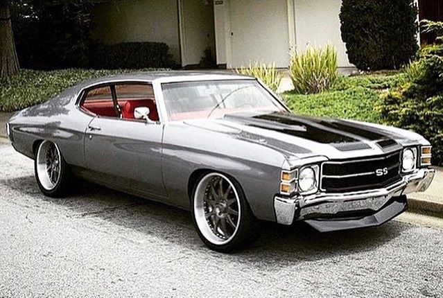

19s and 20s look great on that size of a car and we typically do 9s and 10s with stock wheelwells.
http://i256.photobucket.com/albums/h...pstcyqax9r.jpg
