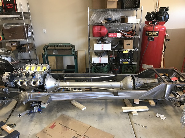

2 Attachment(s)
Drive train installed. Set engine back about 2", but torque tube still too short.
Attachment 66417
Fabbed up motor mounts to move engine back to clear blower pulley from rack.
tdishon 07-19-2018 10:08 AM
3 Attachment(s)
Chassis update: Just about current. This last month I sent out the torque tube to Gamel Street Rods to extend 2" and install a larger drive shaft with ZR1 couplers. The rear end is from RPM. ZR1 Stage4 with 3:42 and Wavetrac.
I have the body at my buddys shop. I'll get some pics of that up next. Cutting out the GMC dash to install a 59 Impala dash.
