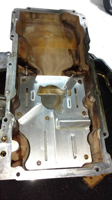

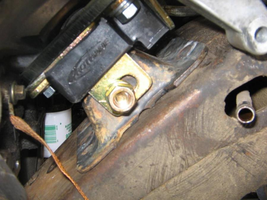

I noticed you are using an F-body oil pan. Did you have to do anything to keep the inner tie rods ends from hitting it at full lock? Have you thought of using the roadrace baffle for inside the pan. I think there is one available for the stock pans as well as the Holley pans.

I have a trap door baffle in the fbody pan from improved racing. Last year my buddy blew his olds up with a non baffled pan. My videos show me doing over 1 g in corners.
My tie rod ends don't touch the pan now that I've raised the mounts 1/4 inch. Then pic is of the mounts before I installed the spacers.Attachment 67404Attachment 67405
