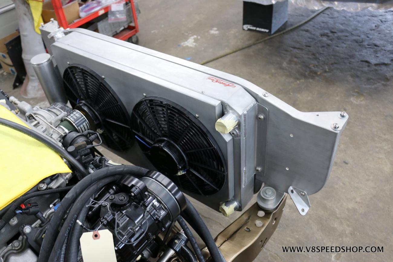

732ndgen 09-05-2019 06:59 PM
intercooler
2 Attachment(s)
[attach]Attachment 70094[/attach]
Dave95z28 09-05-2019 08:40 PM
Is that whole stack all Autorad? I have their radiator and core support I bought from some one before getting a LSA and I was thinking about getting their heat exchanger. What’s the small one up top? Transmission or Oil?
jmac 09-07-2019 06:12 AM
Man that Autorad setup looks killer. Love the car, nice work!
