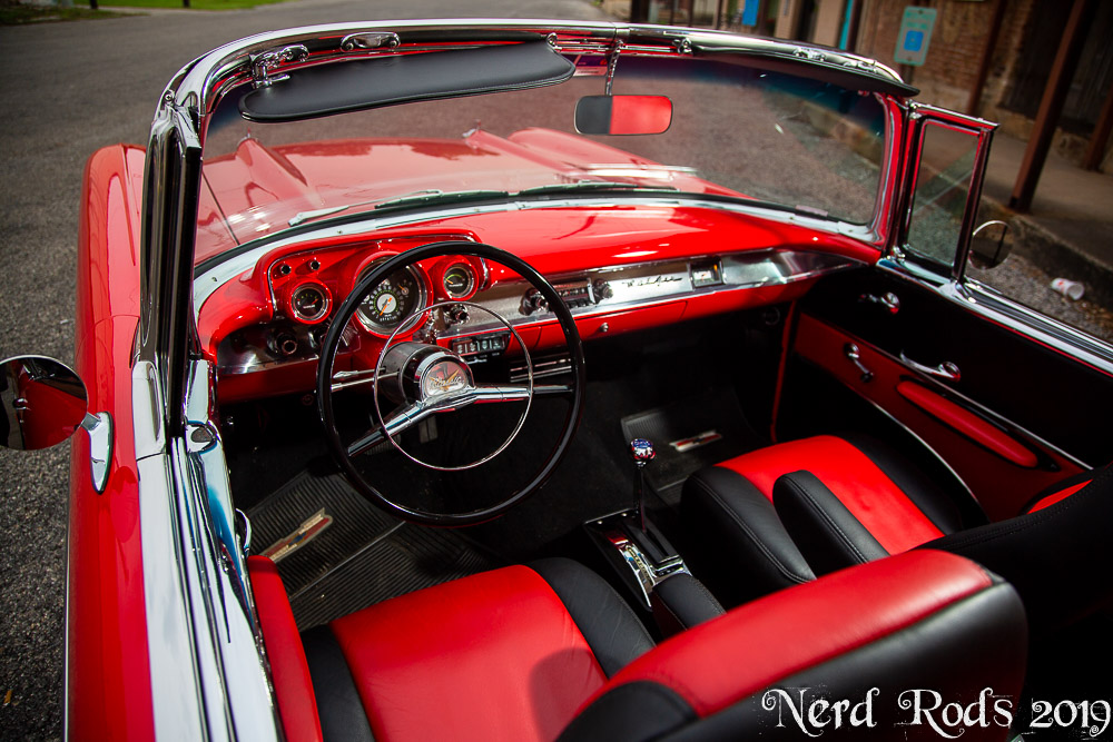

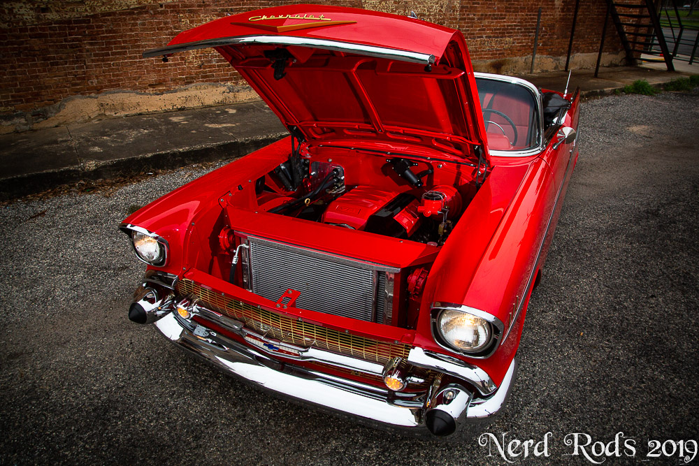

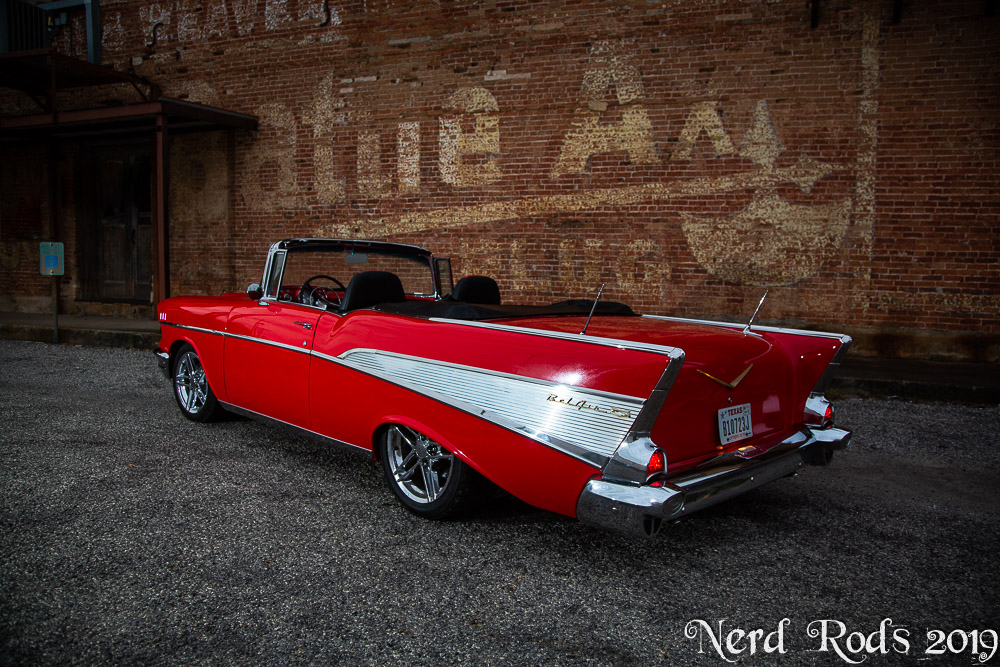

1957 Chevy Convertible, Red Top Down Photo Shoot

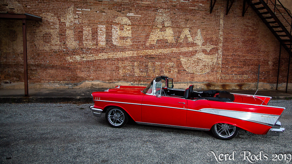

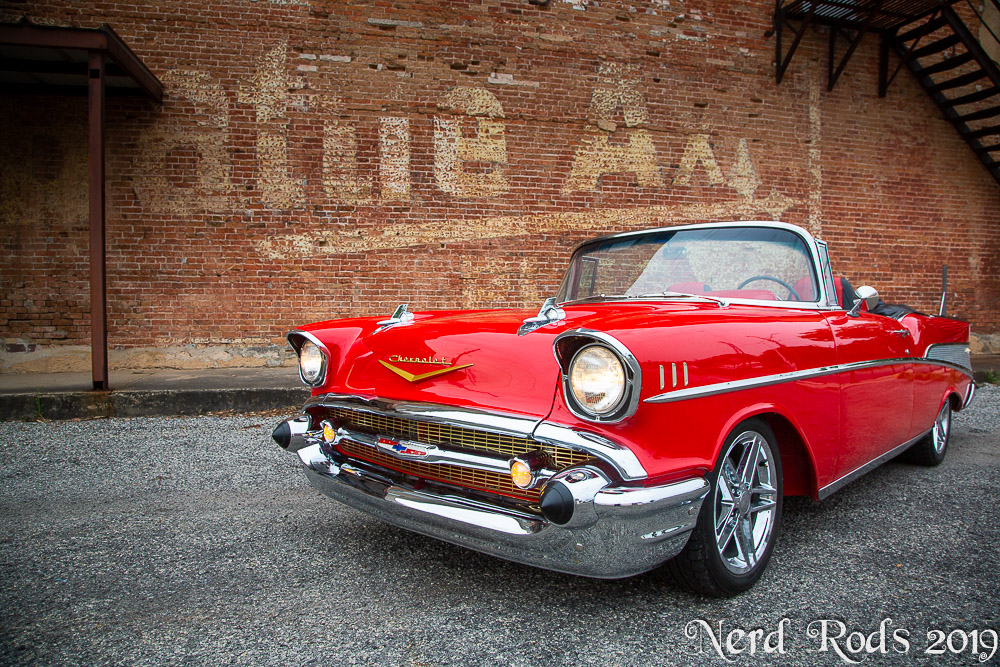

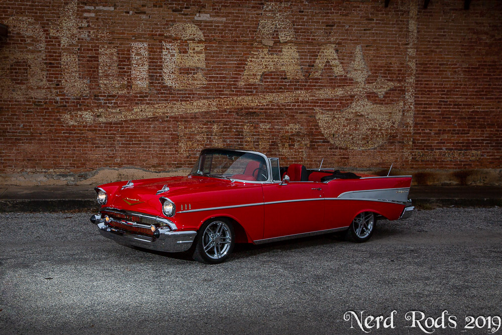

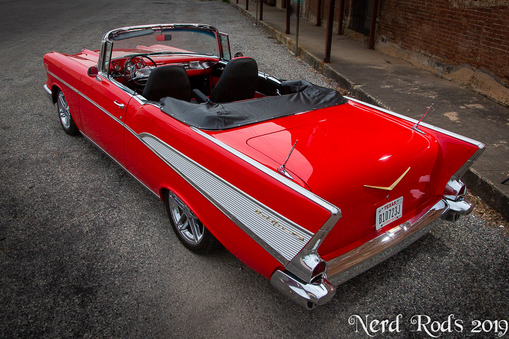

Only my second time really playing with flashes so forgive me. I'd have done more but I was in the middle of a public street in Luling shooting before a rain storm broke loose at dawn after the model no showed on me. My mind was a bit preoccupied unfortunately. I learned a ton and can't wait for the next customer's car to play with.
This is one of my weld it yourself frames with C4 Corvette Suspension and the customer brought it down for suspension tuning. LS3, 4L80, IRS Suspension, Power Rack and Pinion, Sway bars, Double Adjustable QA1 Coil Over shocks. A fun car for a drive after I was done with it. Someone had screwed up just one of the rear springs and the car tottered like a rocking horse when it got here. After I was done we were doing some nice trail braking around the corners. No seat belts so I had a small ratchet strap around my waist holding me down to the seat.
Canon 5DM3, 24-105 F4 L, Dual Flashes,
Owner, Dick Pinner,
Builder, Jack Laswell
Photos and Chassis by Russell Alexander
