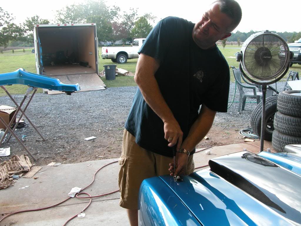

Here's "young" Ty hard at work on the hood latches. hahaha
https://i240.photobucket.com/albums/...shbuild268.jpg

That's me cringing at the thought of drilling/screwing holes into that 100% Anvil carbon fiber hood! LOL
