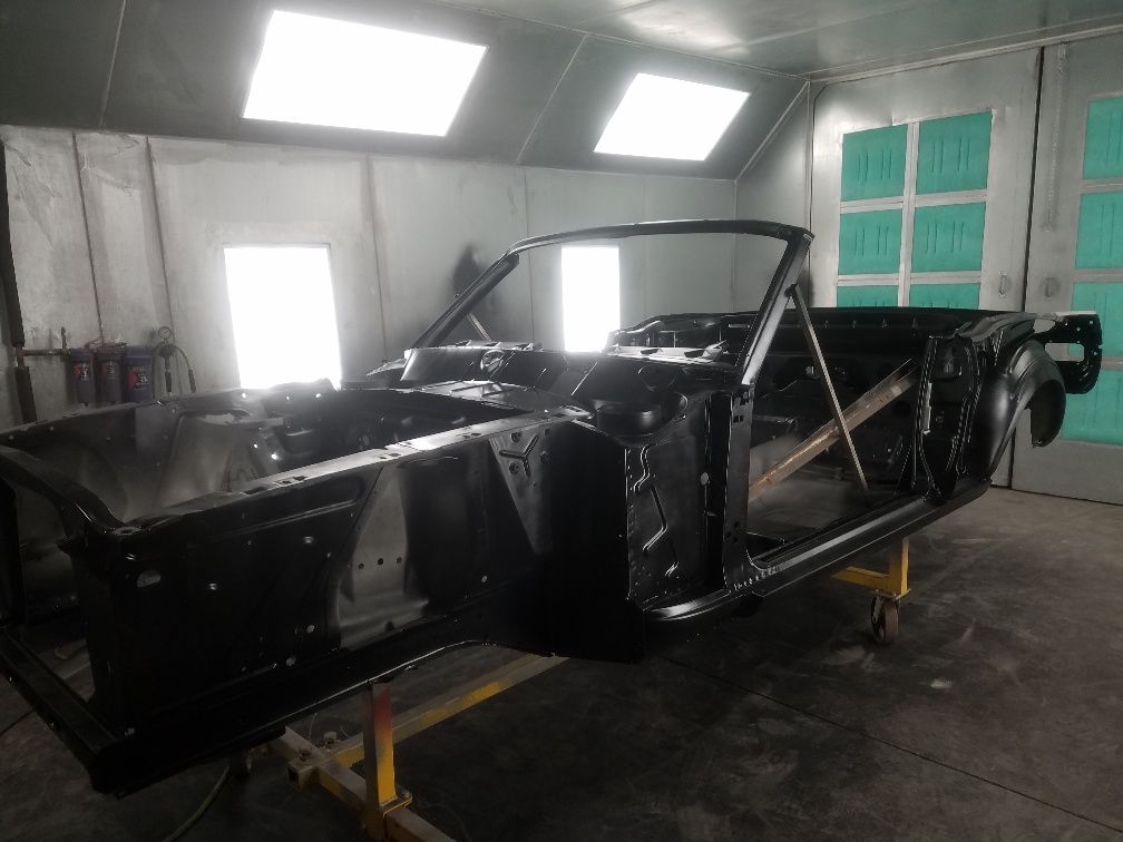

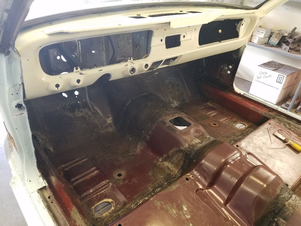

Reliable trucking delivered this 1965 Convertible for a customer from Va November 2018. At first this looked like a very nice Mustang with very little rust but you can tell it wasn't a good paint job. She still wants it painted "Baby Blue" and mostly stock on the outside. Her Husband is building a new small block with a C4 transmission with a Gearvenders overdrive. We will be installing DSE front and rear suspension and she wants leather interior. They bought this back in Aug. 2018 and they wanted a rust free Mustang when we are finished with it. I suggested she drive this one for the 1 1/2 years it was going to take to restore and sell it when we finished building the 65 convertible we had behind the shop. To make it rust free everything has to be removed to get to the inner structure and epoxy primed. She wanted this one restored

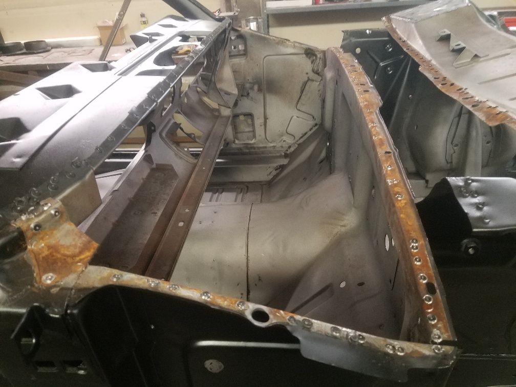

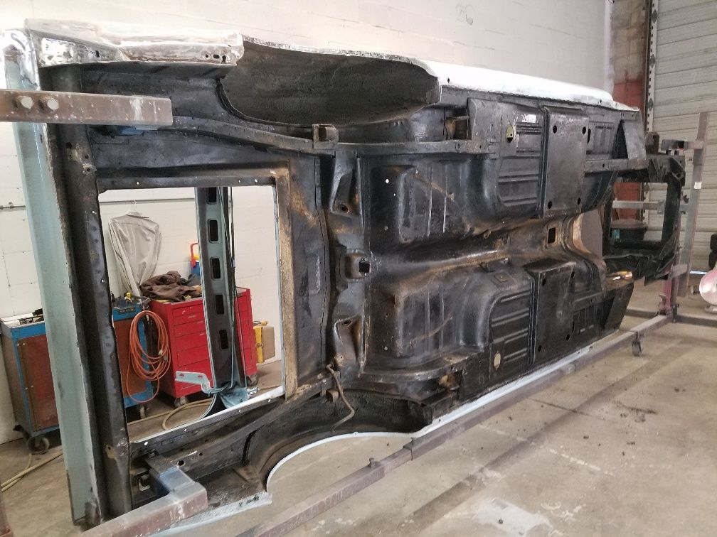

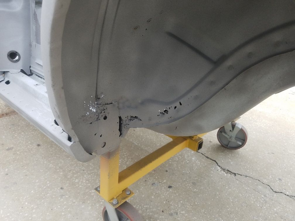

GPR 01-05-2020 07:27 AM

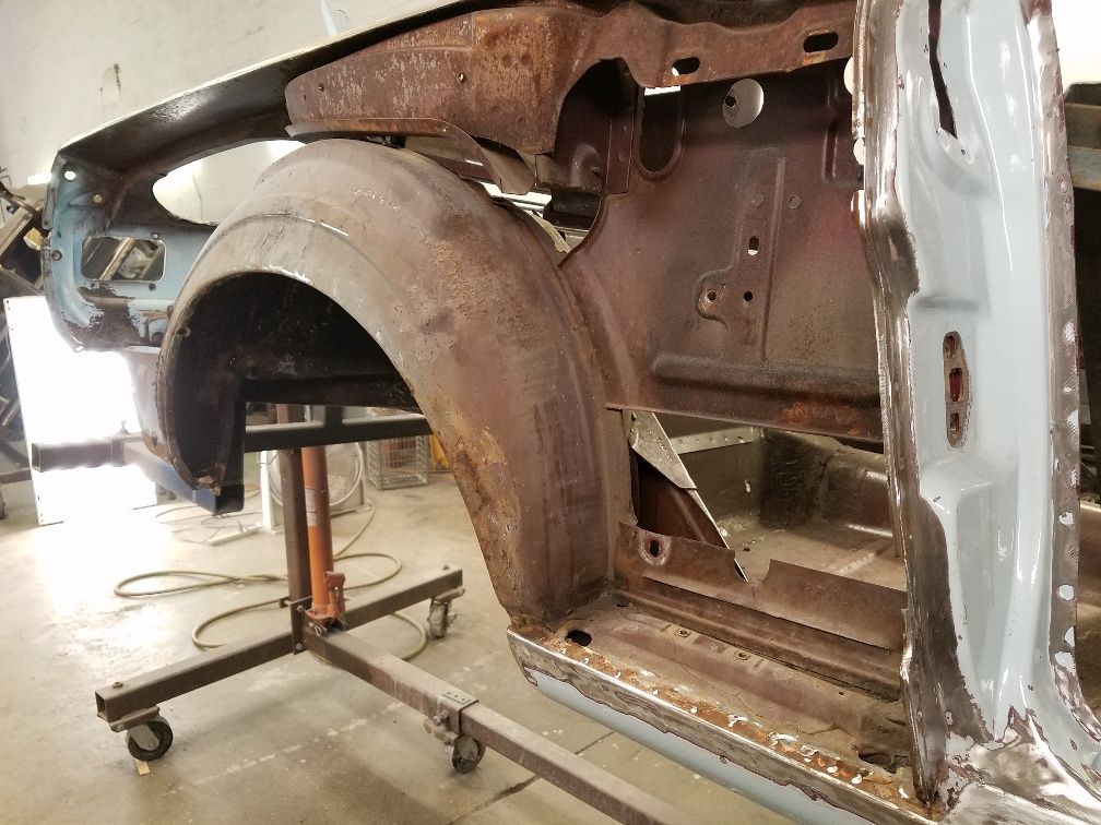

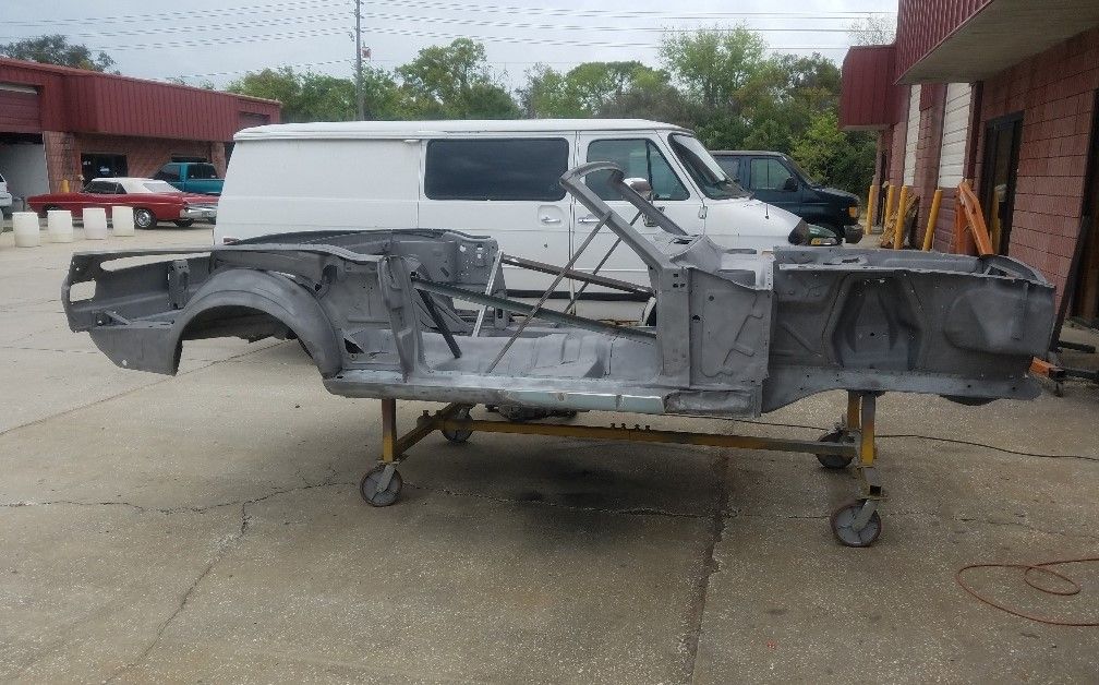

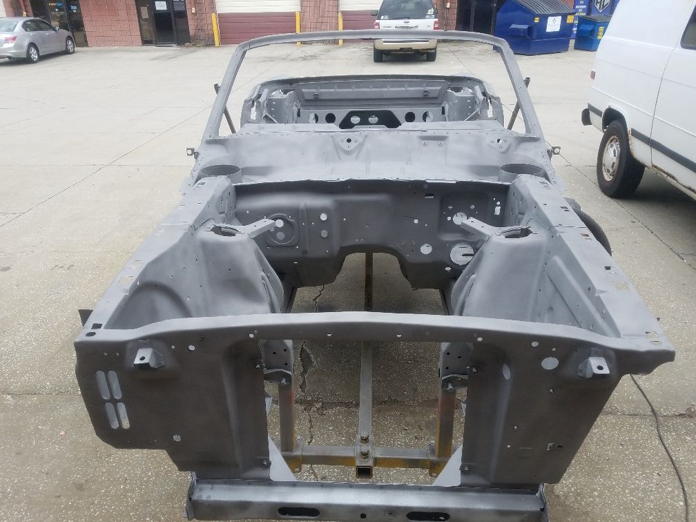

Back from the sandblasters. Brian has a lot of rust repair before the fun starts installing the DSE suspension and flaring the fenders and quarter panels.

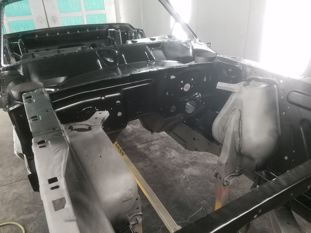

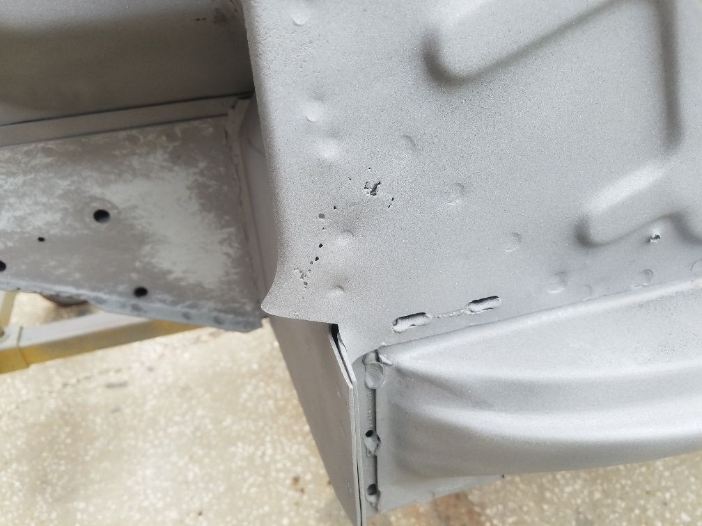

GPR 01-05-2020 08:06 AM

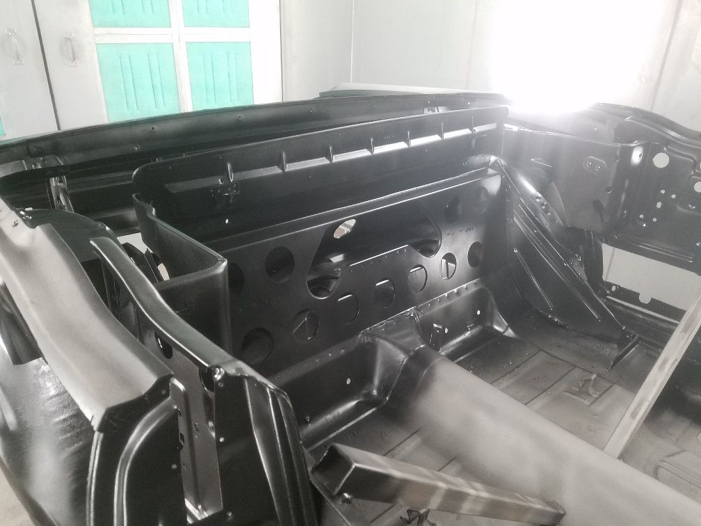

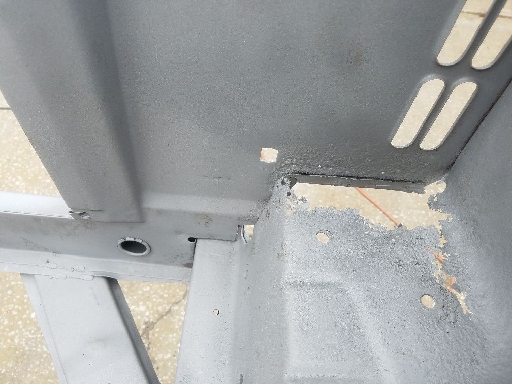

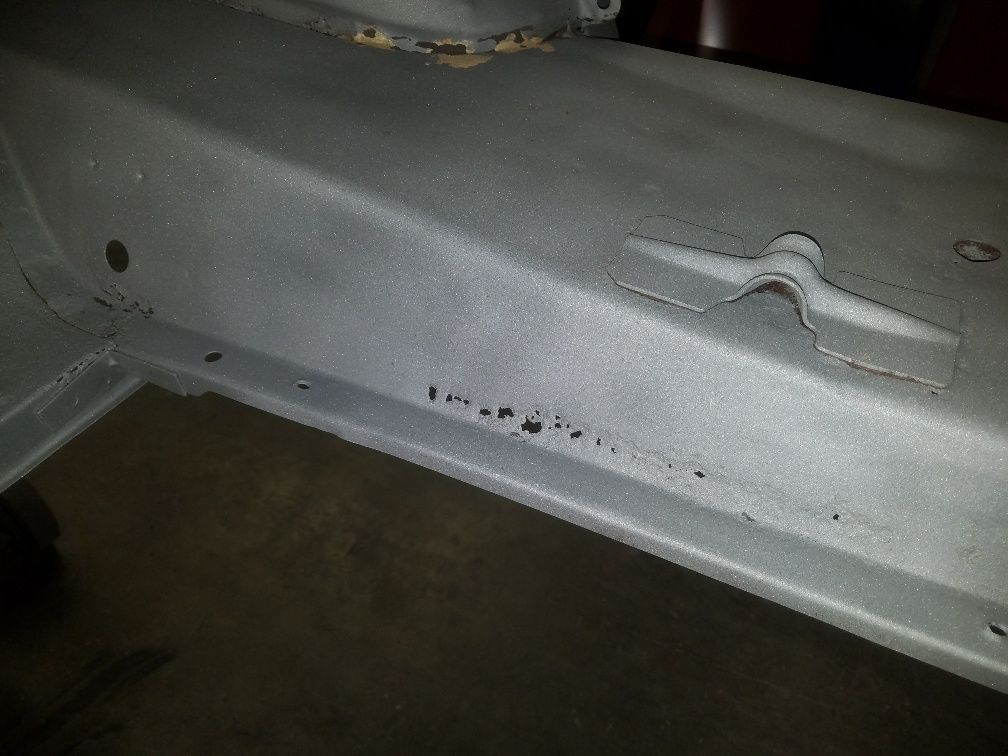

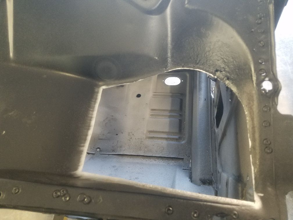

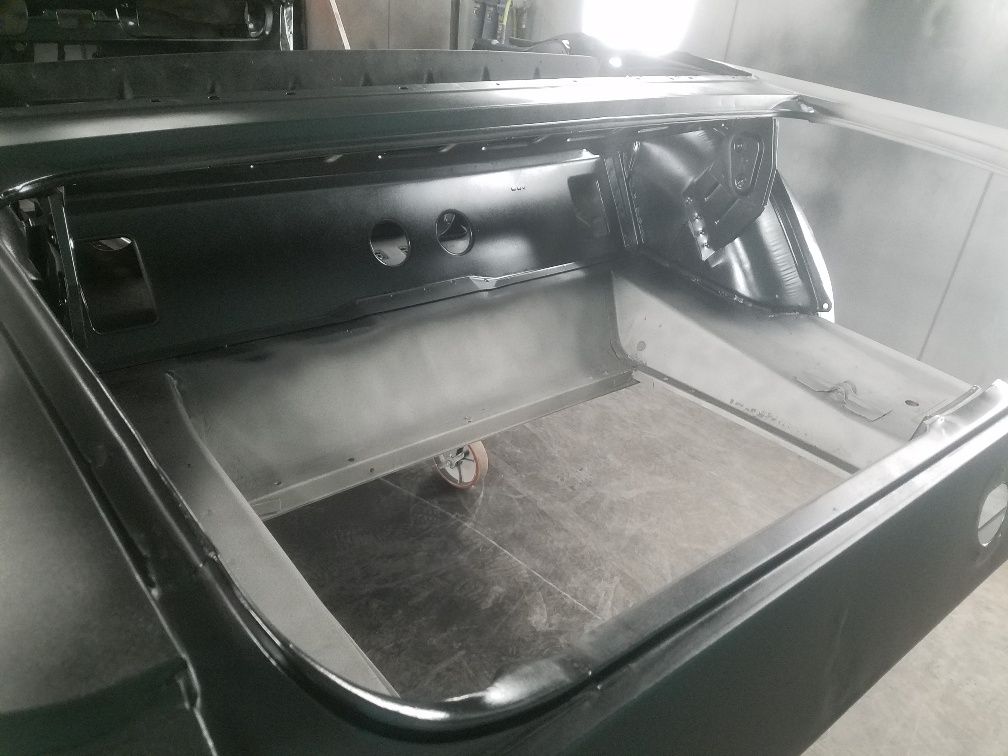

I sprayed two coats of SPI epoxy primer on the area that won't be replaced.
https://img.photobucket.com/albums/v...pstrtrajdh.jpg
https://img.photobucket.com/albums/v...psqc2zkgqd.jpg
https://img.photobucket.com/albums/v...pswm99dwwf.jpg
https://img.photobucket.com/albums/v...psvwofh3fh.jpg
https://img.photobucket.com/albums/v...psop2svcaa.jpg
https://img.photobucket.com/albums/v...psnwvbozc0.jpg
https://img.photobucket.com/albums/v...psoqcby0xi.jpg
https://img.photobucket.com/albums/v...pskgzet2bs.jpg
https://img.photobucket.com/albums/v...pspgdcgdti.jpg

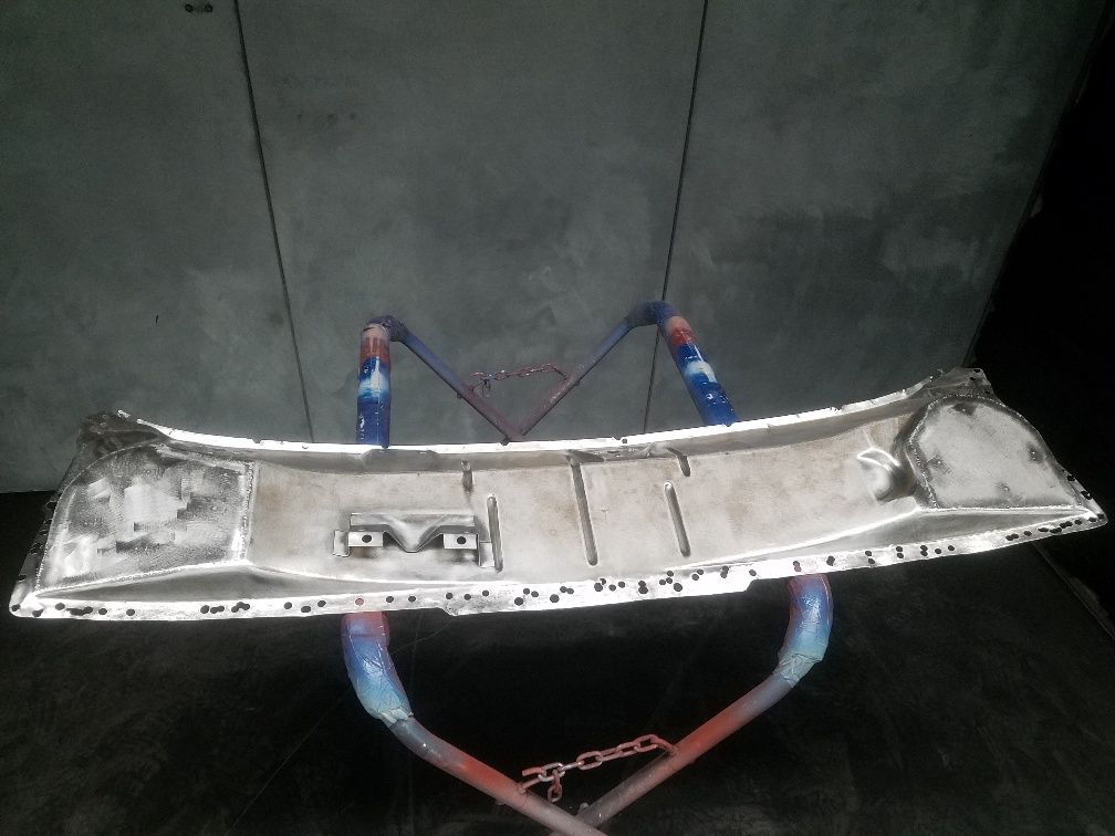

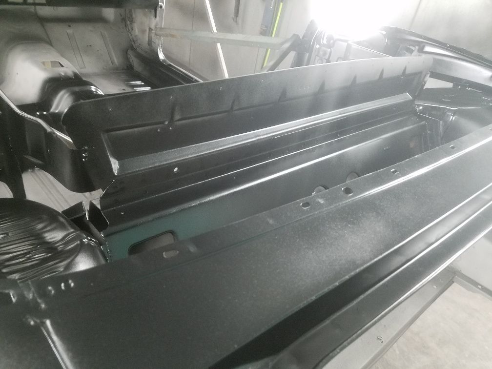

GPR 01-05-2020 08:37 AM

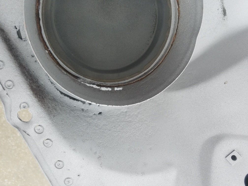

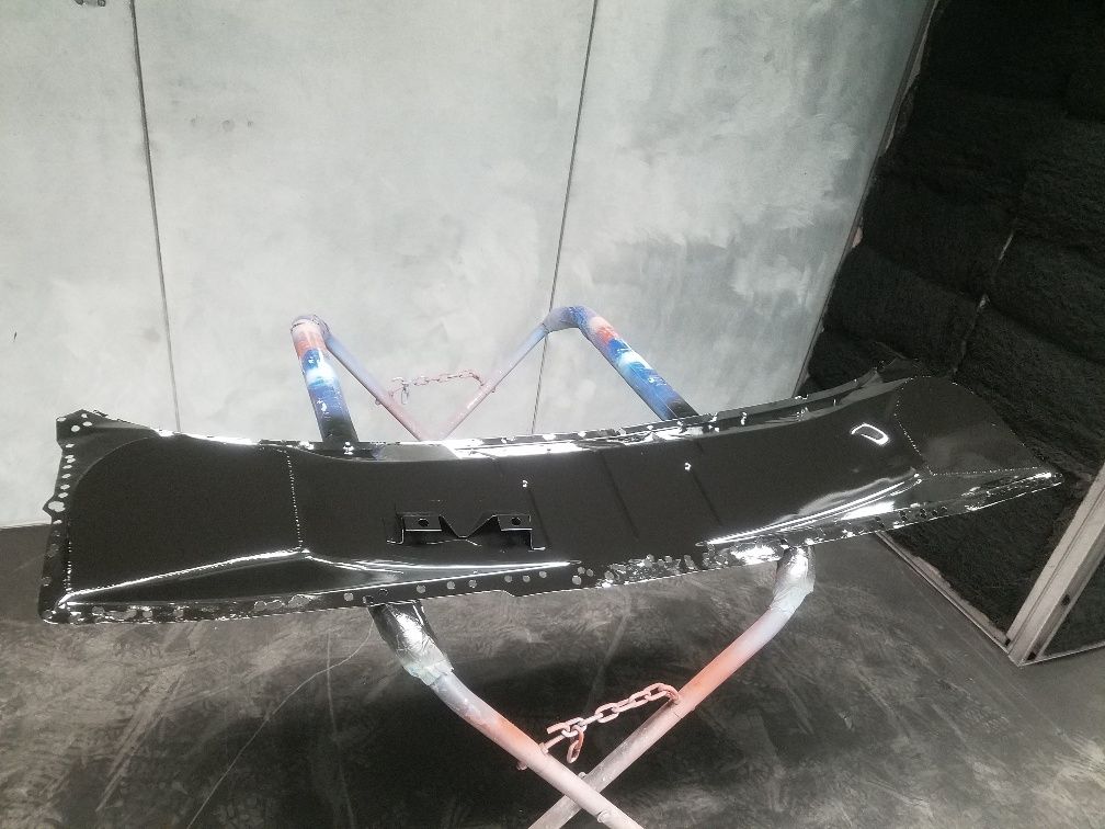

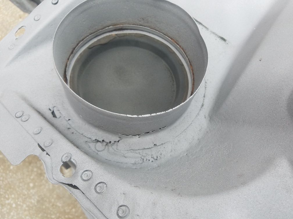

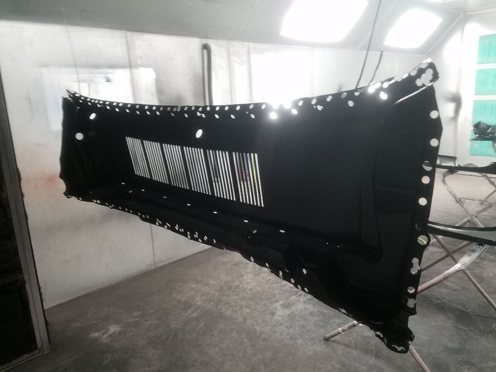

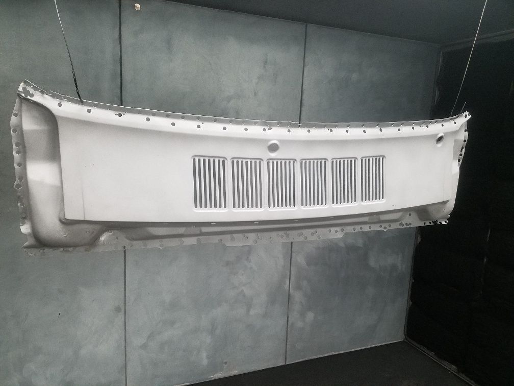

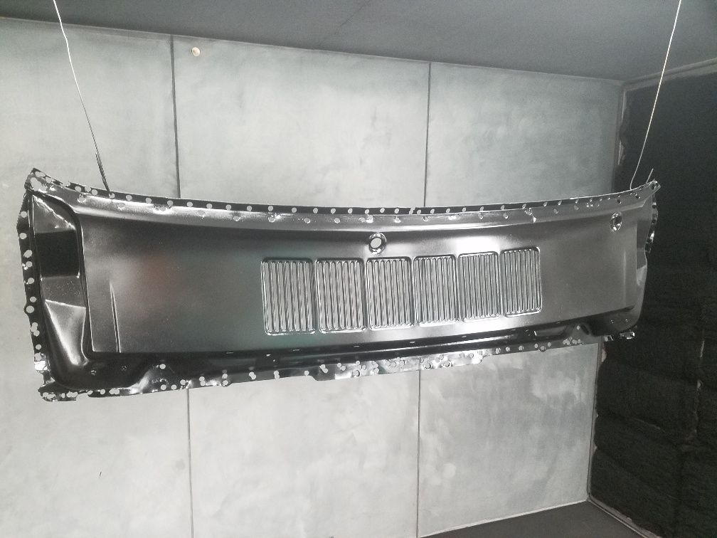

The upper cowl was stripped to bare metal and epoxy primed
https://img.photobucket.com/albums/v...pslorgln51.jpg
https://img.photobucket.com/albums/v...psgwmnfqc9.jpg
https://img.photobucket.com/albums/v...psnr795uex.jpg

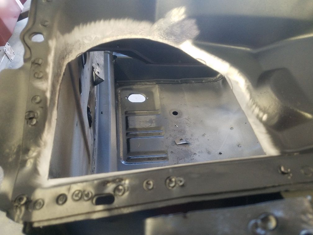

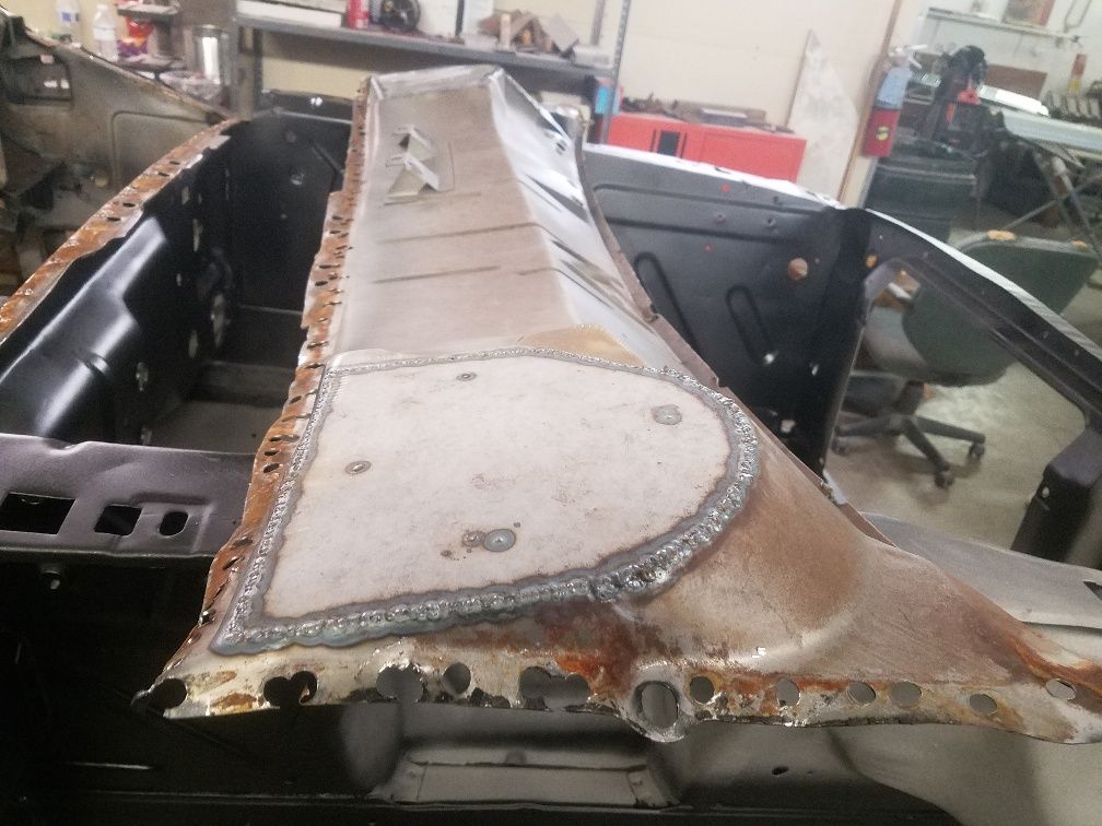

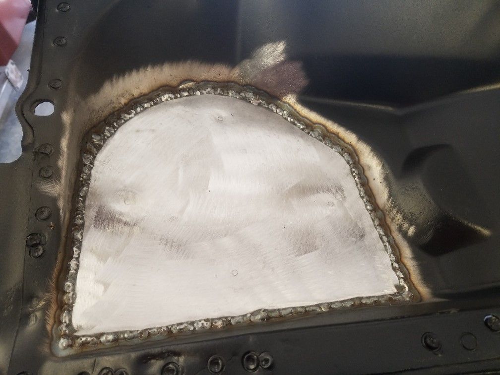

Brian is getting ready to cut out the rust in the lower cowl
https://img.photobucket.com/albums/v...psgwabm14l.jpg

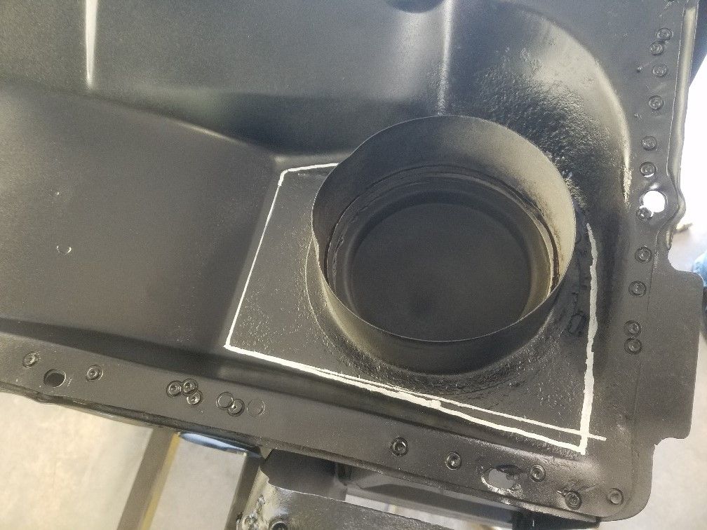

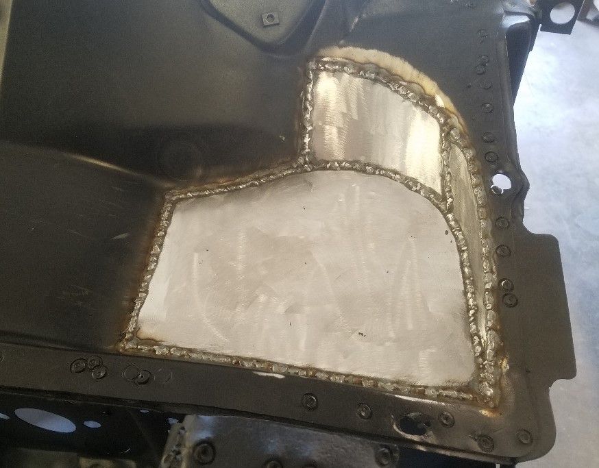

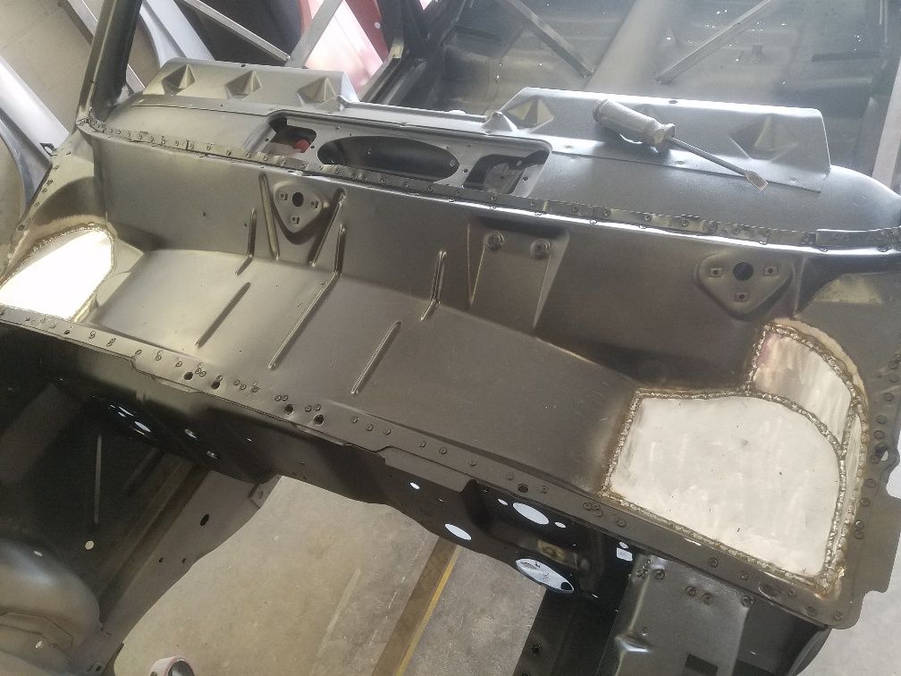

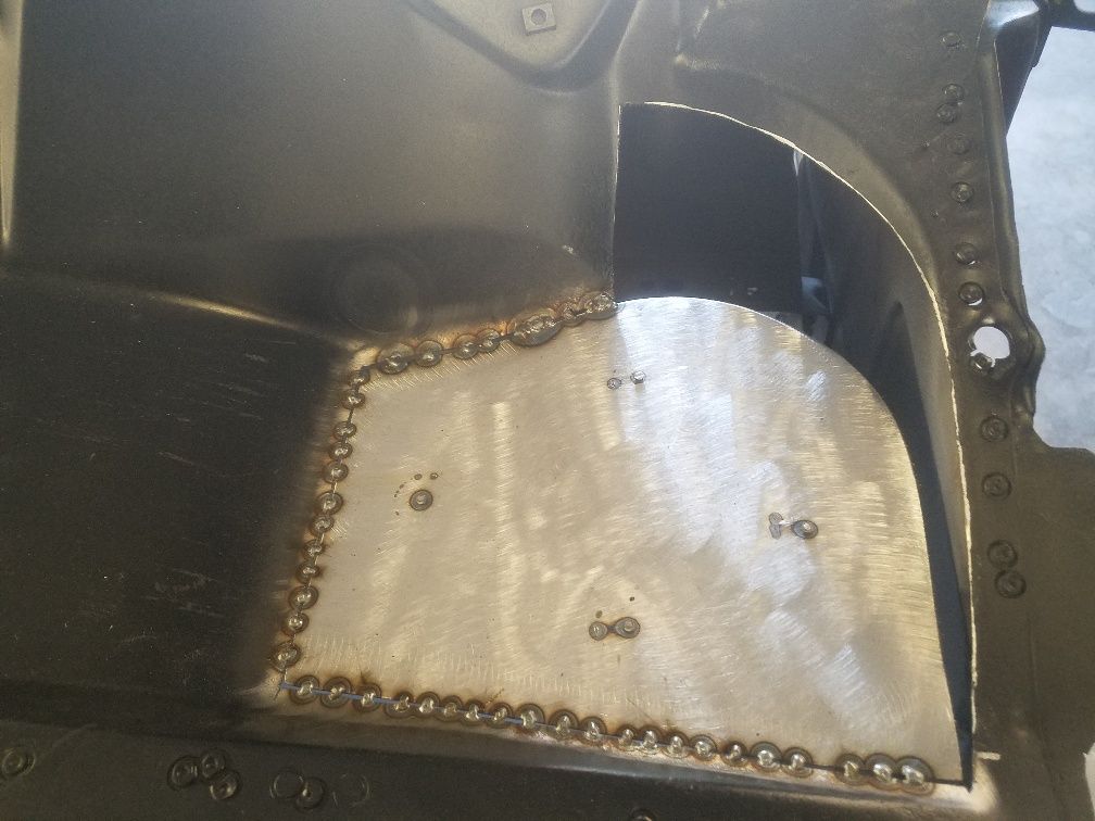

The rust was cut out and a patch panel was welded in place. When you install aftermarket AC the cowl vents are blocked
https://img.photobucket.com/albums/v...ps9ilrqvw9.jpg
https://img.photobucket.com/albums/v...psm9uikfxj.jpg
https://img.photobucket.com/albums/v...ps7upw9dbm.jpg
https://img.photobucket.com/albums/v...pshdj4aeap.jpg
https://img.photobucket.com/albums/v...pslw2yvr8y.jpg
https://img.photobucket.com/albums/v...psexpxe7bc.jpg
https://img.photobucket.com/albums/v...pslorskjfc.jpg

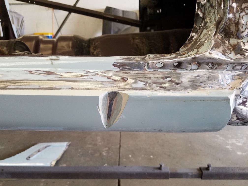

WSSix 01-05-2020 04:58 PM
Is that really a half inch of bondo on the rocker panel?

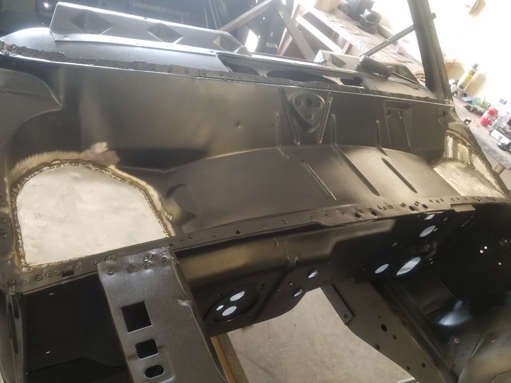

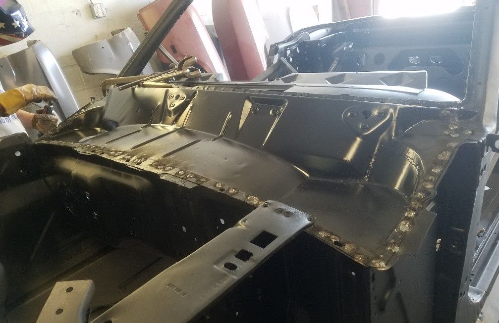

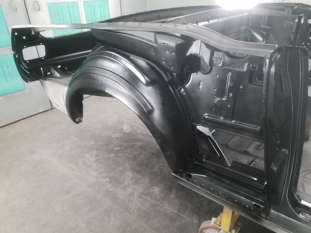

GPR 01-20-2020 06:09 AM
The lower cowl was removed.
https://img.photobucket.com/albums/v...psbtikj8wc.jpg
https://img.photobucket.com/albums/v...psumg0kfym.jpg
All the rust was removed and epoxy primed
https://img.photobucket.com/albums/v...pso3d2buaj.jpg
https://img.photobucket.com/albums/v...pseqhz8ivj.jpg

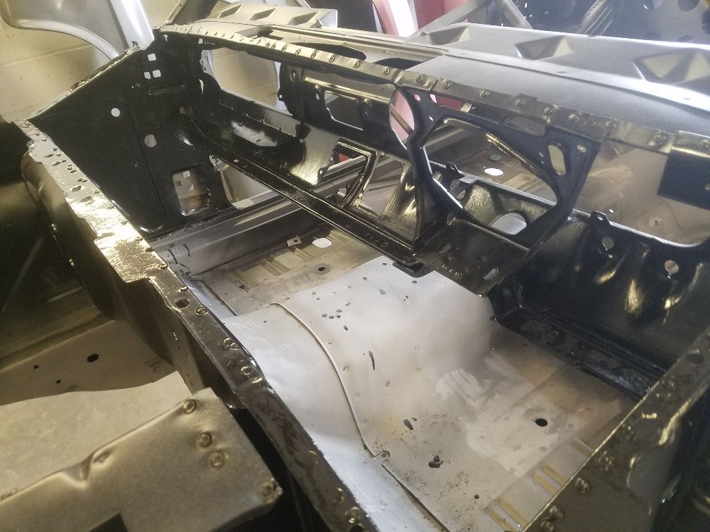

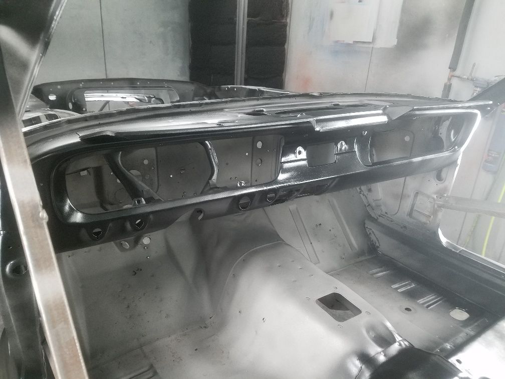

The back side of the dash was sanded and epoxy primed
https://img.photobucket.com/albums/v...pslvxd3ebs.jpg

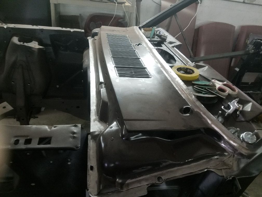

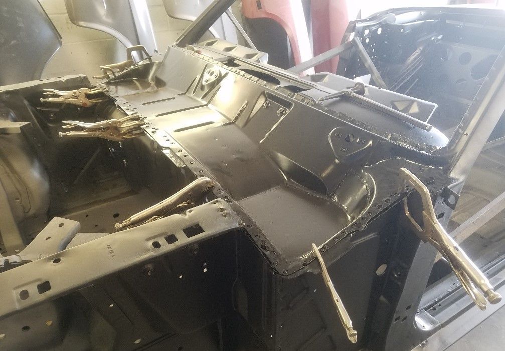

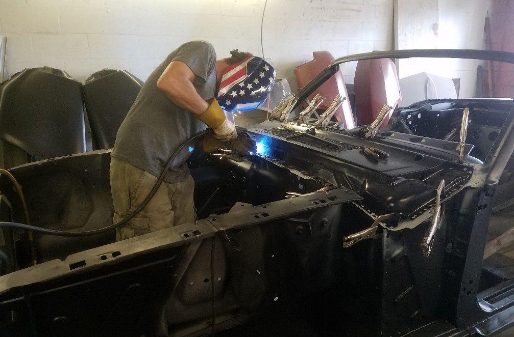

Lower cowl clamped in place and Brian spot welded.
https://img.photobucket.com/albums/v...psovzmmvcm.jpg
https://img.photobucket.com/albums/v...psfljycj8n.jpg
Brian welding the upper cowl and welds cleaned up.
https://img.photobucket.com/albums/v...pslzhqq8nh.jpg
https://img.photobucket.com/albums/v...psmpfbsuzy.jpg

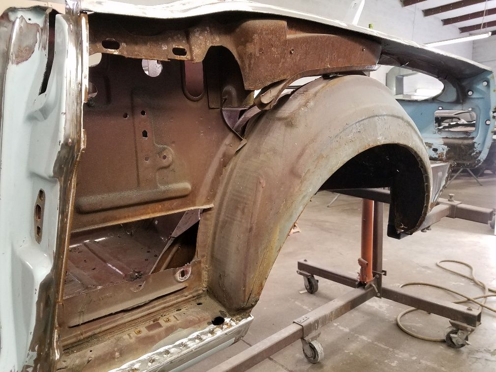

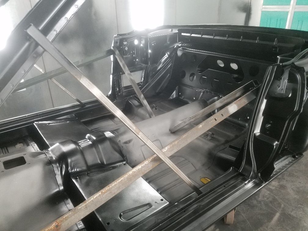

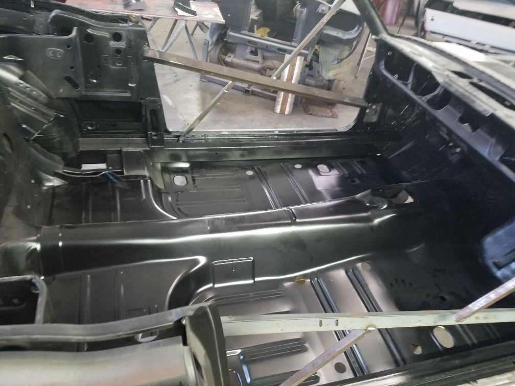

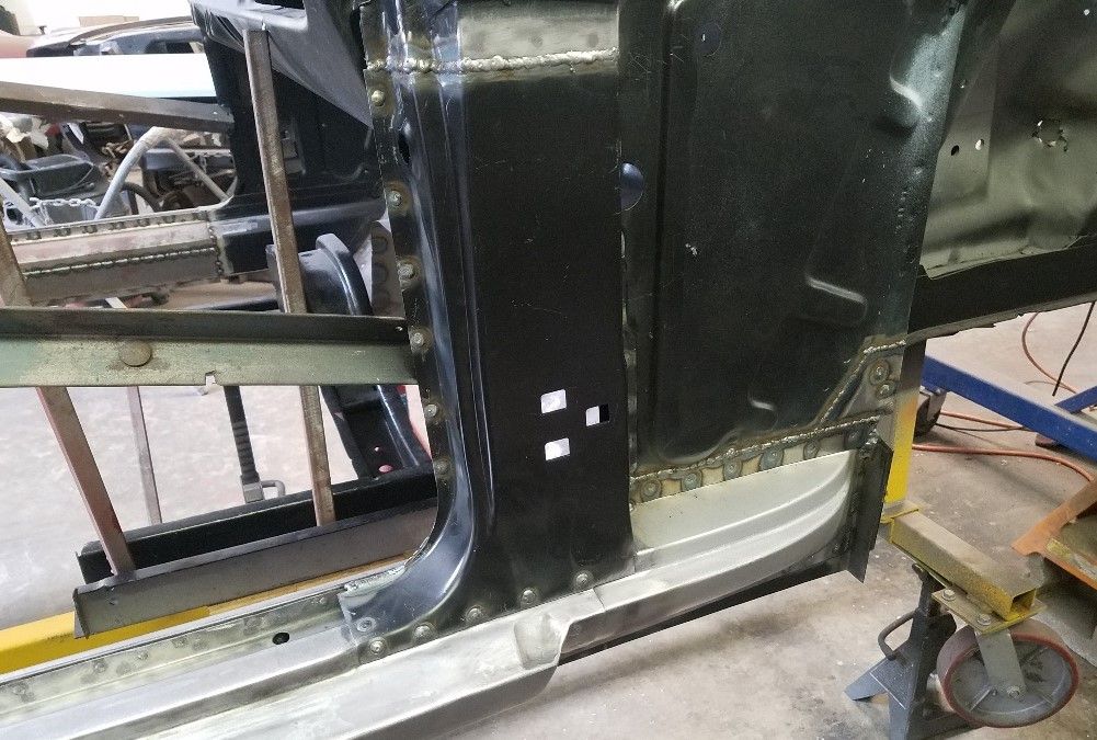

GPR 01-20-2020 11:43 AM

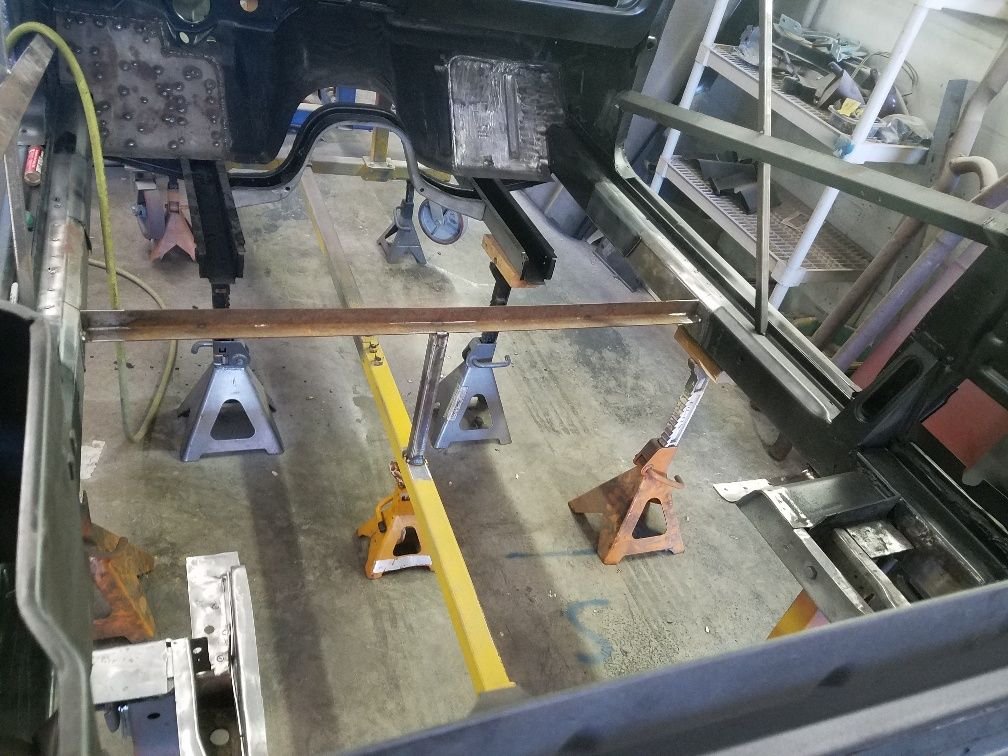

We decided to replace the floor since there was a lot of small holes in it.
https://img.photobucket.com/albums/v...psmdcw1vz0.jpg

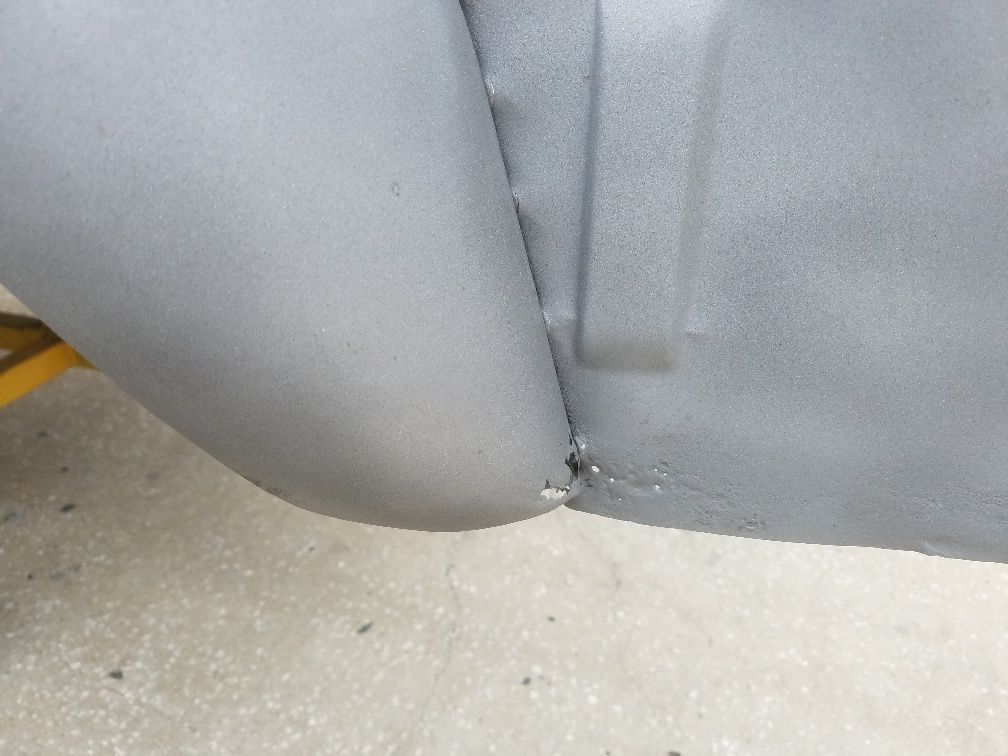

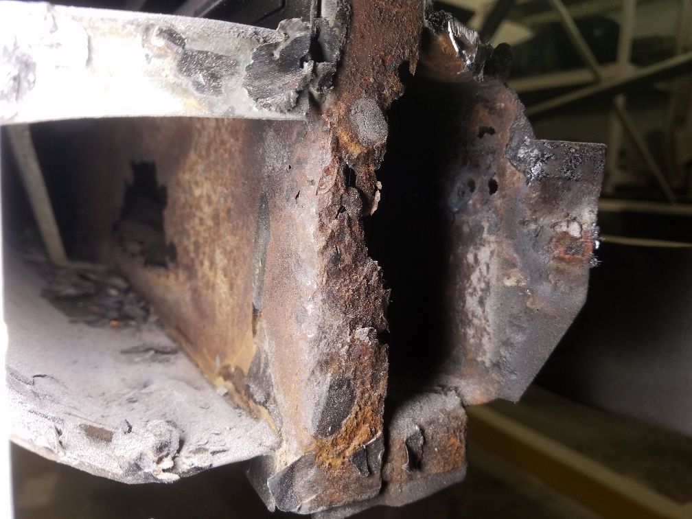

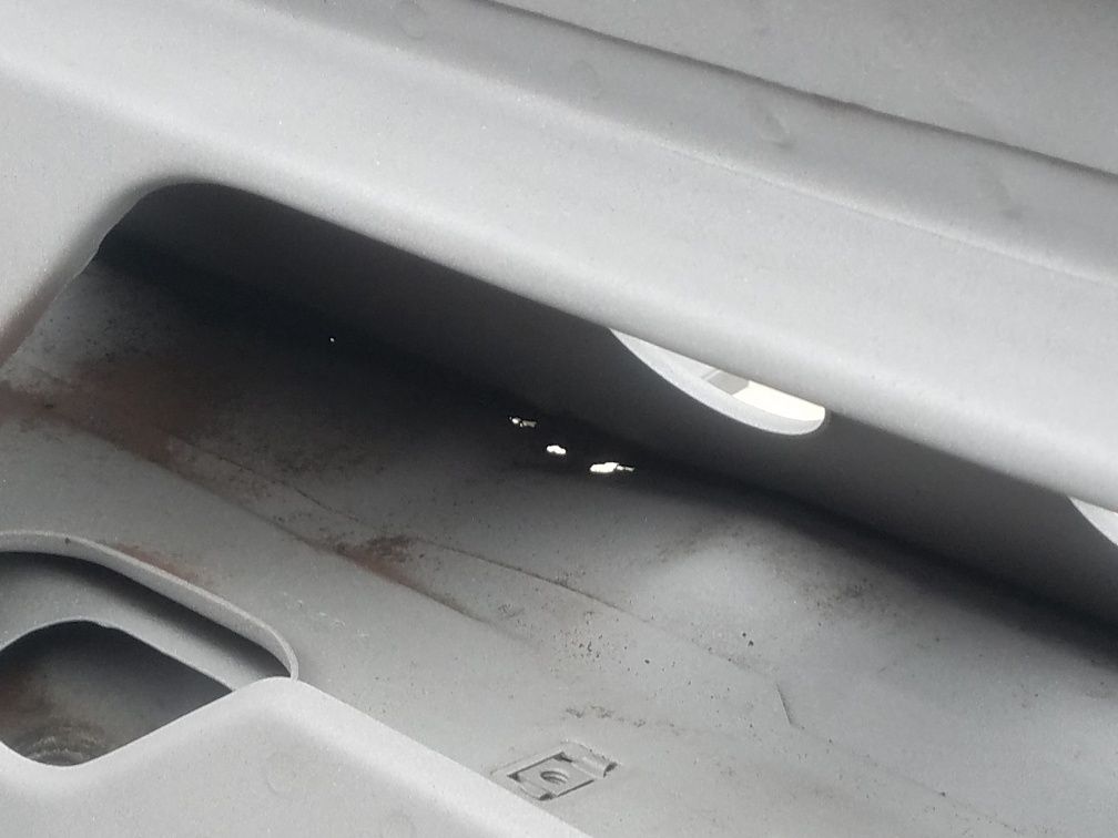

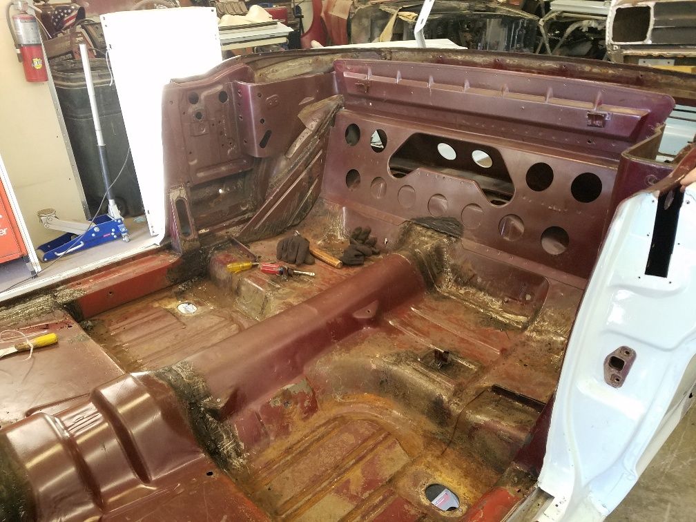

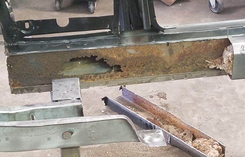

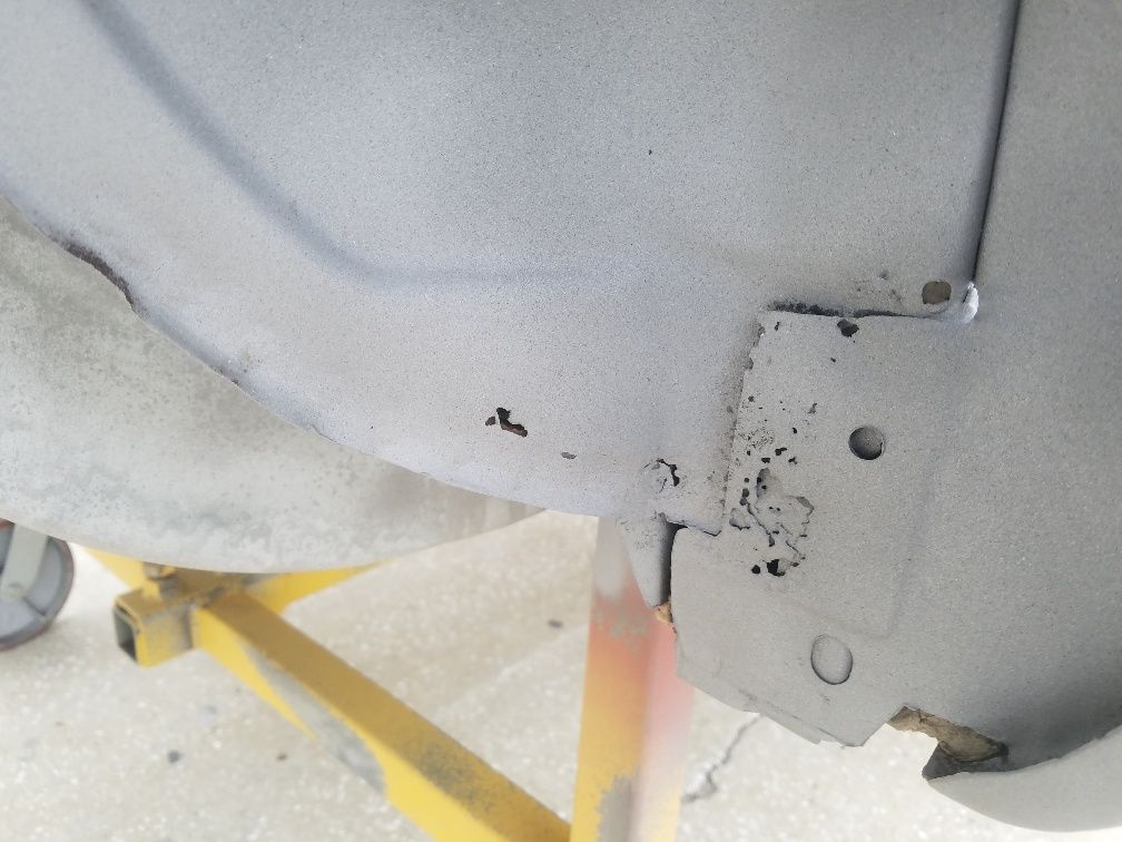

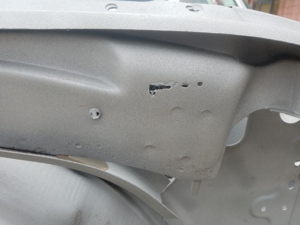

Found a few small holes in the inner rocker panel
https://img.photobucket.com/albums/v...pssaz5dqbd.jpg

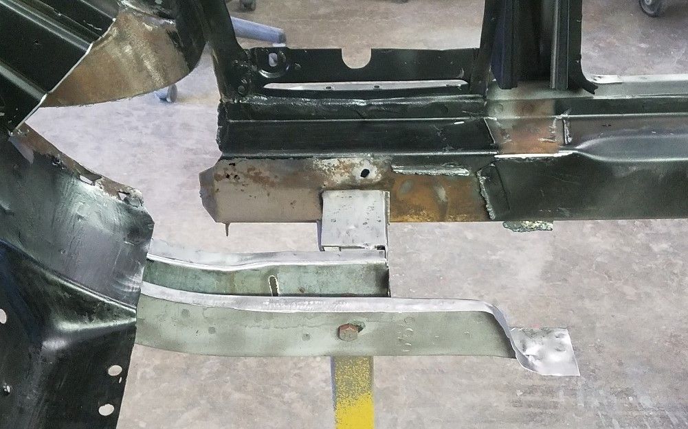

This is what we found in the inner rocker panel.
https://img.photobucket.com/albums/v...pssipybwkx.jpg
https://img.photobucket.com/albums/v...psjedf4cos.jpg

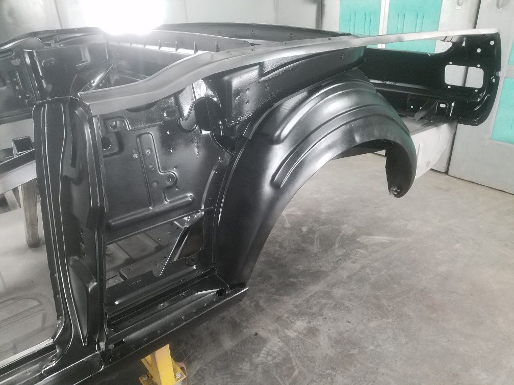

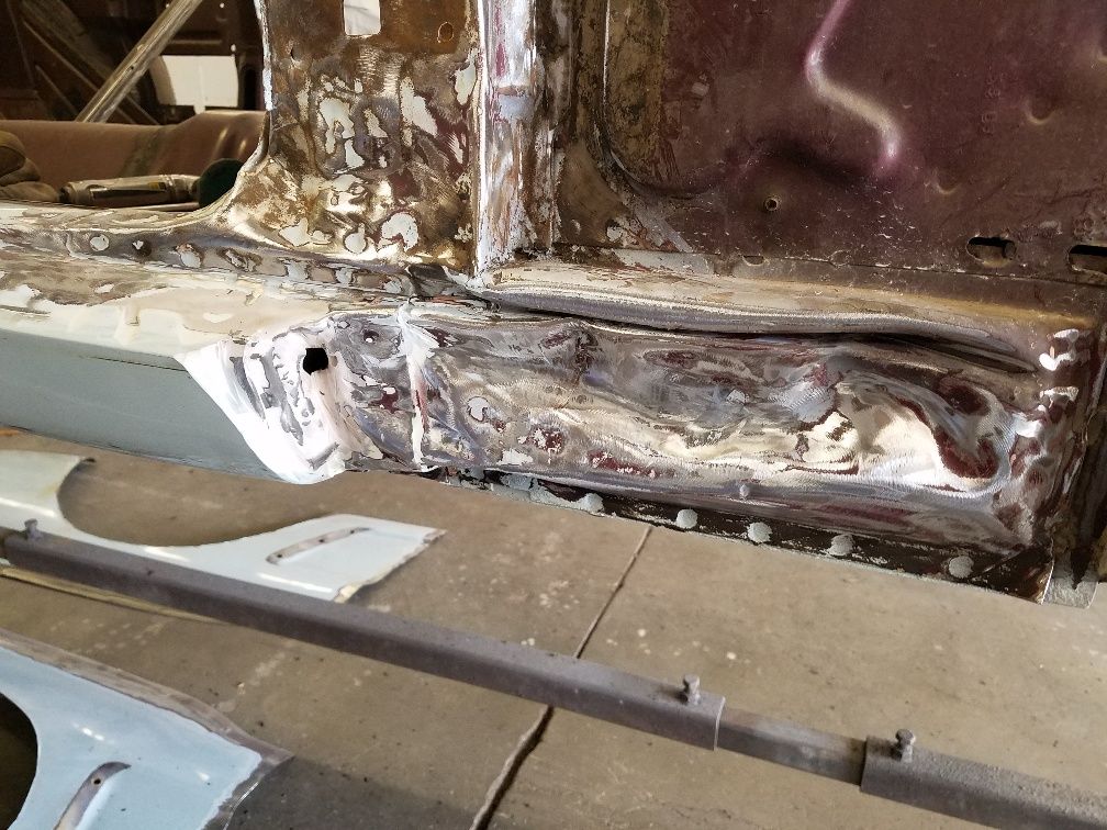

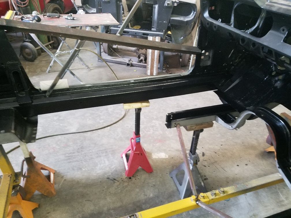

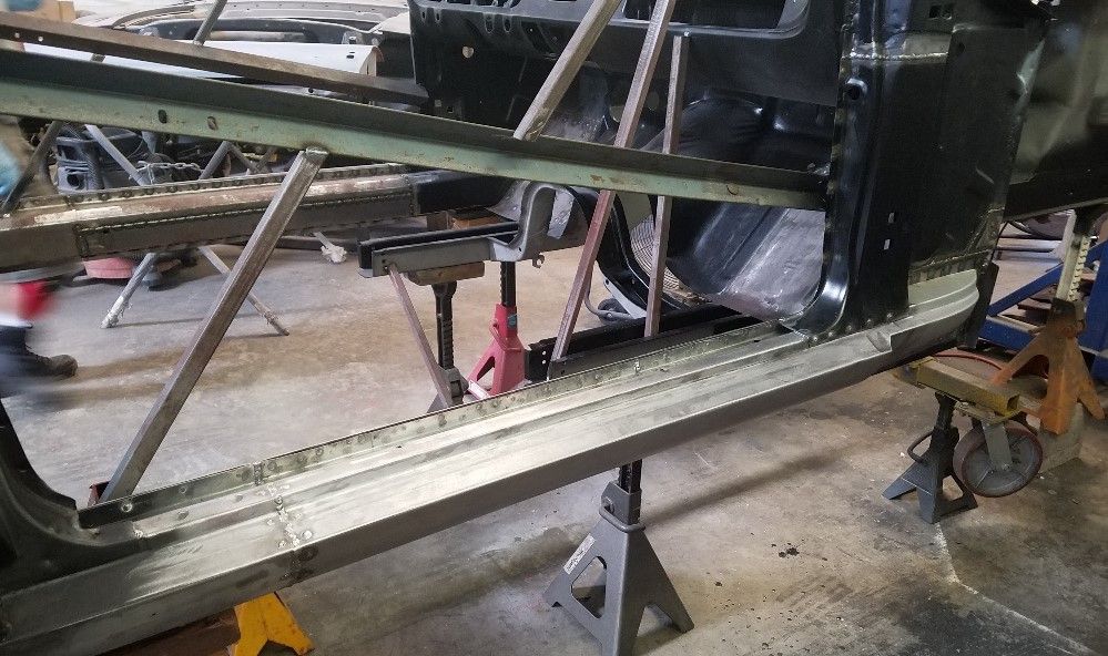

Both left and right inner rocker panels along with the right outer rocker panel were replaced.
https://img.photobucket.com/albums/v...pstwpashts.jpg
Also replaced the lower right A pillar
https://img.photobucket.com/albums/v...psy3y4qe3c.jpg
https://img.photobucket.com/albums/v...pslzcznbos.jpg

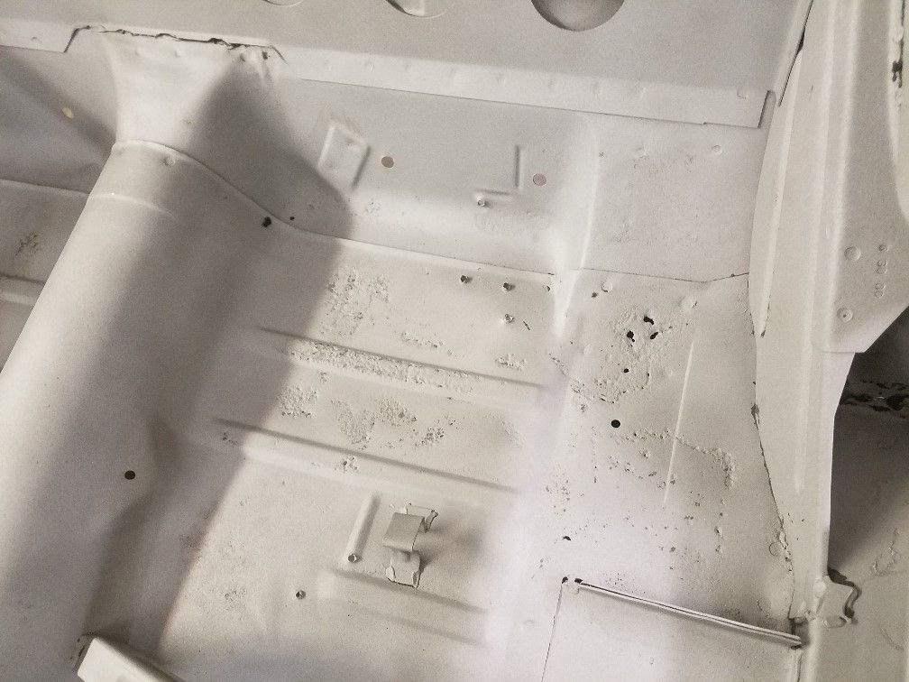

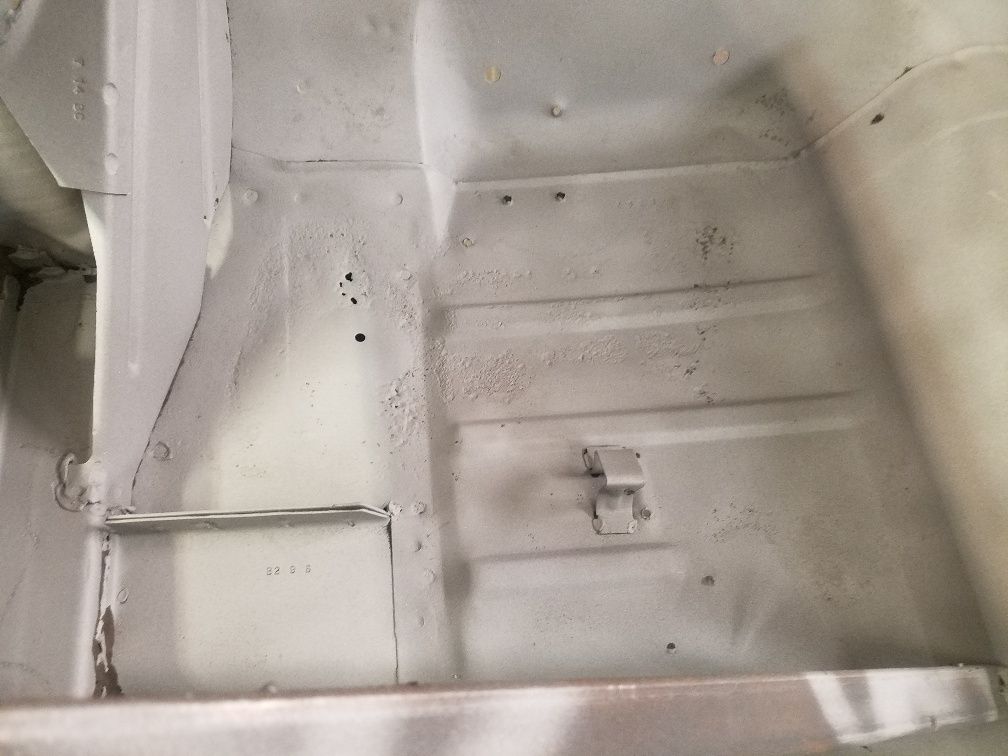

New floor pan sanded and epoxy primed before installing
https://img.photobucket.com/albums/v...psnrecutva.jpg
