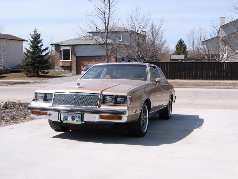

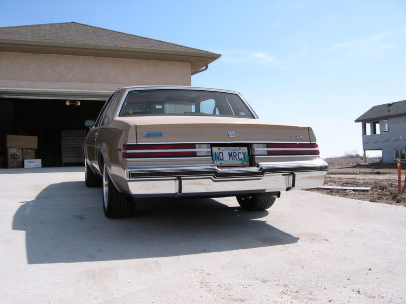

It's been a number of years since I posted. My 85 Buick Regal has been sitting for almost as many.
I finally have the time to get this car back out and on the road where it belongs!
https://www.lateral-g.net/forums/cac...Picture110.jpg
https://www.lateral-g.net/forums/cac...Picture109.jpg
The first thing I want to do is convert it from the 950fm mechanical carb. I want a self tuning system, i have no interest programming my tune.
I am gonna leave it at that general request for now.
I really look forward to hearing from your Guys!
Cheers,
Jason
