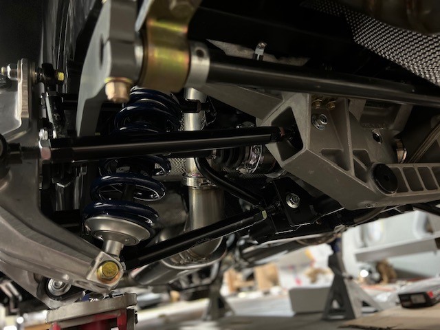

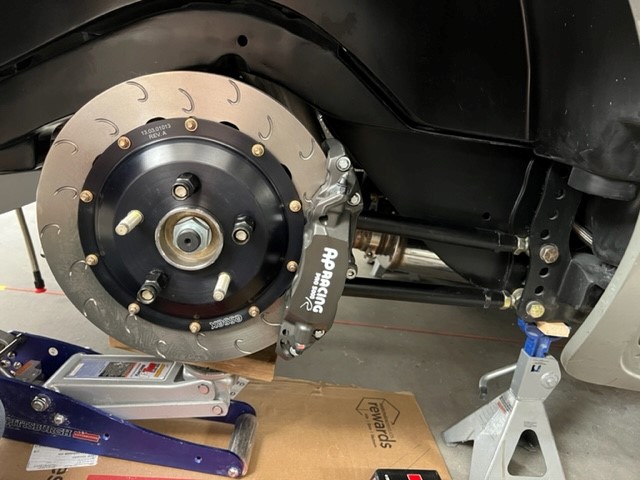

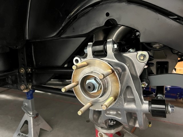

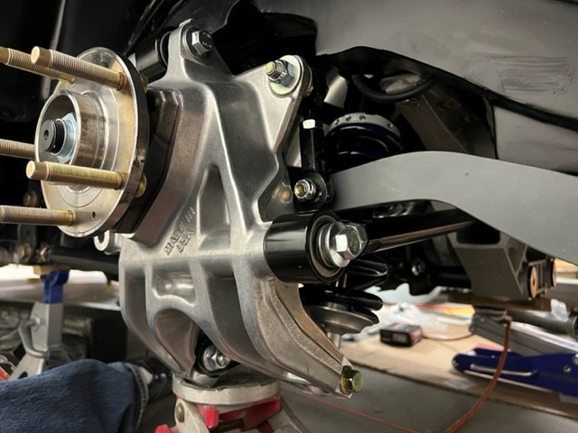

For those who might be interested in a strong, adjustable, multi-link rear suspension, here is my conversion of the DSE Decalink (designed for a C-2/C-3 Corvette) to a C-1 Corvette chassis. I believe it could be adapted to most chassis with a little fabrication of the crossmember and forward link pick-up points. The Decalink uses JRI multi-adjustable shocks, C6 brakes, and a proprietary differential with Chevy 12-bolt internals.
