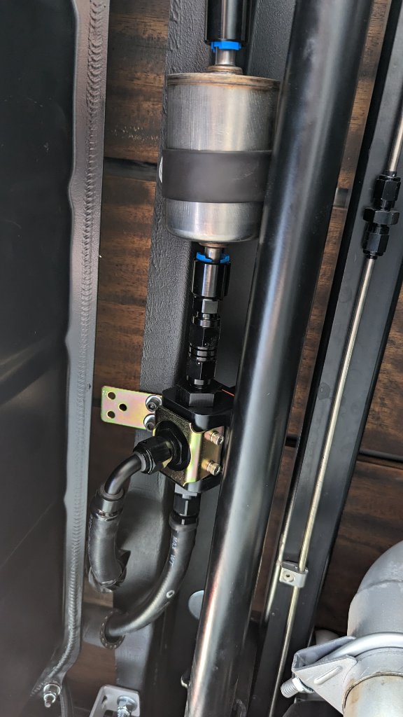

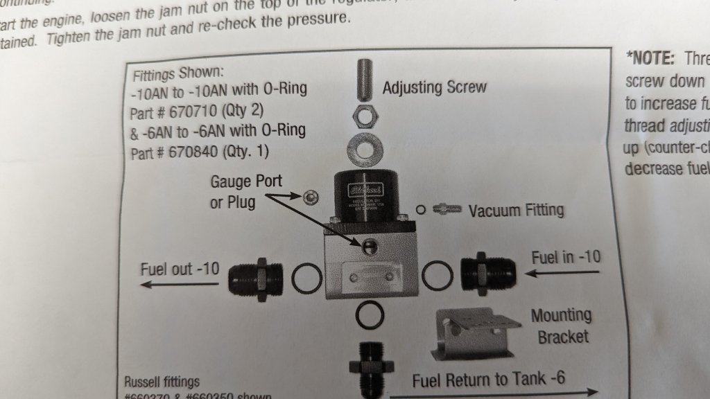

I'm sure this is way late and you are already up and running but I just swapped my Holley Sniper to a carb. 351W in a 39' truck. Used the same EFI pump, changed the regulator and filter. All good.
Attachment 80219
Attachment 80220
