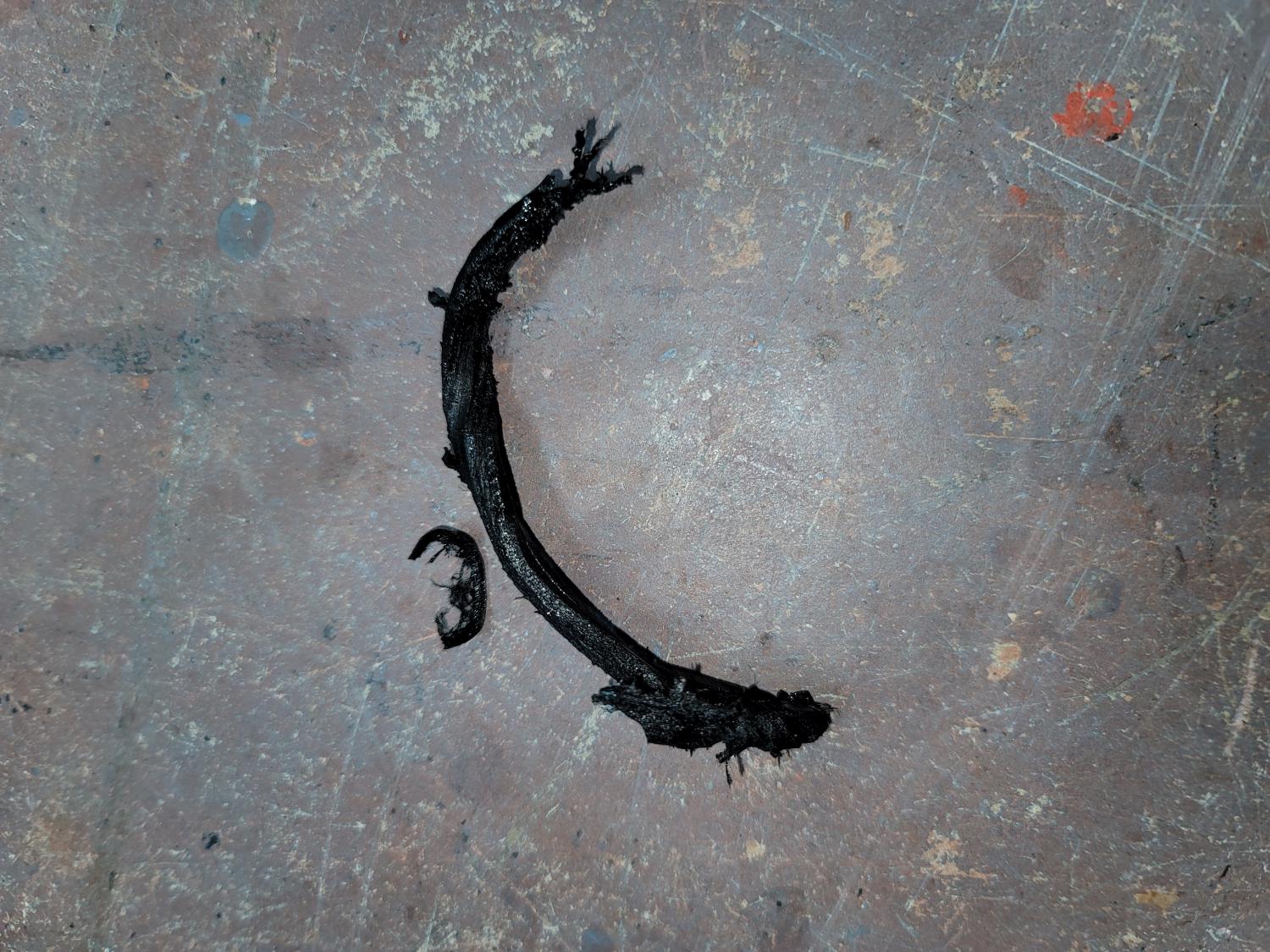

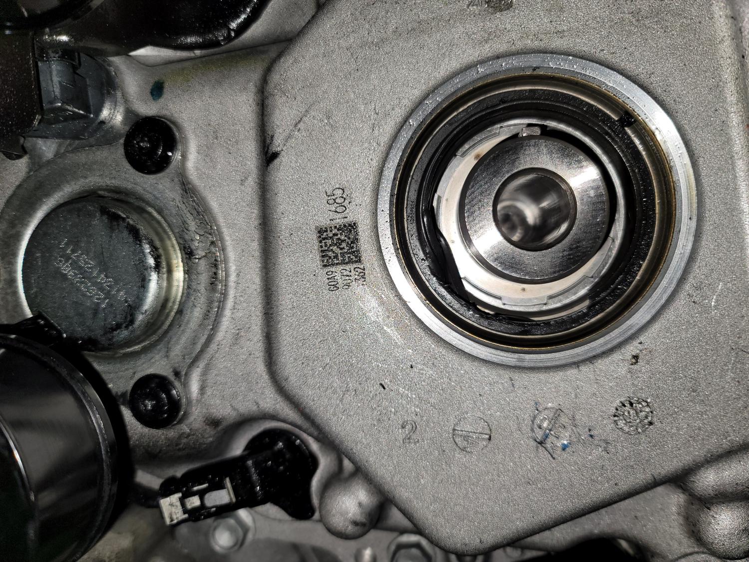

vet57air 09-03-2023 02:03 PM
2 Attachment(s)
Attachment 80538
Attachment 80539
So to take the crank hub off I heated the bolt for 1 minute then hit with impact. Bolt came right out. Used a puller to take off hub. Pictured is the big piece of belting that got behind the hub and damaged the seal.
camcojb 09-03-2023 05:31 PM
That was my fear, but hoped the odds were on your side. Like I tell myself, "gave me something to do" lol.
