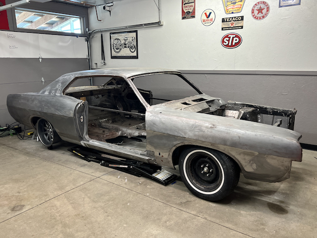

jarhead 11-06-2023 02:44 PM
1 Attachment(s)
Thanks Jody
Ya "rule" was a weird way to put it :knokwood:
Ended up ordering Nitto NT555 G2
255/45-18
295/40-18
My tape measure, calculator, and back got a workout on the concrete over the last three days :headspin:
Attachment 80777
