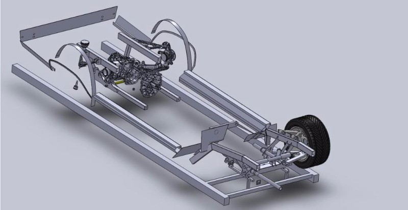

I used Solidworks to design the suspension and frame for my Nova project. It helped a ton!
https://www.lateral-g.net/forums/cac...ive%2Fcad4.jpg

Thanks for the reply and the info on the C5 spindles. I was thinking the same thing about the R&P placement.
Are you super familiar with Solidworks? I only ask because a lot of people point to Fusion 360 as a good tool for a hobbyist. So long as I can use Solidworks as a new guy I'd probably use that as my friend has it too.
- Alex
I've been using solidworks for at least 20 years now... but I taught it to myself using you tube and how-to guides. I find it pretty straight forward.
QUA-HOON! 04-03-2024 02:41 PM
I'll give it a shot then! I'll try to figure out how to build a frame in it this weekend to start this building process.
