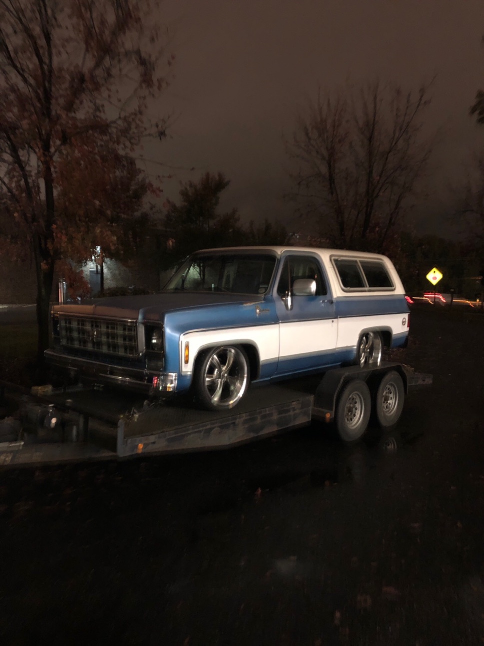

Starting a new project. The goal is a very reliable vehicle for Goodguys Hall of Fame Tour.
I found a nice 2wd Blazer with good patina and little to no rust. It looked like some one found it and threw a hillbilly slam job on it and some wheels.
My plan is to raise it a bit and install a 2018 Tahoe L83 (5.3L) and 6 speed in it. I found one on EBay with 3 miles on it from a train derailment.
I purchased the following off that totaled truck: engine, trans, ecm, wiring harness, radiator, fans, induction, fuel pump and controller, under hood fuse block, wiring harnesses, exhaust and evaporation system.
It should run like a 2018 Tahoe.
Attachment 81872https://uploads.tapatalk-cdn.com/201...5876851e8f.jpghttps://uploads.tapatalk-cdn.com/201...03d277f13f.jpg

Ketzer 03-28-2019 06:11 AM
Awesome! What kind of chassis are you thinking?
(also, thats not a Camaro...thats a funny looking Camaro...is that a Camaro station wagon...) :lmao:
Jeff-
Stielow 03-28-2019 06:22 AM
Mostly stock chassis with some Ridetech stuff on it. I’m attempting to keep it simple.
The truck drives good.
