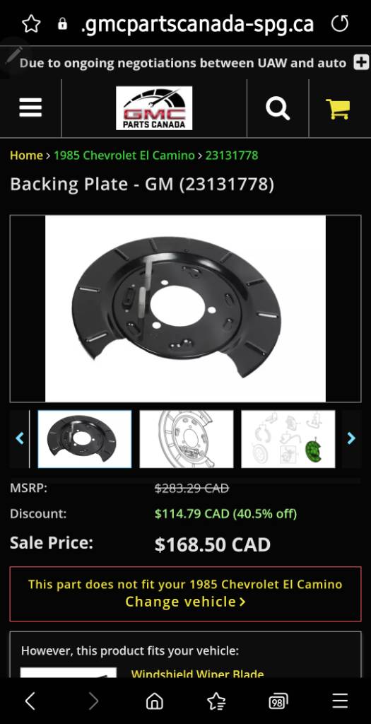

I have the camaro backing plates and want to put them on my 70 elcamino.
They will need to be drilled to fit the A body bolting pattern.

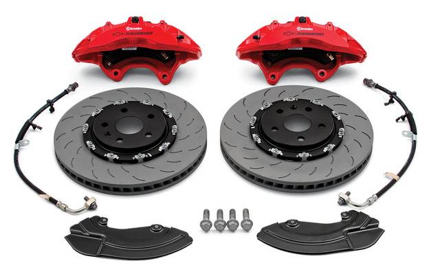

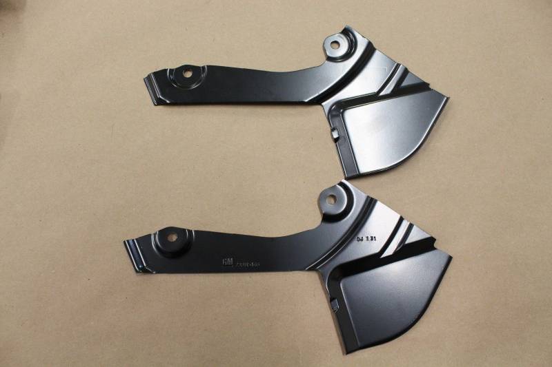

There is also cut down dust plates for 1LE which is only the bottom half of the plate.
Anyone else do e this?Attachment 82118Attachment 82119Attachment 82121Attachment 82122

The new cars (1LE, ZL1) only have dust shields to protect the ball joint boots from the rotors heat.
SO, my plan is to get a set of factory 68-72 A body dust shields and cut the mounting points out (with extra metal on upper mount to block heat on upper boot), and look cut my own 5=6 shields down to 1LE shields, weld both together so they work on an A body with gen 6 brakes..
