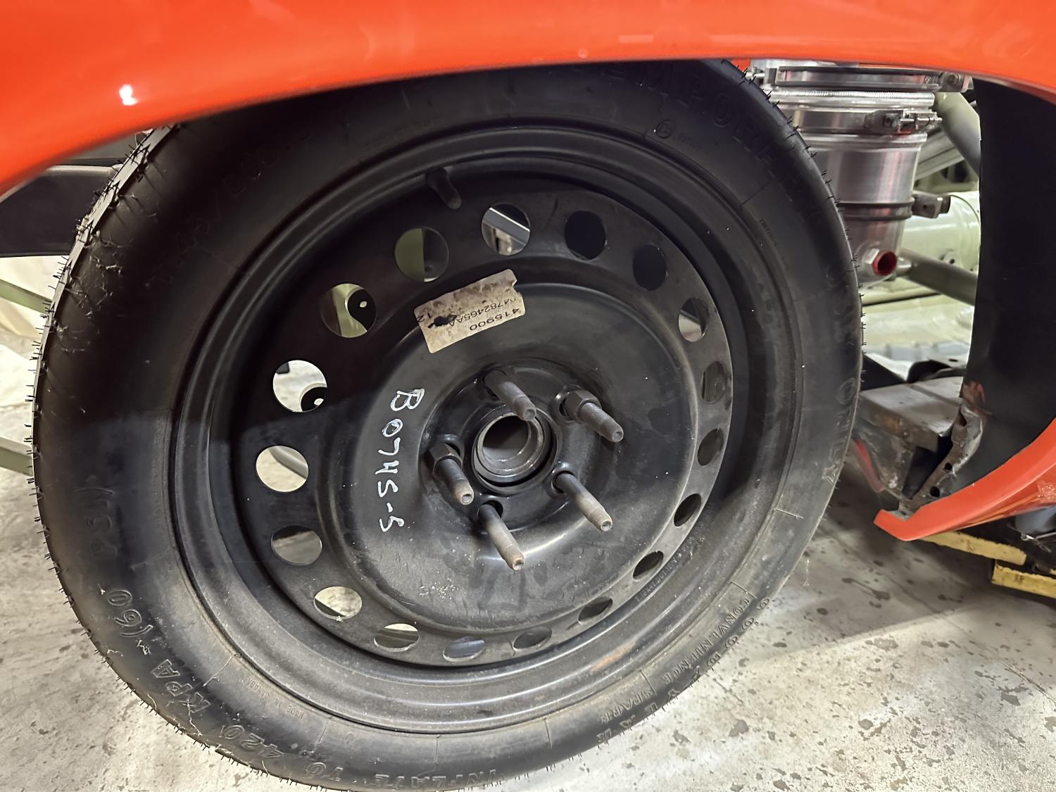

1 Attachment(s)
Yeah, I use them as rollers on pretty much everything. Anything 2005 and up are all pretty much the same and cost about $5-10 at the pull-it yards. I have slotted the lug openings (die grinder and about 2 minutes a wheel, and can fit them on anything from 4.75-5.5. Slotting the lug openings ruins it as a spare or driver, but they are just rollers.
