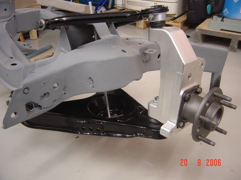

Heres a pic of my set up. ( i have no means to hijack your threat)

whoa joni, I love those spindles...are those c4 hubs? Did you design and machine those yourself?

Thank you for your nice words. I really apreciate it from you. I cant take the credit from machine and desing work. My friend helped me and we desing em together. They have same geometry than later C4s do . Yes the hubs are from C4 too. For starters i am going to use GS brakes. But as you see from pictures the brake bracket can be easily bolted off and re made for bigger brakes in futute. Ps i got mine on wheels too this evening. And even "drove" it an inch !!! I dont have my steering arms done yet.
