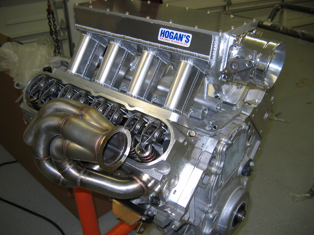

Just realize that's setup to fit an 05 GTO chassis, so you'll be modding a lot of it to get it to fit your car. Not sure the manifolds will work either; they use the stock GTO exhaust manifolds turned around, but they may have clearance issues on the Chevelle.
Nelson Racing makes a set of headers that will fit the LSX and your 70 Chevelle; you could run twin turbos or a large single with them.
http://www.camcojb.com/malitude%20078.jpg
Stuart Adams 11-18-2006 01:33 PM
Wow, what a motor. Hogan makes some beautiful stuff.
camcojb 11-18-2006 01:41 PM
Thanks Stuart, I agree.

while i certainly agree that the nelson headers are absolutely beautifull, and the hogan intake a work of art, the GTO kit somhow struck me as being relatively easily adaptable.. but i stand corrected

well, it may fit, but I had the APS twin turbo kit in my 05 GTO and those cars have completely different frame rails, suspension, etc. so I doubt it would fit. But it might.
