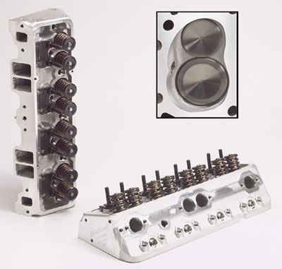

The Carburetor and Cylinder Heads I am planing to buy.
http://static.summitracing.com/globa...dl-60909_w.jpg
http://static.summitracing.com/globa...edl-1805_w.jpg

Looks like a fun project. If this is your first engine you are going to learn a lot. Do you have emissions to worry about over there in Sweden? If not you might want to run a performer rpm intake instead of the performer. The air gap performer rpm is the best one. What size is your engine? 350, 305, ? What heads are those. your going to like aluminum heads. Not many out there that wouldn't give you a performance jump from stock iron. While you have it apart make sure you pay atention to the little things to like a oil pump shaft that has a steel sleve instead of the stock plastic, and a high volume oil pump. Also I would recomend using ARP fasteners for your heads, crank, and rods. What octane rating is the fuel over there? Good luck and keep us posted.

The heads are Edelbrock Performer built with 2.020" intake valve and 1.600" Exhaust valve and 64cc Chamber.

Okay thanks for the tips! I might sell the intake then and buy a performer instead. What carb do you recomend?
