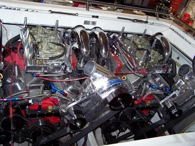

On a fitting the NPT side I always use a sealant on the flare or hose end side none just a lubricant to resist galling and do not over tighten
http://i144.photobucket.com/albums/r...Picture071.jpg

Silver anti-sieze is my fav as well on the 37*flare side but still a fitting has usually a npt thread such as 1/4 3/8/1/2 npt that you are threading into something fuel pump intake what have you on the npt side the threads ARE the seal and I always use something on that side. Ill post a pic later as not to confuse, now an fittings that have a seat on the other side such as brakes hydroboost some fuel logs and regulators I only use anti-sieze on them
