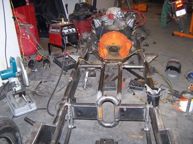

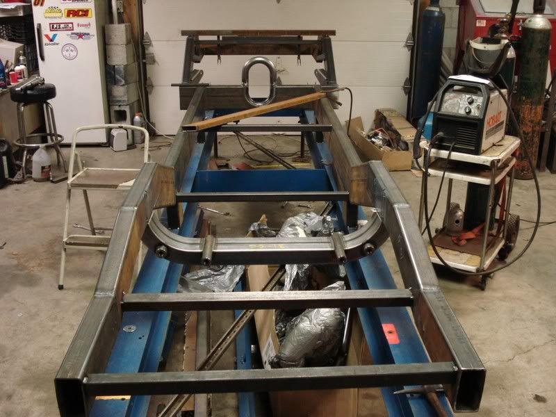

Yesterday was a good day, we finally got the 68 Chevy pick-up project off the ground. After months of talking and design work we finally made some sparks. The complete new rectangular tube chassis is started. I attached pics. I have a friend of mine doing the welding, he is awesome. Not only is he doing the welding, we are building the chassis in his shop until we get ours cleaned up. We have a complete new Morrison front IFS and Morrison Triangulated 4 Bar for the rear ready to weld in. I have to say Craig, Matt and Don at Morrison are great guys to deal with. I am also working with Tim at Paradise Road for alot of the components for the truck. Great guy as well. The other exciting part is that we are going to be working with Ben Hermance on some renderings for the truck. Things are starting to come together. I hope this thread is long and updated often. We will see.

deuce_454 01-09-2007 01:56 AM
wow, looks awesome, like the fact that you have started out with some sufficiently stiff square tubing... to many people build flimsy round tube frames just because of looks..
are you sure the kick-up is high enough or is that the front end?? if you want to negotiate corners, you want your C of G as close to your roll center as possible, that means lowering the craf out of a tall legged pickup like yours.. 6 inches of ground clearance should be more tnat enough to go anywhere, will the body and bed eb channeled over the frame also??
big congrats on starting the project by the way, and the welds look awesome btw
That is the front kick-up. The ride height will be 6.25 at the front cab mount and 7.125 at the rear. I live in south western Pennsylvania, the roads are terrible! The rocker panels end up just about to the bottom of the frame rails, so the cab will not be channeled. The rear kick up is much more aggressive, so we will be moving the bed floor up about 3.5". Thanks for the encouragement.

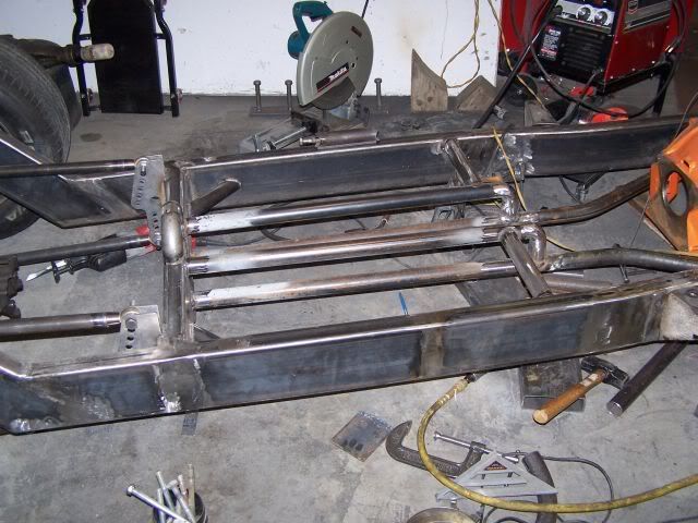

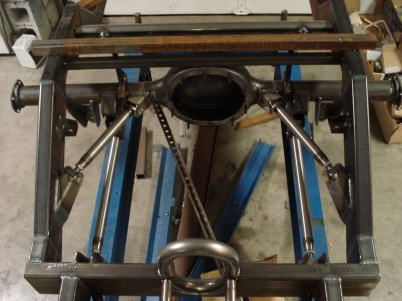

Well, we now have a complete frame. The 4 bar is tacked in with the rearend housing and the cross member is tacked in. I am really pleased with the outcome so far. Hopefully by the end of the weekend we will be as far as we can until more parts show up. What do you guys think so far? :P
