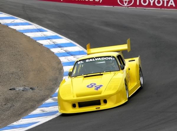

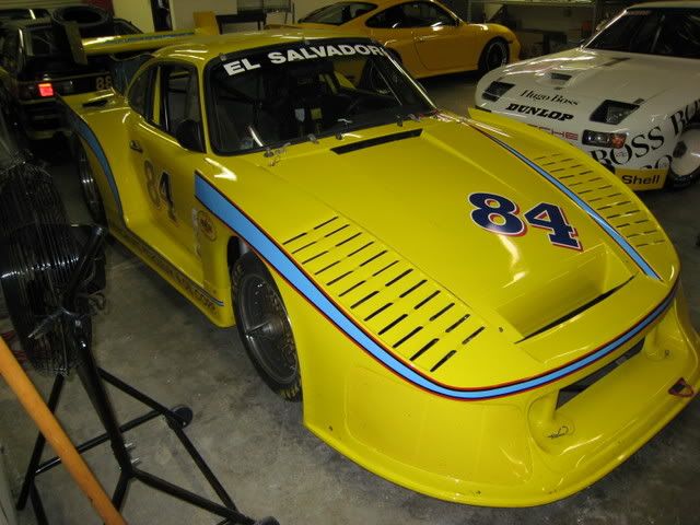

ChevyThunder 03-11-2007 09:58 AM
Frank.. that's on old bucket that one... factory Porsche race car. This is the car I will be racing at the Rennsport Reunion in November at Daytona ..

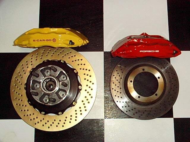

ChevyThunder 03-11-2007 10:02 AM
Here is a good comparison photo.. on the right that is a 12 inch rotor with a Brembo " big Red" caliper... and a 15 inch rotor with the Brembo endurance caliper...
