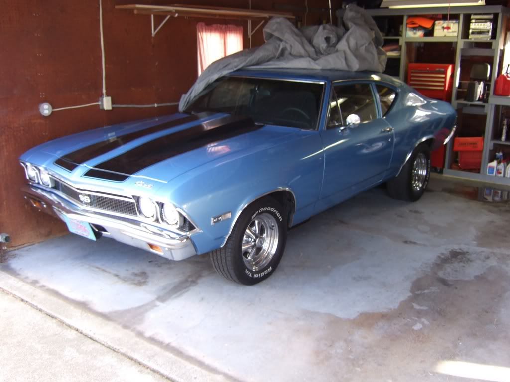

jjl4004 03-19-2007 05:32 AM
I pulled the cover up and took this picture last Thursday. I haven't got it out yet this year..still salt on the roads.
