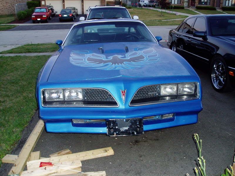

Here is how it looked when I first brought it home.
http://i168.photobucket.com/albums/u...owTA/front.jpg
http://i168.photobucket.com/albums/u...gerinside2.jpg

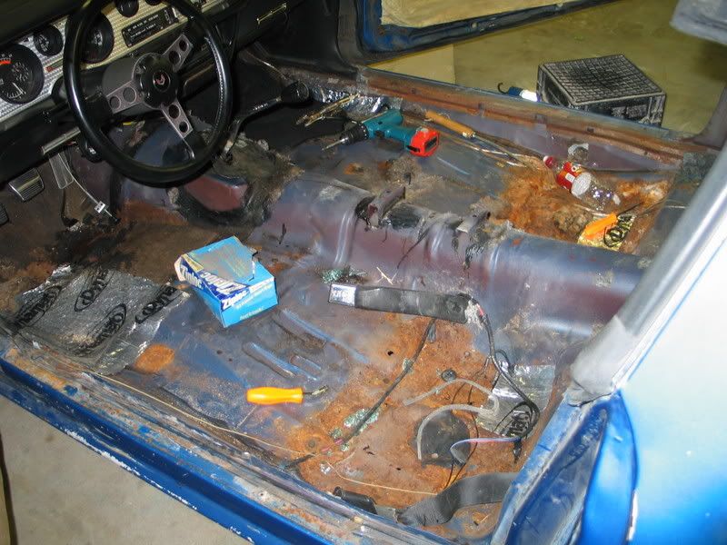

Once tear down began, it became apparent that I would need to source a parts car to rebuild the TA since so many of the panels were in need of replacement. I found my parts car in a 1980 Indy Pace Car Edition Turbo TA, which was acquired for $1500, complete less the turbo, but disassembled.

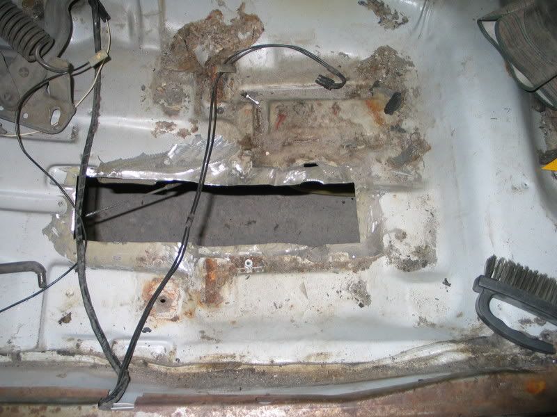

Here is the gutted interior - the floor was so bad, you could, and I did, step right through it. Fortunately for me, the prior owner had thought enough to cover these holes with dynamat.
http://i168.photobucket.com/albums/u...ration1010.jpg

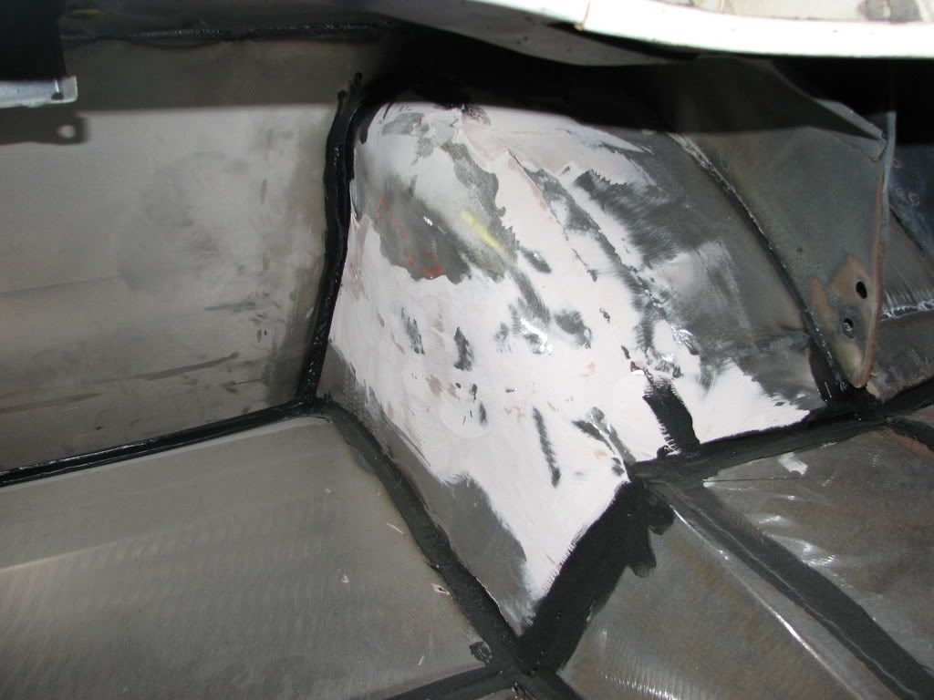

Goal one was to eradicate the rust – we started by patching the corners of the dash. Somehow I cant find the pictures of this right now. As things progressed, the donor car gave up most all of its body panels at least in part – including the rear quarters, inner front fenders, rear filler panel above the deck lid, deck lid itself. The bottoms of the doors were rusted out, and it was easier to swap them over as well.
I also got a lot of surface rust ground off and got the car into primer the easy way, yup with a brush and roller.

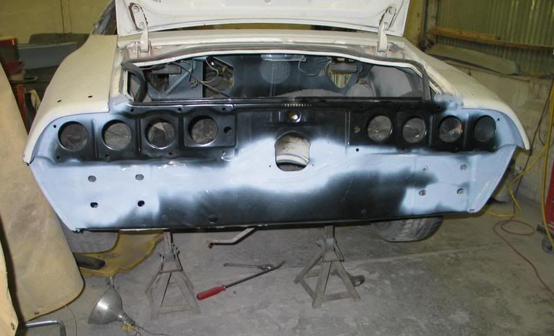

The tail panel was pretty shot on the 78 TA too, but since the 80 model had a different tail panel, this panel was purchased as a reproduction piece from Goodmark.
If anyone says the replacement panel is a direct fit, they obviously never met my car. The panel was about 3/16 too narrow L to R and the gas filler hole was in the wrong location. I had to made this modification to get it to fit.
http://i168.photobucket.com/albums/u...A/IMG_2944.jpg
Overall thought, its a pretty good fit and since I am not going for an "original" restoration, it will suit my needs just fine.
http://i168.photobucket.com/albums/u...MG_2967mod.jpg
Other that that, all of the exterior metal is original GM, just from various different cars – the interior will have some fabricated parts, including the floorpans and the divider between the passenger compartment and the trunk.
