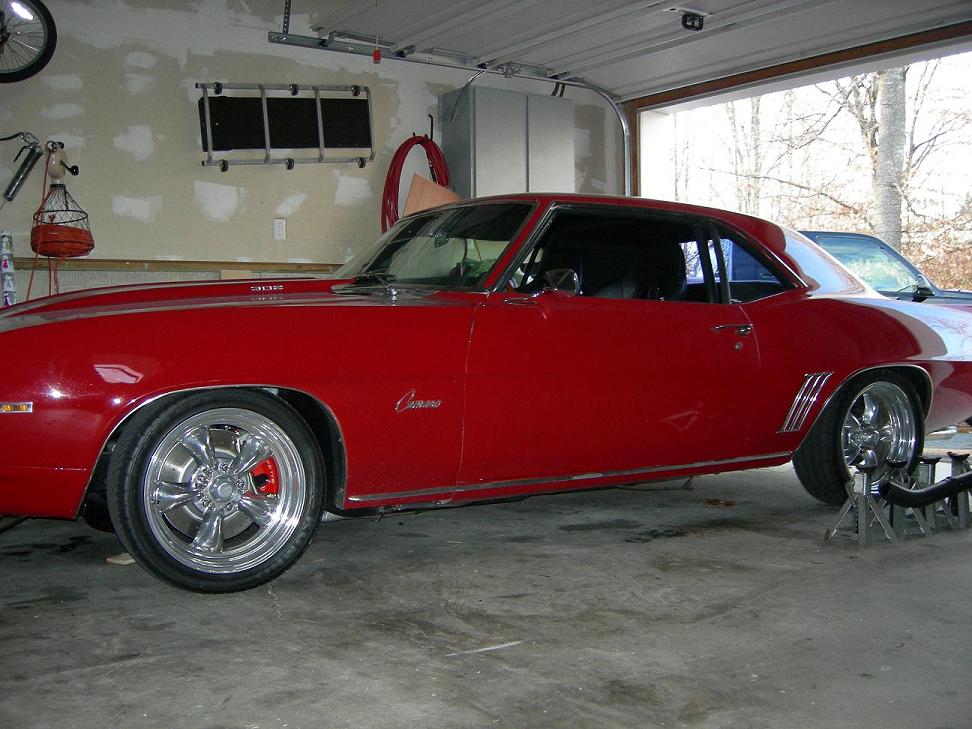

Serpa69 05-08-2007 11:59 AM
1 Attachment(s)
I cut 2 coils off of mine and this is hhow it sits
Attachment 7514
