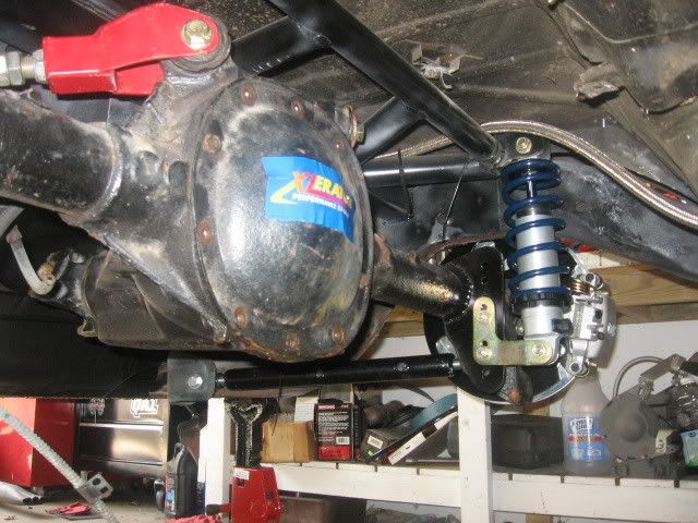

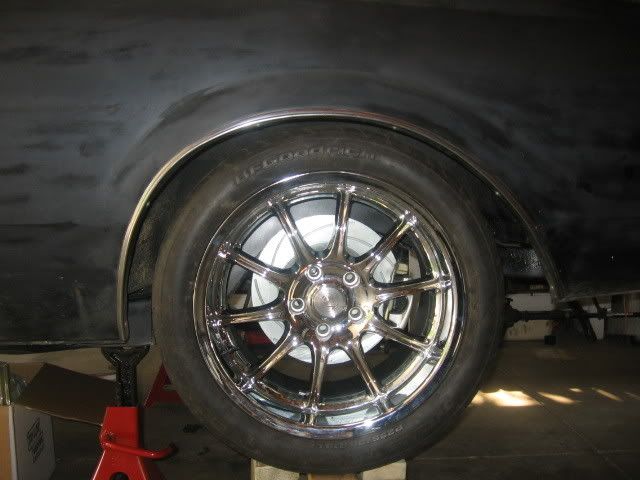

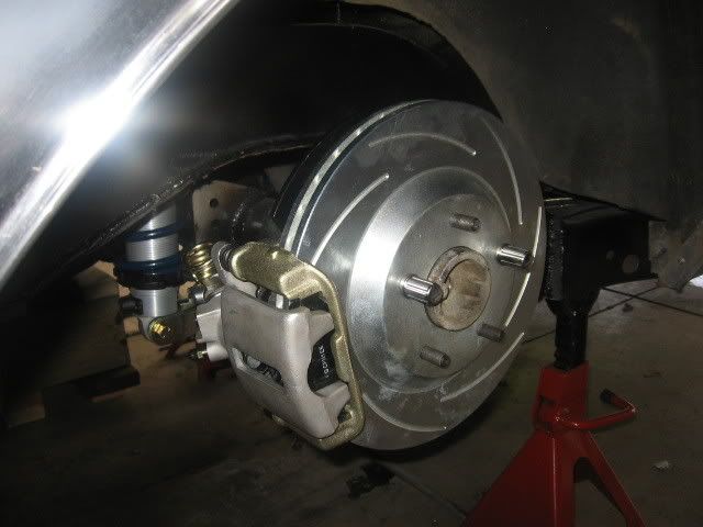

Hey guys. Things have been moving rather slow. I keep running out of money so it is hard to make any real progress. I did get the rear end in though. It took a little time but it fits well and the coil overs look great too. Next I am going to put the front clip back on, thats free. Then I want to get the front brakes complete and hopefully set the car on the ground for the first time on 18's.

GBodyGMachine 05-25-2007 03:14 AM
I received an I M yesterday asking what the setup was.
I am running double adjustable upper control arms from Ebay as well as double adjustable lower control arms from Ebay. I cut out the orig spring pockets off the frame and put in my own crossmember and bracing. I made the coilover brackets for the axle out of 1/4" steel and welded them on. The Coilovers are from Strange with 200lb Hypercoil Springs. I really like them. The brakes are from SSBC and are ment for a 12 bolt from an A-body, but I made them fit.
Any other ?'s please ask.
Jeff
GBodyGMachine 05-25-2007 03:42 PM
Duece.
The rear brakes are from SSBC. The were a freebie from a friend with an a-body. I just had to modify them a little bit to make them fit correctly. Front brales are at a stand still until I purchase the Calipers and Brackets.
