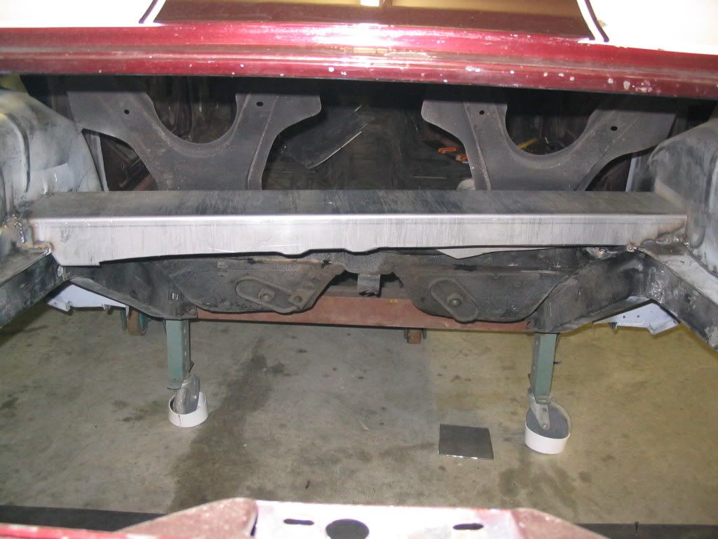

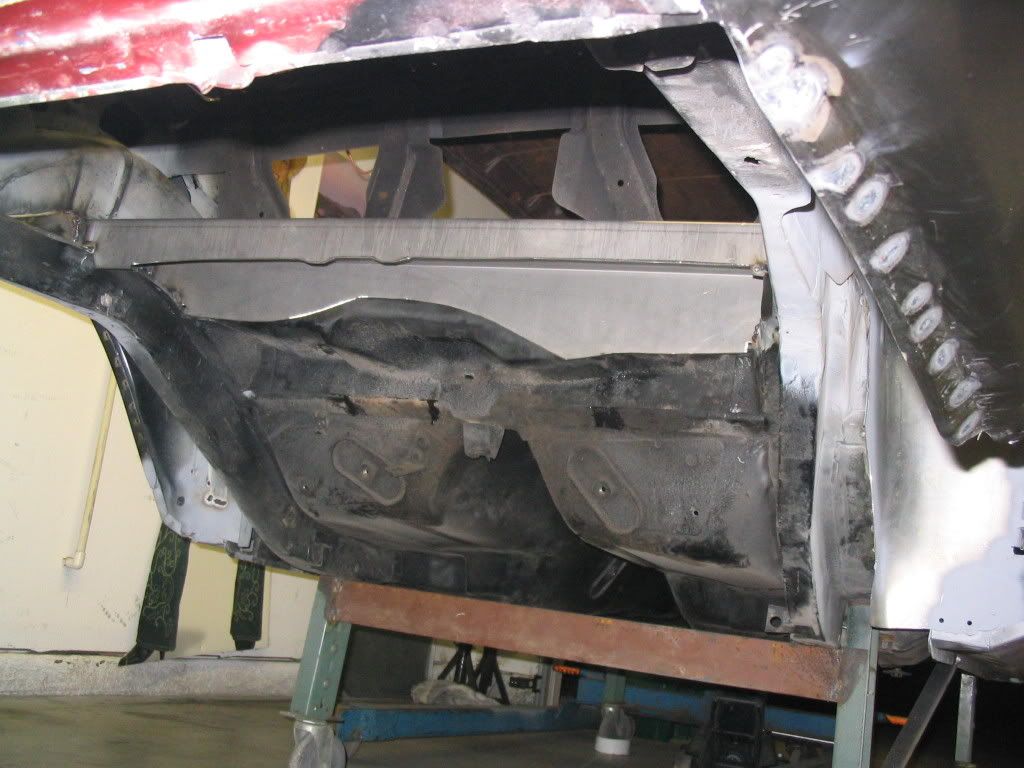

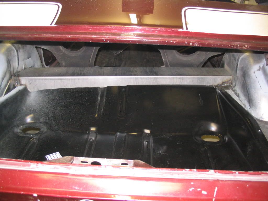

Need help....I can't figure out how much to trim on the sides near the frame? I trimmed all of the top sheetmetal, but on the inner area there is a plate on each side that is part of the frame. I guess my question is do I trim it up to the frame rail? Any pics or help would be great.:willy: :willy: :willy:
the camtender 05-26-2007 07:17 PM
http://i187.photobucket.com/albums/x...r/IMG_1617.jpg
http://i187.photobucket.com/albums/x...r/IMG_1616.jpg
http://i187.photobucket.com/albums/x...r/IMG_1614.jpg
Hope this helps,
Jerry

zcrz 05-27-2007 07:23 AM
thanks!!
:thumbsup: I think those will help.
