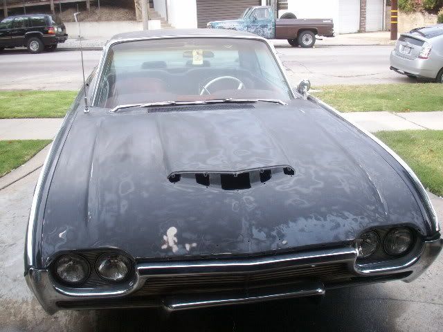

Got all the clearcoat off and smoothed and feathered any raised or low areas as best I could!
http://i56.photobucket.com/albums/g1.../SandFront.jpg

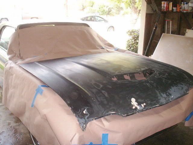

Masked, Taped and Tacked! Ready for paint! I didn't prime it since the original thread said primer was not necessary!
http://i56.photobucket.com/albums/g1...dPassenger.jpg

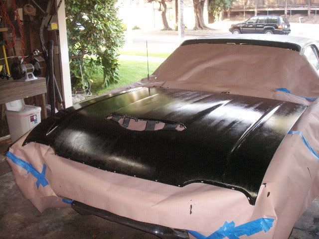

1st Coat
http://i56.photobucket.com/albums/g1...CoatDriver.jpg

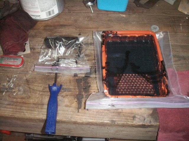

Many people have commented on what they felt was the ideal Paint to Mineral Spirits ratio. As I was mixing it seems that a 70% Paint/30% Mineral Spirits is a good mix. I guess we'll see but I'm glad I went a little heavier on the paint since the hood of my car has many contours and if I would have mixed it any thinner it would have run all over the place. I guess the best way to describe the mix I did was to make it a little thicker than milk. I was also worried about whatever excess paint I had would dry up along with having to constantly be cleaning the roller so I just used ziploc bags to keep them moist!
http://i56.photobucket.com/albums/g1...ntPreserve.jpg
