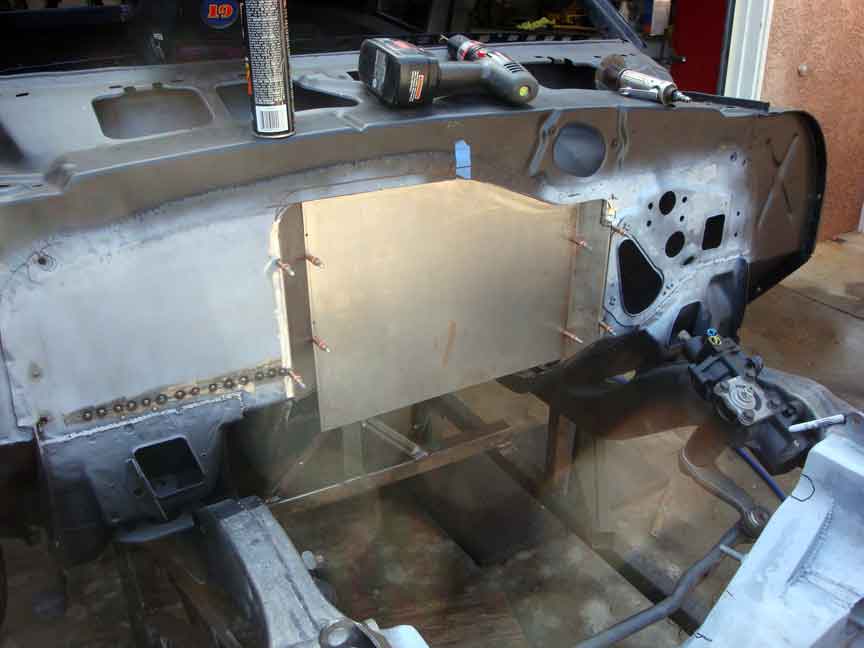

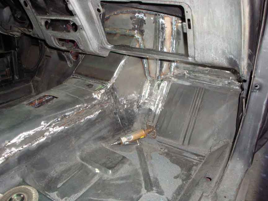

I spent my available time this past week building the recessed firewall. I decided against making it removable, and I made it intentionally asymmetrical to provide more room for the clutch hoses/ linkage.
I went through 2 sets of cardboard mock ups and ultimately warped the heck out of it by welding it too quickly. I need to be more patient. Lesson learned, I hope. I made a slice to help alleviate some of the warpage, but it'll need more finessing to make it presentable.
I still need to build a cap in the front, as there is a slight overhang of the firewall sheet metal on the top passenger side. I'll box that in.
