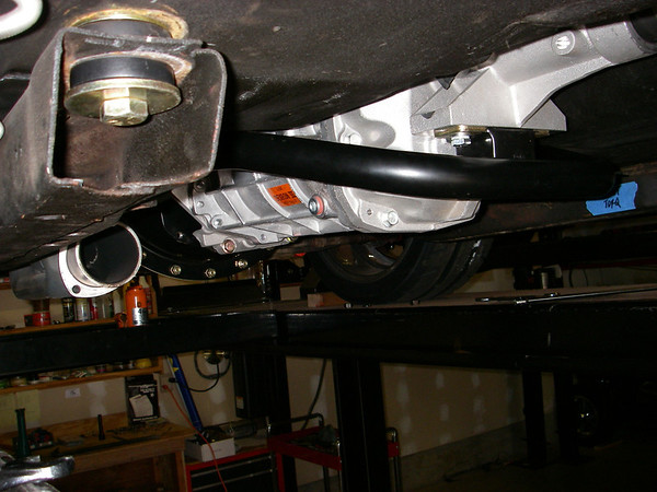

One thing I learned about the T56 1st Gen F body install is many people say they will fit without cutting the tunnel. After multiple trial fits and measurements there must be quite a difference in the floor pans from factory to factory. With a drivetrain angle of 2.25-2.5* downward and new full height sub-frame mounts mine was a full 1/2" high at the shifter cover bolts on the right side. Access to the top bolts on Quicktime scatter shield was also very tight, 3' extention with a wobble end just barely fit.
This is the final clearance after manipulating the tunnel with bottle jacks and wood blocks.
I built this cover to gain clearance and also access to the shifter
