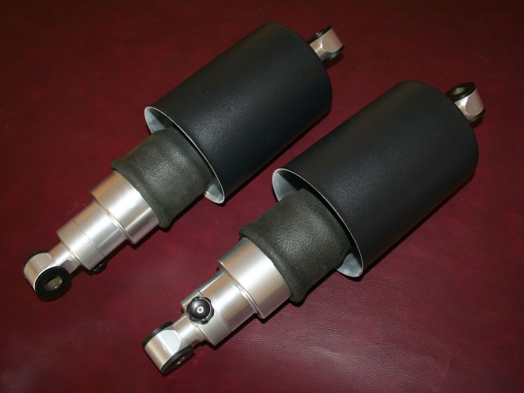

I was a lil pissed. AR sent me the shockwaves with the optional air can (big ugly can over the bag) they sell for a hundred bucks. I didn't want it, looked cheesy IMO.. But. I thought I would give them a chance. If I didn't like the look I could remove them later. No, they didn't charge me for them. Guess they were having alot of problems with guys tearing the bags due to close tolerances. So I really didn't want a massive aluminum can sitting in there. Time for some plasti-coat!!
Ghetto paint booth LOL
