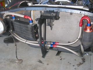

I'm using a System One remote oil filter system, Setrab 14"x6" oil cooler, Mocal oil thermostat, all done in 12 AN lines. The oil filter and cooler are mounted left and right of radiator.
I have some old pics that i will post. With temps reaching as high as 300 I would definitely pick up a larger cooler with fan and thermostat.
Gaetano what type of oil temps are you seeing on 90* day 20 min sessions? Water temps?
Matt
