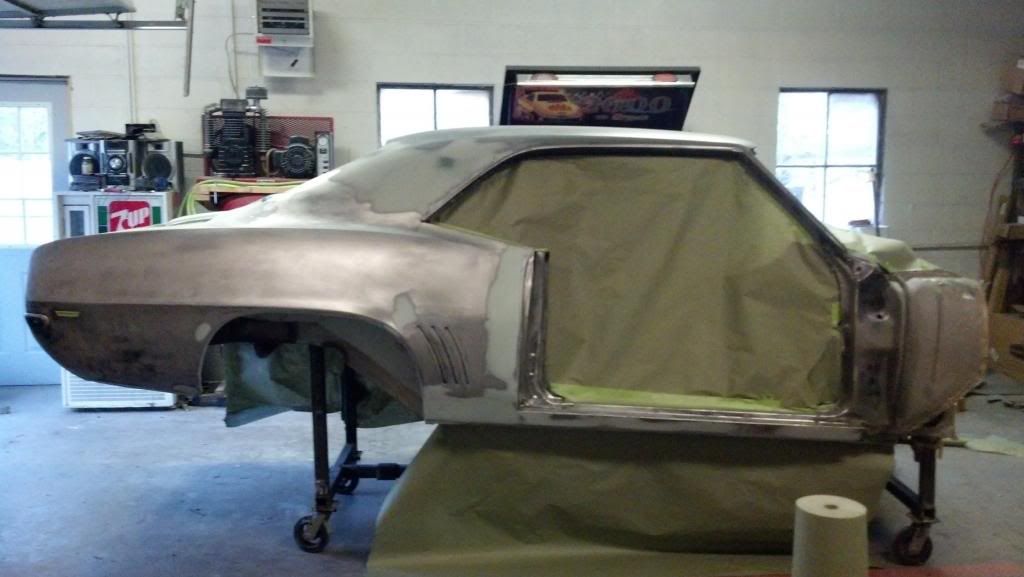

Okay, finally got the pictures all rounded up, So I purchased this car in 2007 from former classmate that had the car sitting in his garage since 96, He bought it and just wasn't a car guy so It sat, He started out about 13g and after recruiting my wife for back up and about 3 hours later we loaded it up for a 6500.00 When we got it it had the old wide on the back and narrow up front centerlines, 80's, I swapped out the wheels for the rallys in the picture. We then drove it around a few times over the summer months. It wasn't bad, Just wasnt what it could be. So in the summer of 08 we tore the car down to the bare body. I had it media blasted and ordered qtrs and mini tubs. I saw Scott Gulbranson's car on the front of camaro performers and was hooked, I had to build a car like that or close(ls t56 335s) So I installed mini tubs and rear quarters. The qtrs fit horrible around the trunk, I cut the edges and moved the edge of qtrs in so they would fit.
Then we decided to put a art morrison frame under the car. So all the work of narrowing the factory frame I took and cut it all out. . I received the frame in the spring of 2010 and finally got it installed in fall 2010. I used a digital tram gauge that I sold to one of my friends to measure the wheelbaseet.com/albums/r638/snappytravis/69%20camaro/3409e3bf.jpg[/IMG]
will post more pics later
Just a couple of pics before I prime, Hopefully I will get epoxy put on today then urethane in a few days, then I can start blocking next week, Can't believe how thrilled I am just to get it primered.
finally pictures
