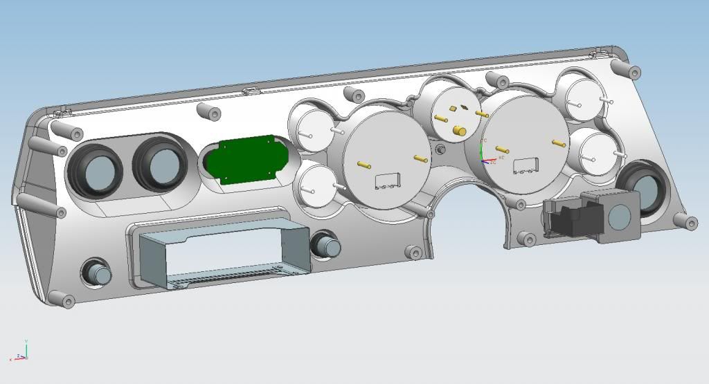

Originally Posted by ironworks View Post
Here are some more updated pics of the very close final product.
Looks awesome! You may want to look into a permanent mold casting for this. this thing is going to have a crazy amount of machine time in it not to mention the chip/finish part ratio. Depending on the demand you may be better off spending the money on the tooling. Just a thought. It will be crazy nice no matter the direction you go!
