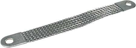

Hi I bought some 7/8" tinned copper braided wire to us as ground straps, I'm looking for the flat terminals for the ends. I would like to use these rather then the regular barrel type.
flat tin plat copper braided Ground Strap WIRE 7/8" dia MIL SPEC .
Looking for terminals like this or are they not necessary. Looking for the best grounds I can produce.
Its a manufacturing process to get that type of lug. Its pressed on and drilled. I haven't seen them for sale. But you can buy copper 00 cable lugs and your local welding supply house and insert the strap and smash them flat.
