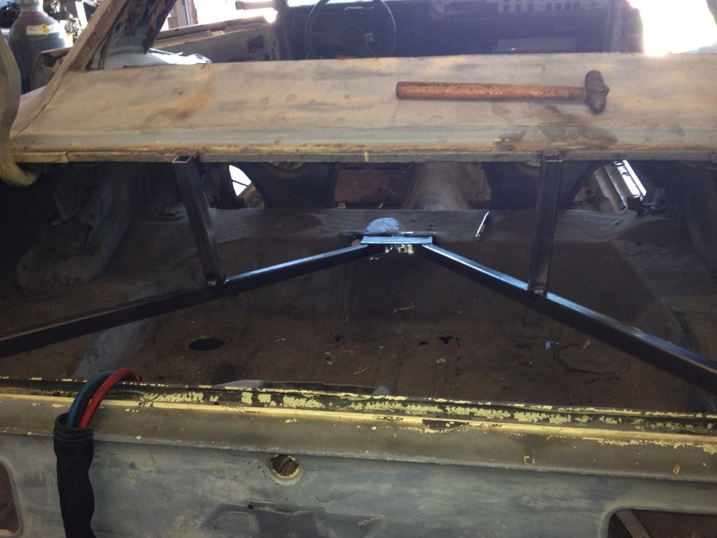

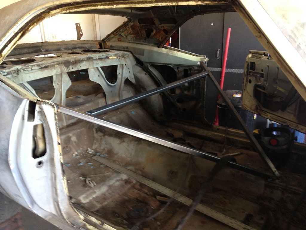

The tear Down: I brace up the trunk and interior with some .120 wall square tube, I will be attaching it to a rotisserie and I don't want to risk any flexing
Building my own rotisserie
