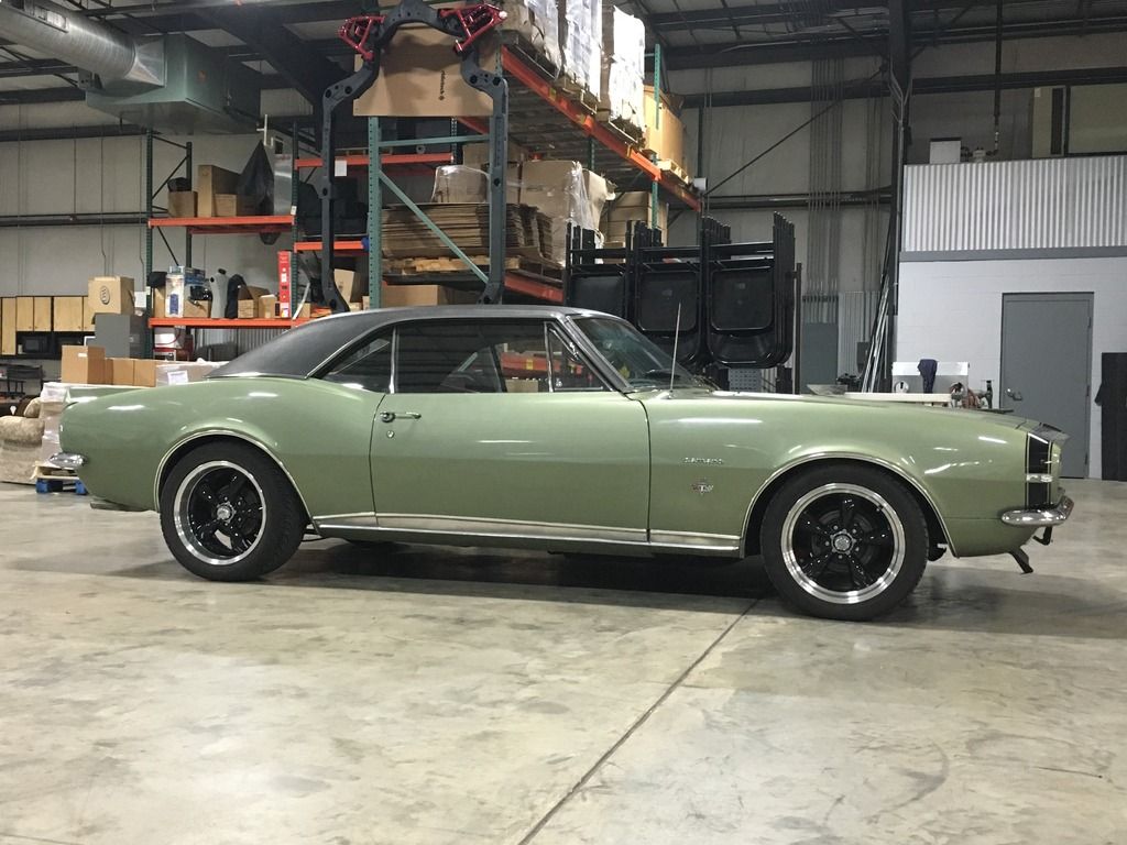

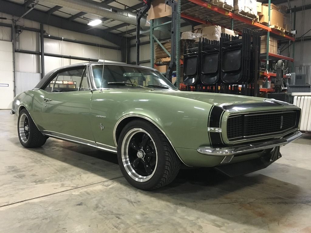

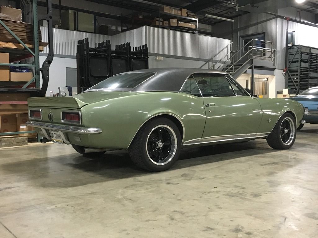

Over the last few weeks, we've been playing with the StreetGrip some more on a few different cars! While working on this Camaro, we've added an extra 1" drop to the 67-68 rear kits due to the rounded fender lips. With the 69's squared wheel arch, getting the lower look wasn't as difficult.
Here are some pictures of the RS we've been playing with. I'll post up some pictures of underside in a little bit to show what we've added!
Specs:
Front:
Tire size: 235/45-17
Ground to fender lip distance: 25 1/4"
Center cap of wheel to fender lip distance: 13 1/4"
Rear:
Tire size: 275/40-17
Ground to fender lip distance: 26 1/2"
Center cap of wheel to fender lip distance: 14 1/4"
