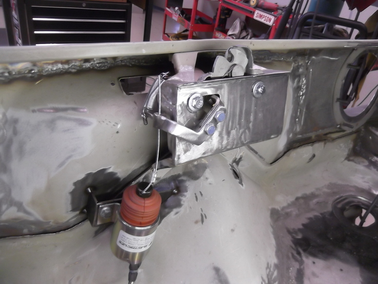

Fab'd up the automatic trunk release set up. Used an actuator from Electric Life. Works pretty nice. Has a button for inside the cab and a 12 channel remote, though probably only use the door locks. Made a custom arm and welded it to the trunk release tab on the factory trunk latch. Had to make a new plate to mount the latch, factory location wouldn't work with the fiberglass trunk lid.

Sounds a little more intense than it really is, just echoing in the metal trunk. That cable clamp is just temporary, will use a cable crimp for final assembly.
